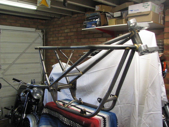

To cheer myself up I have just purchased this:
A replica Seeley Suzuki frame. it will be my next project over the next couple of years.
Cheers Geoff
