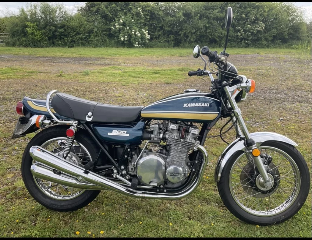

I've always liked them when they first came out & thought it would be quite nice to make it look a little more like my '76 version !!

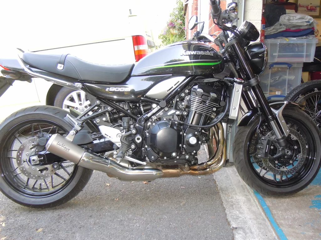

The plan includes fitting a pair of RWU Ohlins, Maxton rear shock, OZ Gass wheels & a repaint in the style of either a Z1A or B, unsure of the exact colours yet though. Obviously the fork swop will be the biggest job, I could go down the easy sleeve route, as in making some sleeves to pack the yokes from the current 53mm diameter down to the 43mm diameter of the RWU Ohlins, but I prefer the route of getting new yokes made that will also retain all the standard barts like the ignition switch, clocks, etc.
I've also not decided what front brake calipers to use either or discs other than they won't be the original parts. The exhaust will also come in for a bit of modification, I've got a short LeoVince titanium can to go on. Hopefully it won't be too loud & I get some headers made up at some point to get rid of the massive exhaust box thing under the engine currently. Whether that will need a remap I've not looked into yet either. Because the weather has been so crap lately I've only had two very little rides on the standard bike so far, less than 100 yards in total I'd guess, but it is one hell of a lot quicker than my '76 version !! :ROFLMAO:

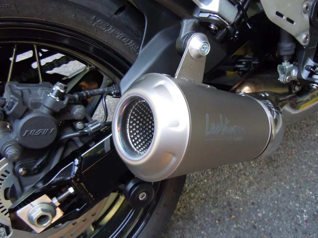

Got rid of the pipe that's been sat on a shelf in my garage for months today. I thought it might have been a bit loud when I was fitting it & comparing it to the original. However, to my 60+ year old hearing it's no different !! Off up the Cat & Fiddle now !! :ROFLMAO:
