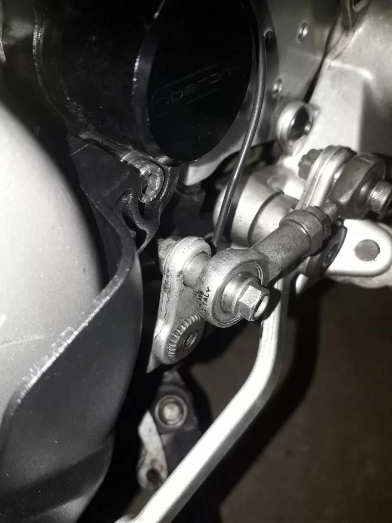

Currently the multi has the standard, flat, shift lever fitted to the 1098 engine's selector shaft....
...and a spacer between the lever and the rod to align the shift rod with the gear lever. But it's exerting too much leverage on the M6 fasteners and they are repeatedly loosening off, despite using loctite and bent beam nuts.
Does anyone know of either a standard selector lever or an aftermarket one that fits on a Ducati splined selector shaft and has a crank in it meaning I can do away with the spacer?
the 996 has a cranked selector arm thingy approx 15mm D when unclamped and 40mm between centres
