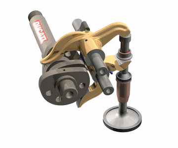

Desmodromic Valve System…
Exige
Didn’t realise Ducati copied it 🤔 I thought it was always attributed to Fabio Taglioni 🤷‍♂️

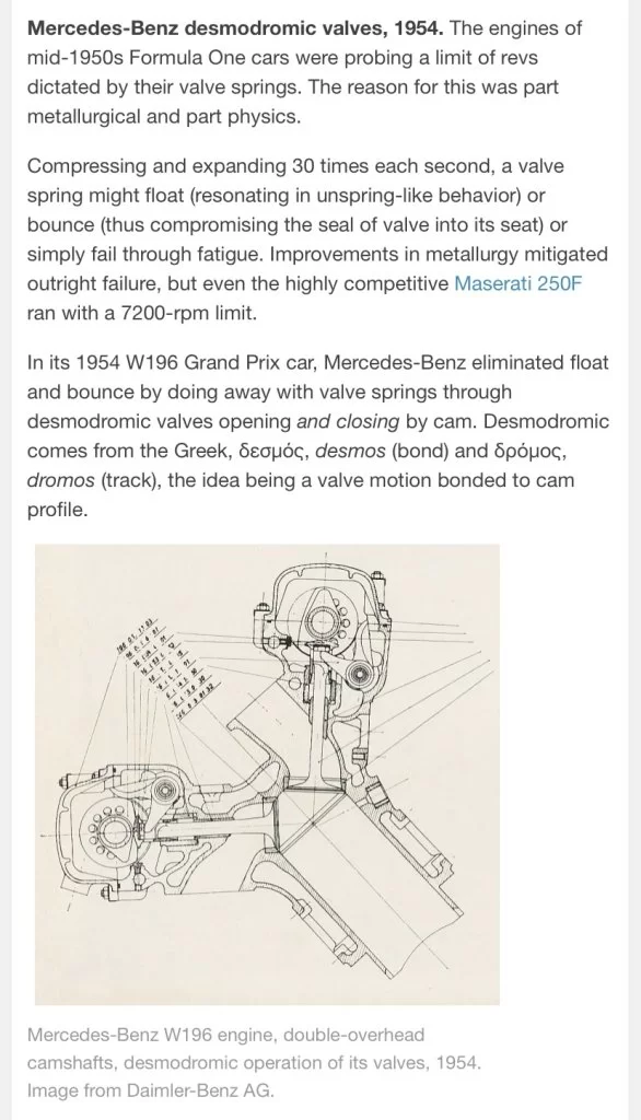

The Mercedes-Benz W196 Formula One racing car of 1954–1955, and the Mercedes-Benz 300SLR sports racing car of 1955 both had desmodromic valve actuation.

Different system to the Ducati mark.
Both Desmodromic Systems - one copied from the other: no different to the Z1 Kawasaki Engine and Suzuki copying the layout and design principle for the GS750 :unsure:
Subtle differences:ROFLMAO:(y).
Ducati never claimed to have invented desmo valves ......
..... but they have always been perfectly happy if people want to believe it ..... ;)
