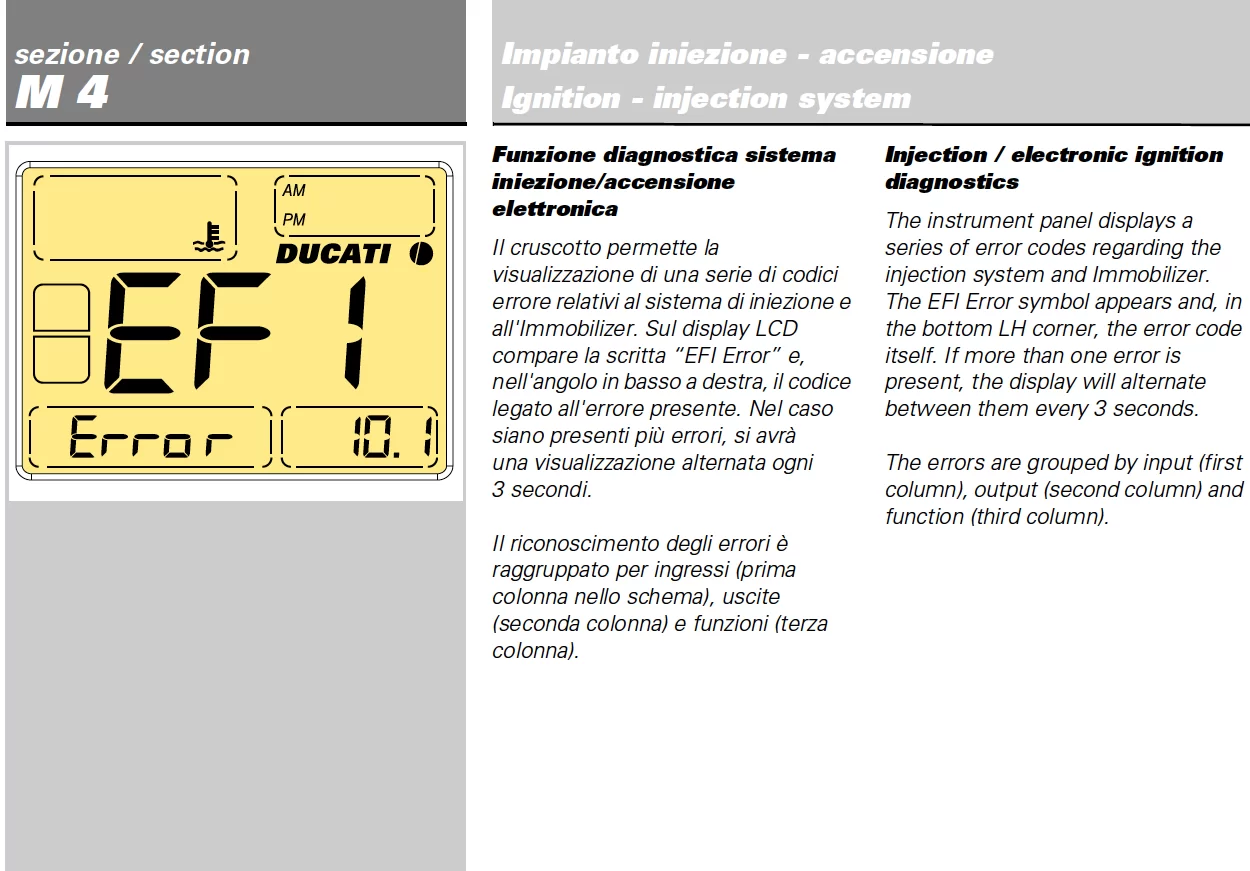

WITH IGNITION OFF, HOLD THE LEFT BUTTON ON THE DASH DOWN AND TURN IGNITION ON.​
READ THE CODE:-​
749/999 ERROR CODES​
  • 1.1 TPS Disconnected
  • 1.2 TPS short circuit to earth
  • 2.1 Pressure Sensor short circuit to power supply
  • 2.2 Pressure Sensor shorted to earth
  • 3.1 Water Temp Sensor shorted to power supply
  • 3.2 Water Temp Sensor shorted to earth
  • 4.1 Air Temp Sensor shorted to power supply
  • 4.2 Air Temp Sensor Shorted to earth
  • 5.1 Battery Hi
  • 5.2 Battery Lo
  • 10.1 Hor. Coil shorted to power supply
  • 10.2 Hor. Coil shorted to earth
  • 11.1 Ver. Coil shorted to power supply
  • 11.2 Ver. Coil shorted to earth
  • 12.1 Inj1 shorted to power supply
  • 12.2 Inj1 shorted to earth
  • 13.1 Inj2 shorted to power supply
  • 13.2 Inj2 shorted to earth
  • 14.1 Inj3 shorted to power supply
  • 14.2 Inj3 shorted to earth
  • 15.1 Inj4 shorted to power supply
  • 15.2 Inj4 shorted to earth
  • 16.0 Pump Relay
  • 17.1 LH Fan shorted to power supply
  • 17.2 LH Fan shorted to earth
  • 18.1 RH Fan shorted to power supply
  • 18.2 RH Fan shorted to earth
  • 19.1 Starter Solenoid shorted to power supply
  • 19.2 Starter Solenoid shorted to earth
  • 30.0 ROM/Eprom error
  • 34.0 Signal Panel Sensor
  • 36.0 Speed sensor
  • 37.0 Immobiliser (transponder)
  • 37.1 Immobiliser (antenna)
  • 37.2 Immobiliser (instrument panel serial driver)
  • 37.3 Immobiliser (serial cable disconnected)
  • 37.4 Immobiliser (ccm serial drive)
  • 37.5 Immobiliser (key not recognised)
  • 37.6 Immobiliser (ccm program)
  • 38.0 Can Line error
This is what it should look like

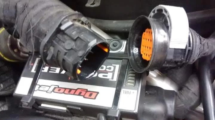

Also, diagnosing a fault isn't always as straight forwards as just reading a code.
In the summer my bike had a complete electrical failure, it was as though the battery had been removed, absolutely nothing electrical worked. It came back to life once I got it home and then died again but I got a 4.1 air temp sensor fault code.
This was unlikely to cause a complete electrical failure so I started checking at the battery, all good. Next I unplugged and replugged the big connector above the battery box, just the dash came to life. Hmmm 🤔
Cleaned the connector pins and everything works, even the 4.1 fault code had gone.
The offending connector
If I'd have found this earlier I could have avoided the heckling from all the slack jawed riceburner owners stood watching as old Giallo Veloce was pushed into the back of a van*, even a KTM owner joined in 😲 🤣
Bloody 17 year old Italian electrics ⚡🍝
