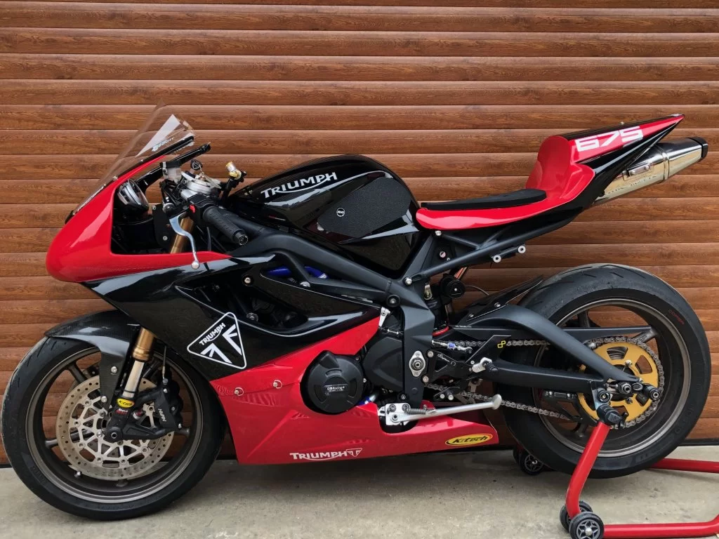

Bike was bought with crash damage late last summer for a bargain price. I then fully repaired with Triumph parts for the road. MoT pass first time.
Then work to convert to track bike with a view to keeping costs as low as possible and doing everything I could myself. The K-Tech kit cost more than I paid for the bike and was by far the most expensive item. Most parts were sourced over the winter months from EBay. Paintwork was done by me using rattle cans and lots of tea.
Finished this morning (bar a little fettling). Plan is to run this year as a minimum.
SPEC LIST/WORK DONE
  • K-Tech DDS Lite shock
  • Hyperpro RSC top mounted steering damper
  • Forks stripped and rebuilt with K-Tech SSK fork kit. K-Tech springs. K-Tech oil
  • Suspension set up by Steve Jordan

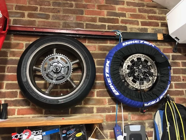

  • Metzeler TD slicks (two sets of wheels – one slicks, other road)
  • LighTech rearsets, road pattern
  • Triumph lightweight (TORS) race exhaust (removable baffle fitted)
  • BMC race air filter
  • NGK iridium plugs
  • Brembo SC pads
  • Motul racing brake fluid
  • Calliper strip and new seals
  • Wheel bearings and seals
  • Skidmarks fairing and seat unit, rattle can paint & lacquer (Halfords)
  • Zero gravity race screen
  • SES lock stop
  • MPW Race nose cone and instrument bracket
  • QR filler cap
  • Samco blue coolant hoses
  • Halfords OAT coolant
  • Triumph QA throttle mod (throttle tube from Triumph 1050 fitted)
  • Front sprocket -1
  • Talon rear sprocket +2 and standard
  • GB racing / R&G Engine protection
  • GR Racing fork protection (not shown in pictures)
  • GB Racing brake guard
  • R&G carbon tank sliders
  • R & G bar end slider
  • R&G tank grips
  • R&G swing arm protection bobbins
  • Triumph OE Quick shifter
  • Hydraulic brake light switch (for MOT)
  • Triumph carbon exhaust end cover
  • Triumph carbon front mudguard
  • Triumph carbon shark fin
  • New OE clip on grips
  • Optimate lead

Good work fella 👍

Looks a lot of fun
I have had it on the road through winter. It’s nimble and has good grunt. The weight savings compared to road trim will help ( as does the gearing).

That's a cracking job chief, the fit and finish excellent, paint looks amazing for a rattle can!
Cap well and truly doffed sir! (y)

Thanks Bob. I really had to resist hard making it too nice as it’s ‘just’ a track bike. But I enjoy doing it.
The spraying was a bit of a task as in my impatience to get it done I did the first and second top coats when it was too cold really. So, I had to rub that all down and start again. Patience was never a strong point.
But with the warmth of this week and some elbow grease, voila 😎

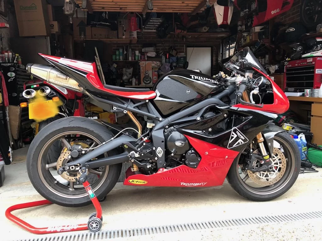

AirCon
is it me or is it really low at the back.......?
Yep... I think it looks like its for short arses.... and i'd have to have three times as much padding... with some at the back... at least for grip.... even 20 Grit sand paper would do.
Also that is a lovely track bike.

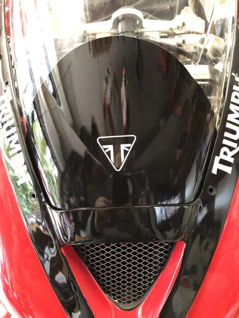

Bit of tidying up before the bikes first track outing a week tomorrow.
1. Relocated the RegRec to under the air intake tube rather than tucked down the side of the fairing. Mounted on alloy to assist heat dispersal.
2. Fitted gloss black wrap to the bottom of the screen to tidy up the front a bit more
3. Fitted zip tie mounting points so I can hold the fuses and relays safely in the fairing without too much bother.
4. Fitted the baffle and wadding to the end can. 😞
5. Checked fastening torques
