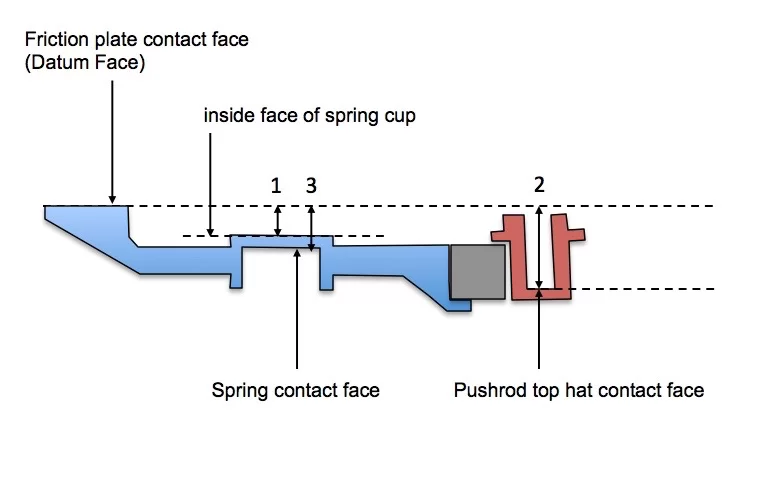

There are several dimensions that differ on some pressure plates from the OEM.
Don't be alarmed or worry about the tophat bush in the image above - it needs replacing due to distortion in the powerpoint cad.
As an example:

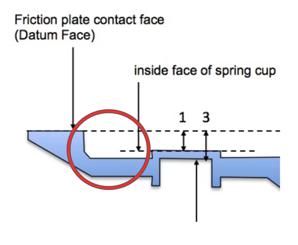

Measurement 1
The friction plate contact surface of the plate to the flat inside face of the spring cup:
OEM 3.33mm
DP 4.7mm
+1.4mm difference
In itself this one bears no relevance until you remove plates at which point its this face that will bottom out on the hub (pushrod not withstanding).
The OEM one has a bit of a rebate for the hub but the cnc plate is on one plane across the inside.
Measurement 2
Friction plate contact surface to the contact face of the pushrod top hat in the bearing housing:
OEM 21.3mm
DP 22mm
+0.7mm difference -
At the very least, the actuator rod needs to be the difference longer in order to actuate as per the OE. In practice, the feel will appear to give a shorter throw to disengage the plates - but it's all still in spec with the OEM hydraulics.
Measurement 3
Friction plate contact surface to the spring contact face:
OEM 10.13
DP 11.1
+0.8mm difference -
What this means is that the the spring is already preloaded and thus shortened.

Bearing in mind that the OEM clutch setup moves the slave piston by circa 3.6mm.
The minute you swap the slave out with an Oberon you give up nearly 1mm of that for the lighter pull.
Its all within tolerance for the OE setup but the minute that the pressure plate is swapped out you're at the mercy of the plate designer's measurements, and in the case of the DP one I measured, it was schemed to work within the design constraints of the OE master cylinder and slave.
That's when all the various tolerances and heights start going a bit Petrovich Tong, and you end up pulling plates out of the stack like sweets.
The most important rule is to not be in a rush and only effect one change at a time if you don't know what outcome to expect.
Don't go changing everything only to find that this or that no longer works.
See how each individual component affects the thing and this learning helps your decision for the next stage.
Like all things, measure twice cut once.
The following is courtesy of @Andyb
The stack height on a std non slipper clutch isn't critical within reason due to the height of the mating face on a std pressure plate. As this has a splined boss that sits on the inner drum it can slide in and out to quite a large tolerance.
This is also who you can't/shouldnt use a pressure plate from a slipper clutch on a std clutch as that doesn't have said splines.
