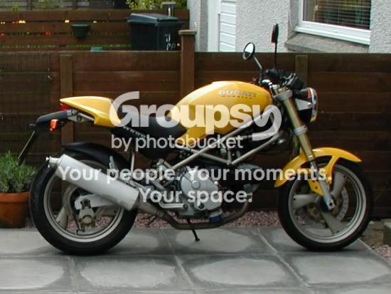

1994 Monster M600
I got the engine (and belt covers, exhaust clamps and collets) back from the blasters today and it looks quite good in black etch primer.
Silver engine paint and a Stainless Bolt Kit will be purchased sometime next week.
