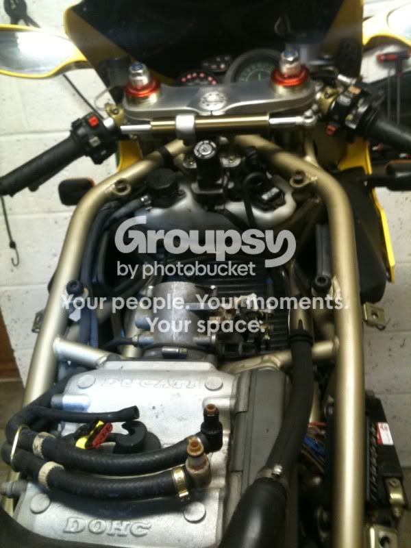

Its coming apart quite nicely
sorry,amused me,feckin battery sits on it behind the fairing Ducati Racing
yikes
marks lined up before taking old belts off
Looking good Colin - I have some of those wee O-rings for the fuel pipe QR's knocking about somewhere, will try and look them out for the masher. IIRC they could 'nick' quite easily and you got petrol p1shing everywhere when you turned on the ignition. Maybe it was just me being ham fisted with the connectors though.

they come off quite nicely,felt a clean release if ye ken whit I mean !
New belts on.........tensioning time :eek::eek:....though Derek says we fret too much about the tension :D
Touch wood(nothing new there then ;)) the bike does look to have been looked after,backs up all the invoices i have.After the belts etc I'll drop the oil after what I've just said I'll probably find lovely wee shiney shavings in the gauze doodaa :eek:

Belts tensioned,correctly I think,I've now 4 apps on my iphone finally got one that I was getting consistant readings to get the HZ set right,feckin tips of my thumb has worn away with all that strumming :D
Also checked with the allen key method,I used this guide to keep me right.
http://www.tassell.co.uk/belt_change.htm
