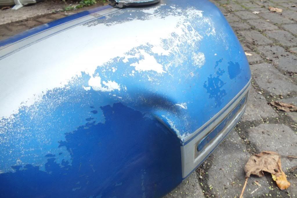

Paddy, please keep up to date on this forum - there's plenty of bevel activity and you seem to know most of the answers! Just tell me how to match the GTS blue paint...
I will ask John at MIIM when he gets back from Italy next week, i think his GTS in his private collection is metallic blue so he must know what they used to spray it. It looks to me like the Mk3 blue i used on my build , the one before last

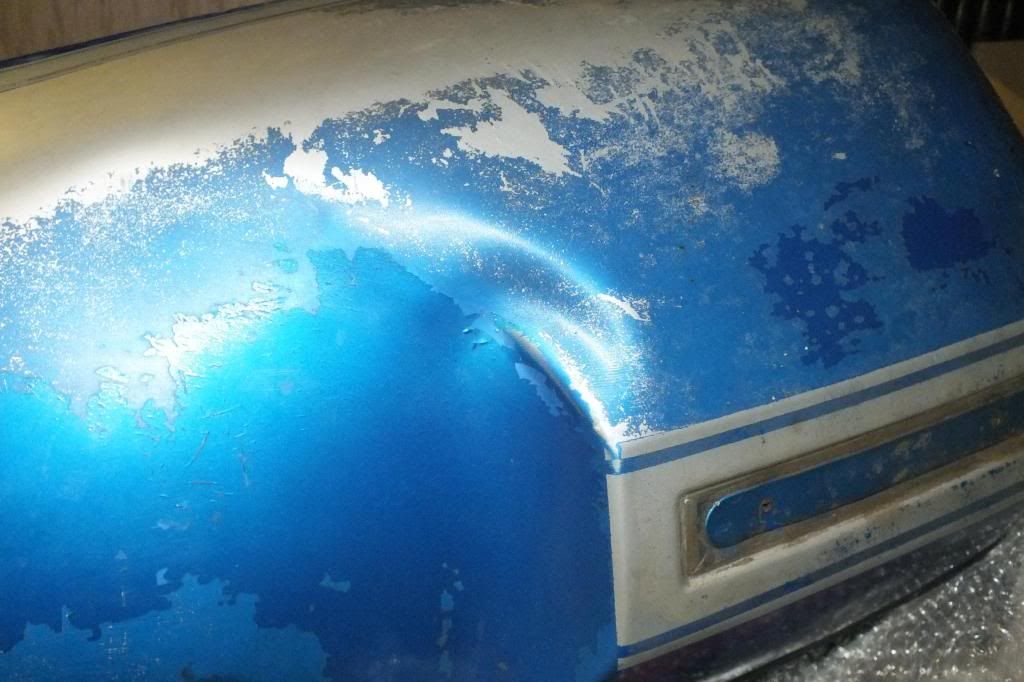

If it is then its actually metallic silver with a clear blue top coat.
900GTS Blue...
Nice Mk 3 paintwork Paddy!

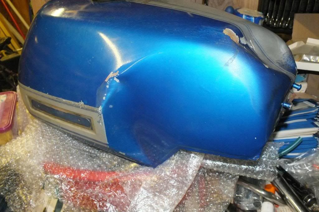

Here are a few picky's of the better of my two tanks (I am not kidding, keep your jokes to yourself ;-) )
Being a fan of deconstruction, it seems to me there is indeed silver under the blue. But those silver stripes are definitely on top.
Ah, this is all excellent information on the blue paint. :lol2:
As usual VP puts me in the shade when it comes to a competition for who has the crappest raw materials. My tank is actually in quite good nick apart from one minor ding.
It does need some treatment on the inside to get rid of the rust - so if anyone's got experience of this I'd be happy to hear about it.

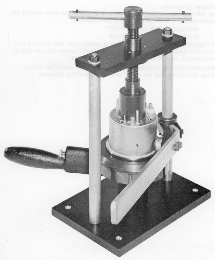

I would be interested to know what people charge for clock rebuilds ? Its something i might offer as a service in the future.
( just reading your questions on VP's thread)
I think I just need to buy new bezels and have them crimped on - but I'm sure this is best accomplished with the proper press. I'd better stick the drill in them both and give the drives a spin to make sure there's actually something happening in there though!
the place i linked to on the other thread that does ND clocks, quotes 139 euros per clock.. I've ordered a set of their bezels for mine - luckily i only need one so have a spare in case (or when !) i cock up the fitting - they've a video on youtube where they clamp the bezel in place then turn over the edges with a screw driver... ??
