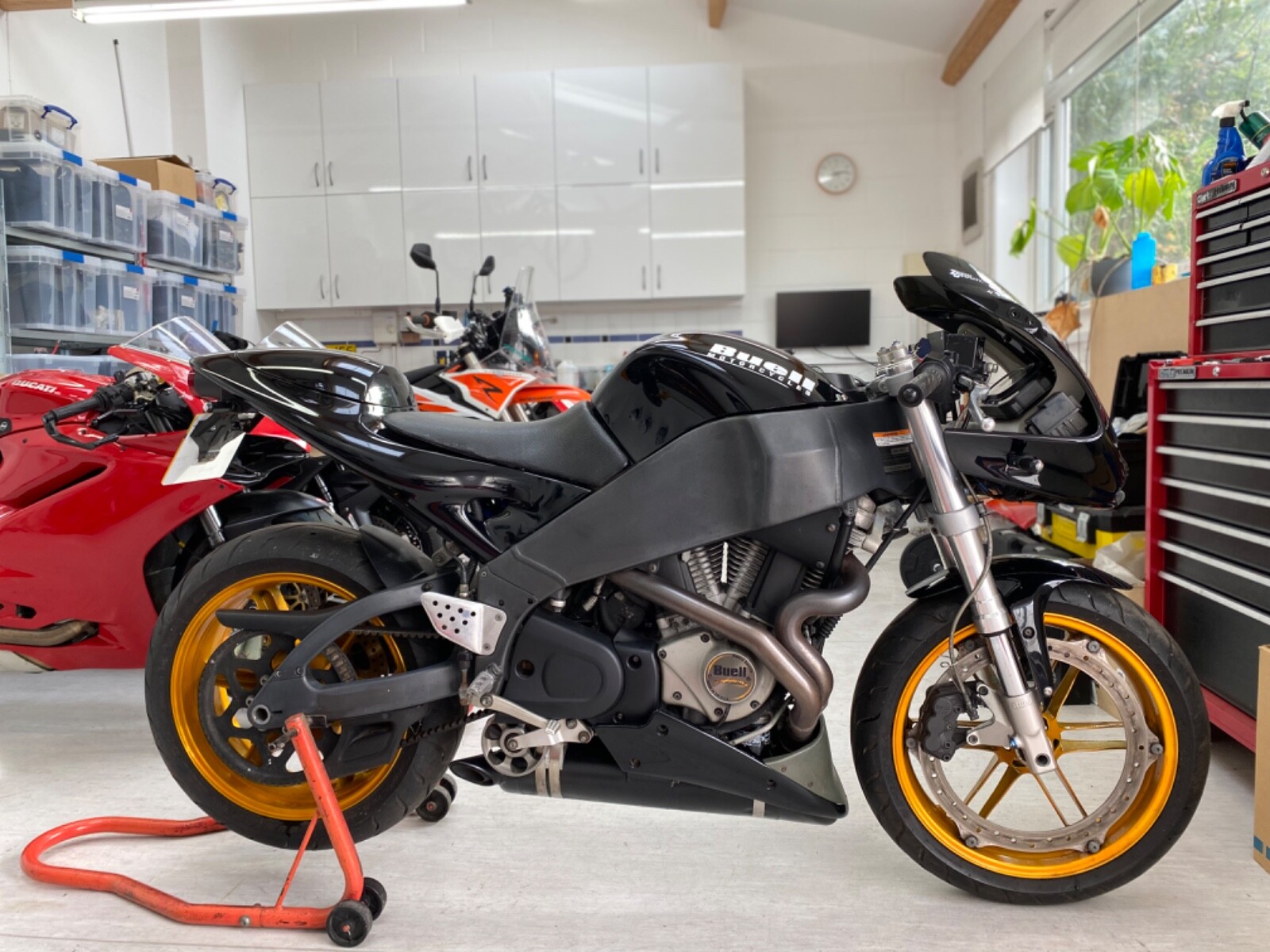

Both are good IMO similar in many ways yet different. Most noteably the powerplant and cooling. I have a hybrid of the air-cooled V-twin XB12R (top pic). The 1st significant improvement on the XBs came in 2008 where Buell rolled out the Thunderstorm engine for the XB with a bump in HPs, torque and improved maintenance. The XB performance in the curves and torquey nature are signature characteristics of this model.

Agree on all counts, I've always had the race kits, the only time I had problems with the fuel injectors was due to HD mechanics working on my " That's not a Harley" bike - they were right of course. I never went back and do all the work myself which has fortunately been typical annual maintenance. Problem is getting your hands on those race cans. The OEM race kit is the best if you can find one.
