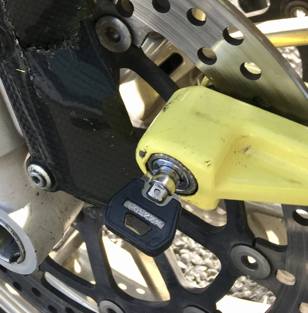

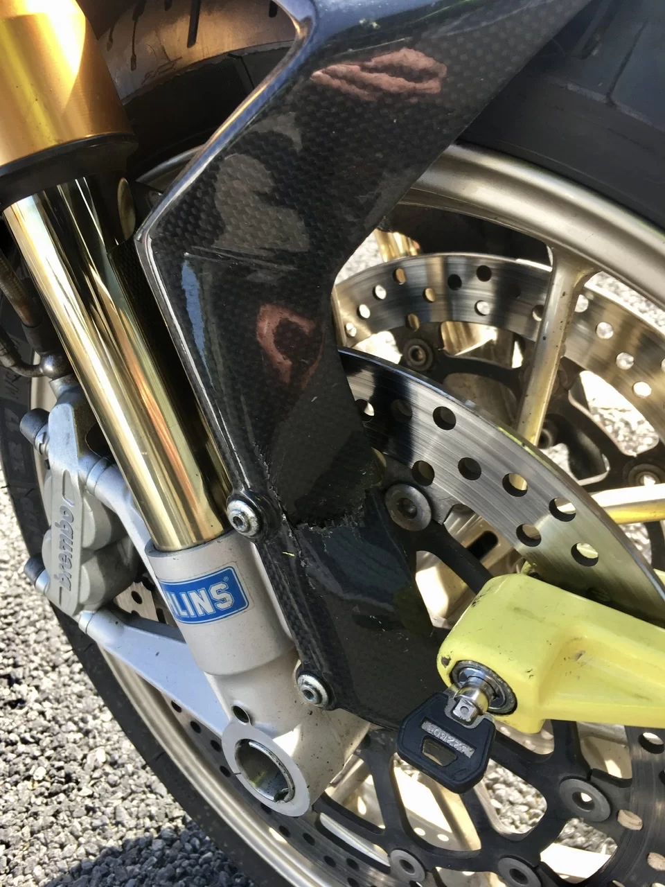

Only a short time after I got my new bike I damaged my front CF mudguard, just slowly rolling the bike a few inches, I heard a crunch, I'll never use a disk lock again....

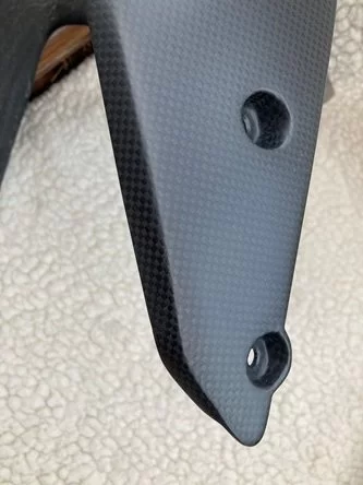

Any way I tidied it up a bit, but it was quite obvious and I considered a new guard. But I found a local company that specialises in the repair of carbon fibre cycle frames.
They did a great repair for £50, considerably less than a new part. It now looks like new. Apparently they do structural parts too. They have repaired quite a few BST carbon wheels.......

Exactly the same thing happened to me 😕 I’ve still not repaired it 🙁. I reckon I could glue it as suggested by @Duke of Prunes but it’s repairing the face of it so it’s unnoticeable that would be the tricky part. Even @Expat Jack ’s skills might be stretched to do that.
