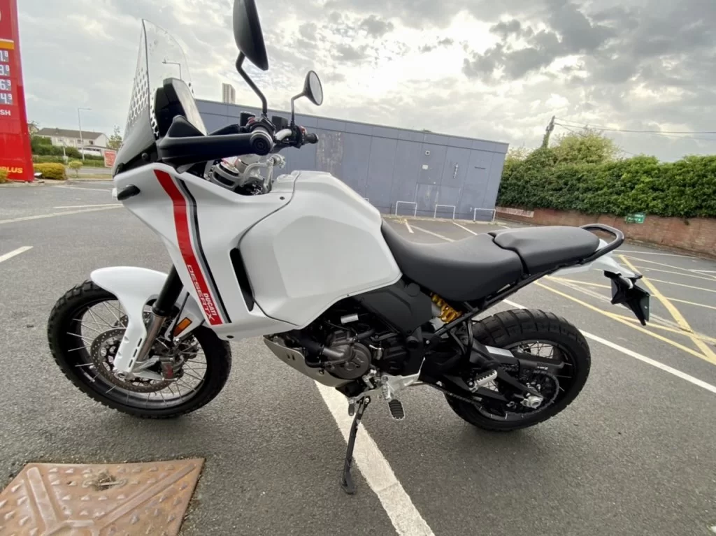

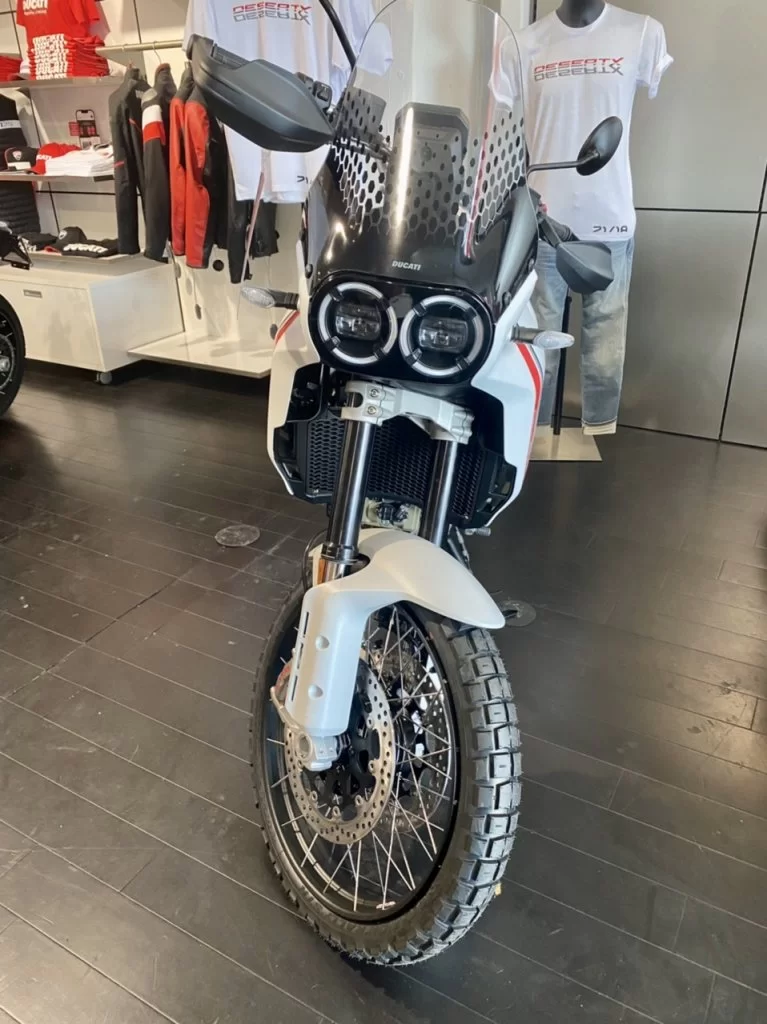

My Multistrada V4S was being serviced the other day and the dealership gave me a Desert X to have a little play around on, although I could only have it for the morning as it was booked out later that day for another couple of test rides. Also, sadly, as the dealership is in the middle of a conglomeration of industrial estates and housing estates on the edge of Dublin City, and as the nearest possibility of taking it off road is over an hour's ride away, there was no opportunity to test ride on anything other than tarmac. I'd love to have it for a weekend out here, off the beaten track, in West Cork and really put it through its paces.

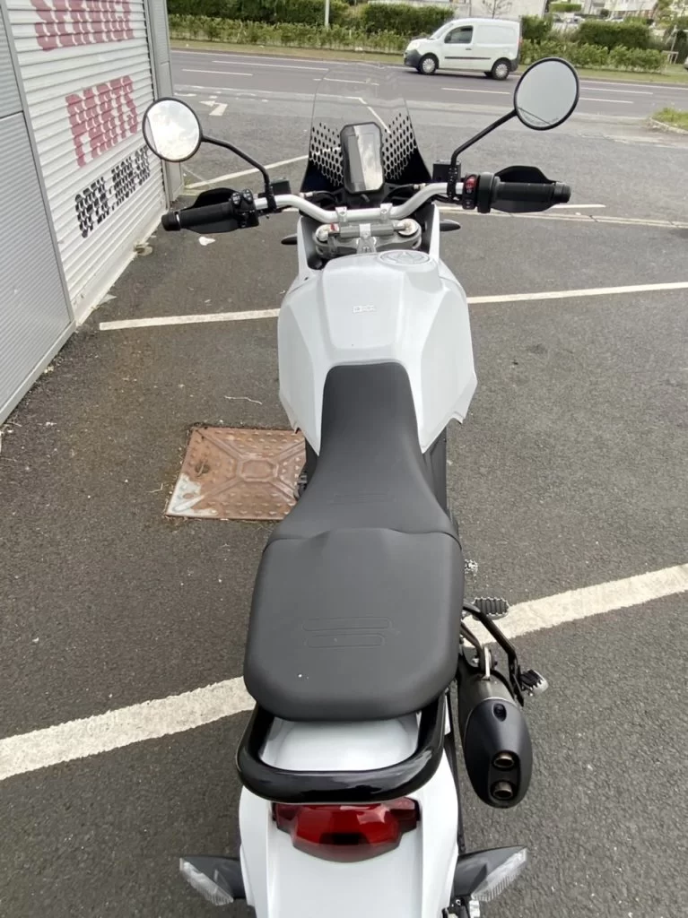

First impressions, it feels much smaller than the Multi, which of course it is width wise. The seat feels higher, but on checking, the seat height is 850mm and I have my Multi seat on the high setting at 860mm so actually, it's slightly lower. I think the impression of the increased height may be becuase the rider seat pad is slightly wider than that on the Multi so your legs are spread wider, which in turn lifts them higher off the ground. It wasn't a problem for me at 187cm to put both feet flat on the ground but for those of shorter stature you my wish to make sure it's comfortable for you.

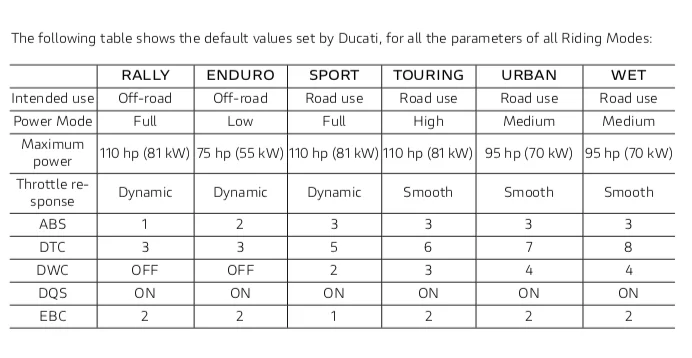

I have to admit I'm not really sure what the difference between Urban and Wet riding modes are for the default settings are almost identical, the only difference being that DTC is set at 8/8, ie max, as opposed to the Urban setting of 7/8 🤷‍♂️
Rally and Enduro settings are for off-road use with a useful, and perhaps sensible, difference that Rally is set up for experienced off-road riders whilst Enduro is set up for beginners.

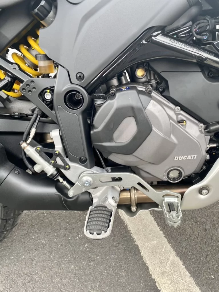

So, what's it like to ride? Its good fun, its great fun. It makes a great urban bike(y) . It does a little 'agricutural' having just got off the Multi in as much as the gearbox is really clunky but I fully expect that would smooth out with use once it's fully run in (this one had only done 500Km) and just the general feel from the L twin engine is coarse but then I have just come off a V4 so its not a fair comparison, again, I suspect that as it gets run in it will improve.

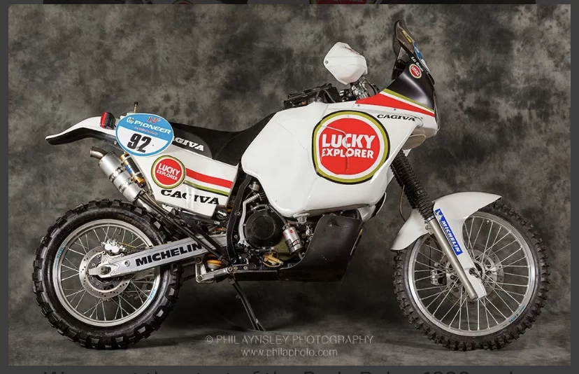

@Dirty Leeds whilst you may not like the style of the bike it is reminiscent of and based upon the Paris Dakar Cagiva Elephants. It is also selling in huge numbers in places like the US & Australia where owners can actually ride it as intended in a desert. It’s a bit of a winner for Ducati apparently.
