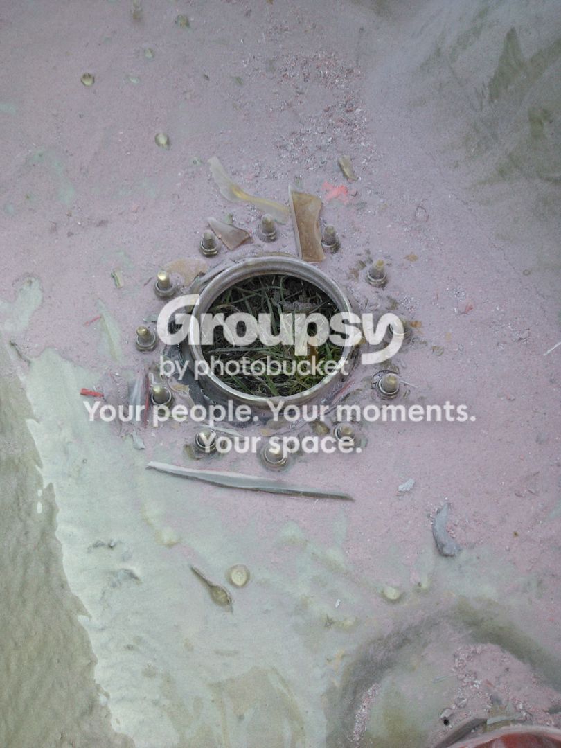

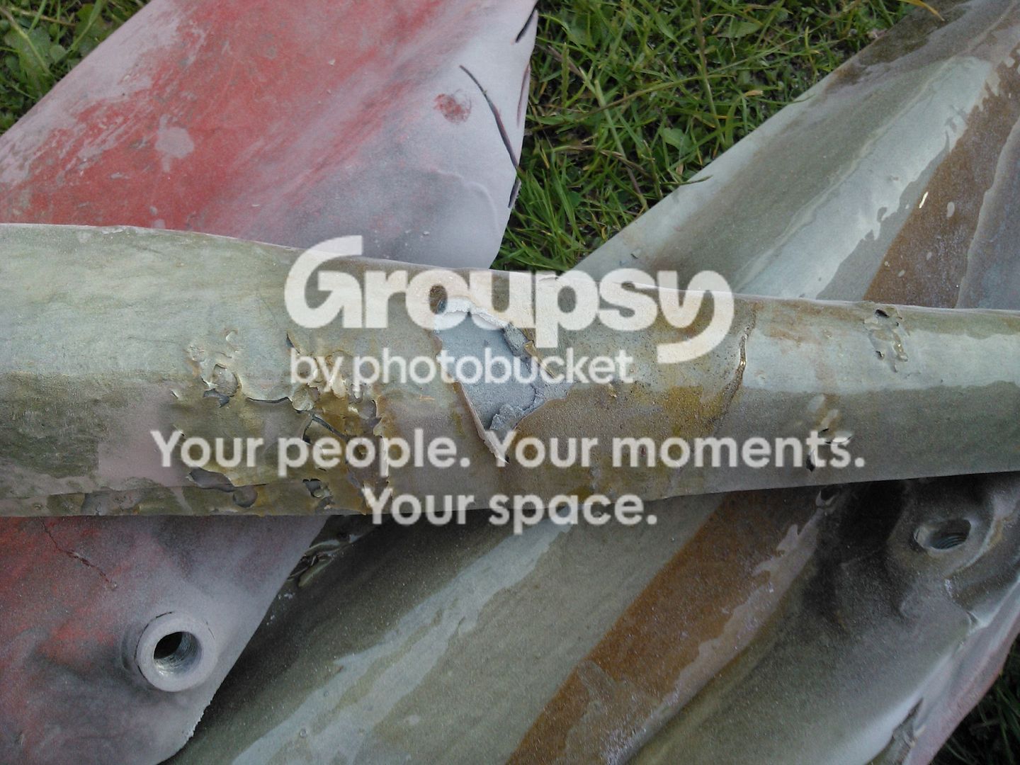

It's been a while but I finally got round to looking at the Darmah again. Since the insides of the tank had been attacked by the fuel, despite sealing, I decided to chop out the 'tank' bit so I can make another from steel or alloy and just use the tank-seat as a cover. It was fascinating to see the way the sealer had and hadn't worked in various areas, almost entirely due, I would say to my not having kept it rotating all the time. If I have to do it again I'll rig something up with a cement-mixer or 'mangle' stand. The 'edge' around the filler was attacked and the tunnel but almost everywhere else was sealed ok.
