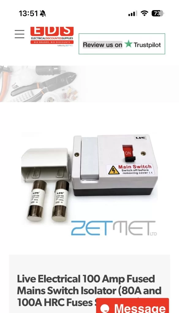

I live on a small holding that had 3 phase at some point, I won’t need it again as I’m unlikely to have livestock.
Anyone know if this:
Can be replaced with one of these?:
Thanks.
Thanks.
No.
And employ a commercial electrician to replace the local disconnect isolator.
That 415vac is shocking, if you are unfortunate enough to bridge two live phases.
Even the 230Vac to earth is deeply moving / unpleasant...
In fact depending on where it is you may need the board to do the replacement.
No.
No.
Local disconnect is done at the cab on the telegraph pole, this is for outbuildings.
If all three phases are wired then no
Why not replace it with a 3 phase distribution board
Or feed the isolator you chose from one phase using a suitable swa cable
