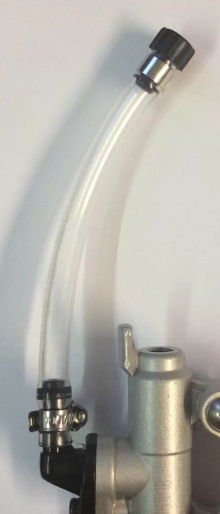

Right hand rear-set mounted - just not too keen on the white reservoir so might have a look what's available. Brembo do a smoked one but the pipe comes out at 45 degrees and won't fit the preformed tube which fits nicely. I will ponder for a while :unsure:

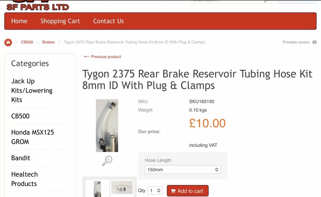

Shuntit just be a length of clear pipe a la:-
I have one on the YR5 like that but don't think it would suit on this and fiddley to fill :unsure:
Fairy snuff matey, it’s your baby, but it’s what I’d expect to see on a ‘retro, resto,one off, hybrid, up-scaled model’ of a Kawasaki racer rebuild. It weighs less than a reservoir and if you need a few varying sized syringes to fill it with I think I have a selection in a drawer somewhere.
