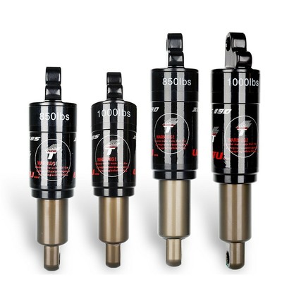

Have you thought of mountain bike shocks? This is just an example and many can be had by uk bicycle shocks suppliers to the length and weight limit
The problem with these & many like them, (from what I know) is that they are way too stiff for one human, unless you are a real fatty. Even though I'm not a light-weight I'm not a whale either, which you'd need to be to get these units to move & work. Units that are pre-charged with gas are even worse & harder to make work.
Many push bikes have linkages which work at set ratios without which just me sat on them, isn't enough weight/leverage to get them to work. Also, if you double up & have two units then that makes this problem even worse. Basically I'm trying to get something to do a job that it was never intended to do.
Also, many of the more expensive cycle shocks are too long for my application & just wouldn't "look" right, (in my opinion ;))
Because my builds are made to look old any seat suspension unit really needs to have a coil spring visible to "look" right :ROFLMAO:
Ideally the Maxton route would be the best route to go, providing I could come up with a mounting system that "looks" right & in keeping with the bike's style. At least the unit/units would be designed to work with my weight & set-up. We'll see when I get to that point, at the end of the day I'm not building a bike to tour on or get round the Isle of Man fast so it will be what it is & I'll just have to accept that & live with it.

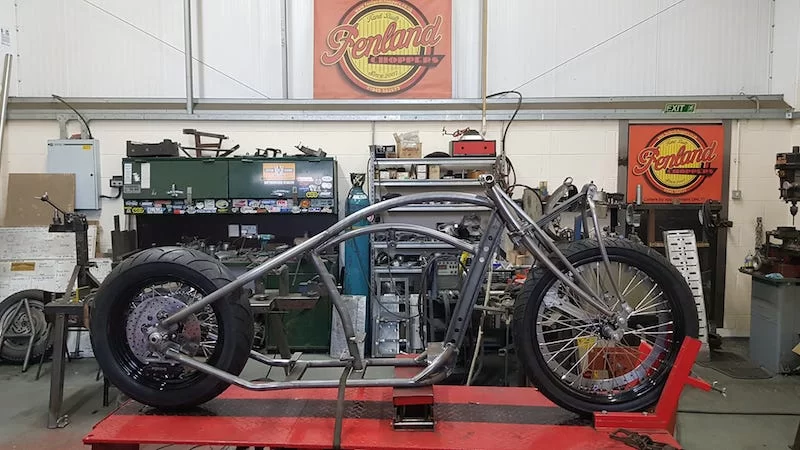

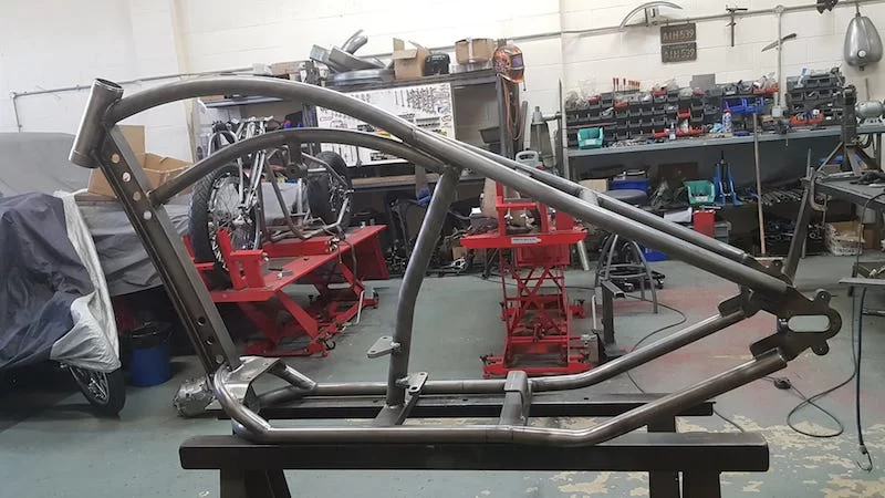

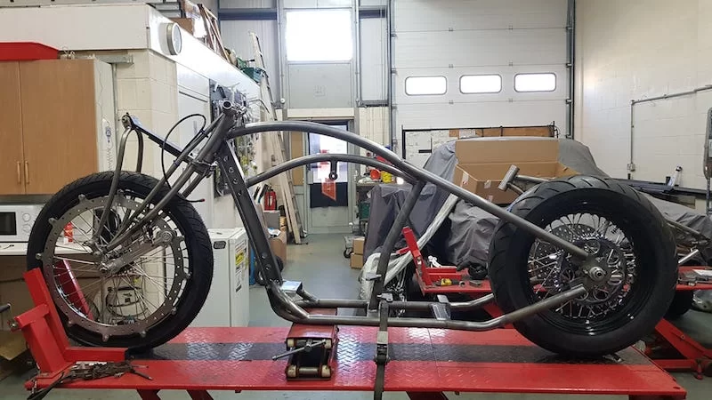

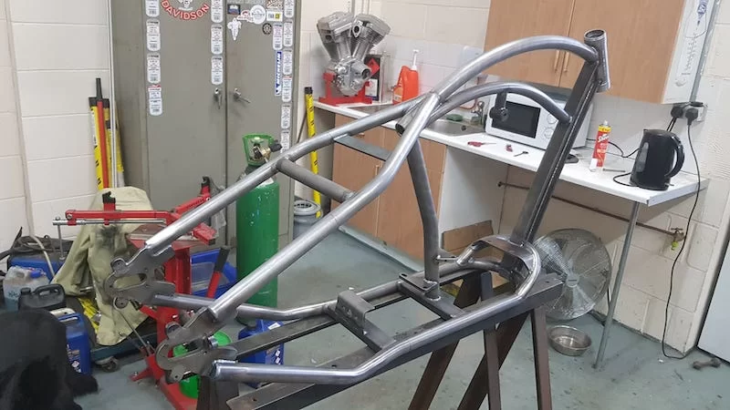

Took the front forks & rear wheel for a little road trip today to Wisbech & the frame builder. Hopefully the frame should be ready for collection mid September, fingers crossed.
Joe did the first frame & I was happy with that. The new fame will be much the same as the first one, but with a few tweeks to suit the different forks & narrower rear wheel/tyre.

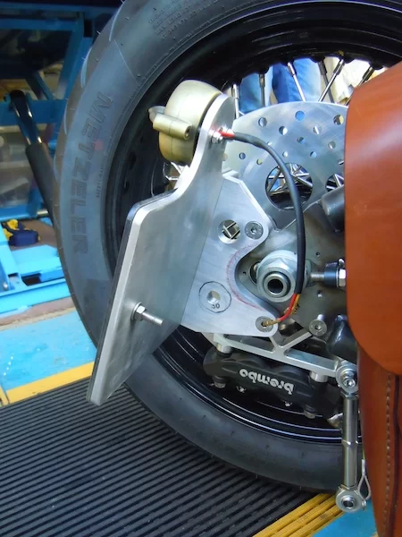

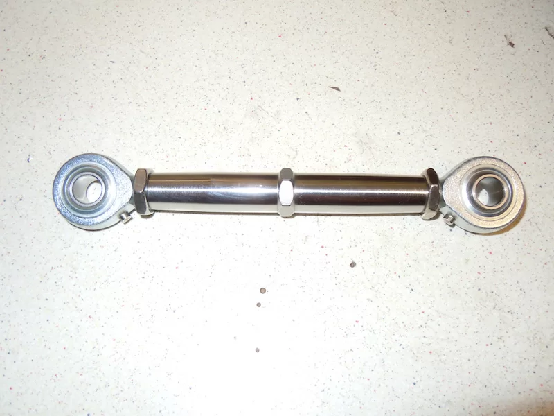

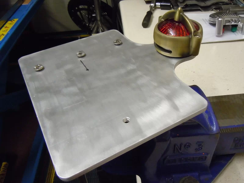

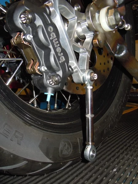

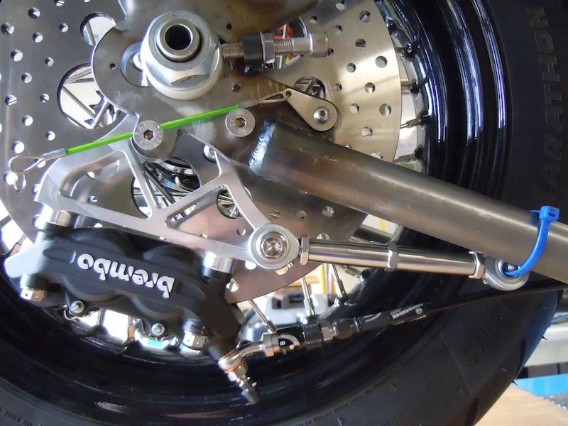

While I'm waiting for a few frame brackets to be welded I managed to make the number plate mount & rear brake torque arm. Also drawn a template for the number plate to frame mount too.
I'll most likely change the two rod ends for stainless steel versions, I just used these two because I had them in my "bits box".
Need to make a suitable bracket now to weld on the frame to fix the other end of the torque arm to.
The three mounting screws need countersinking, but I'll leave that until I've marked the three positions on the frame mount part. It also needs another hole for the actual number plate itself.

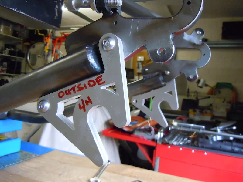

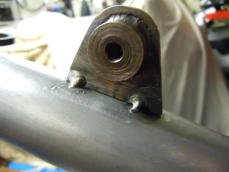

Got the rolling chassis up on my ramp this morning & made a cardboard template of the number plate frame mount. Also, opened out the pilot holes & threaded them for the number plate mount, paddock stand brackets & rear wheel axle nut retaining "E" clip.

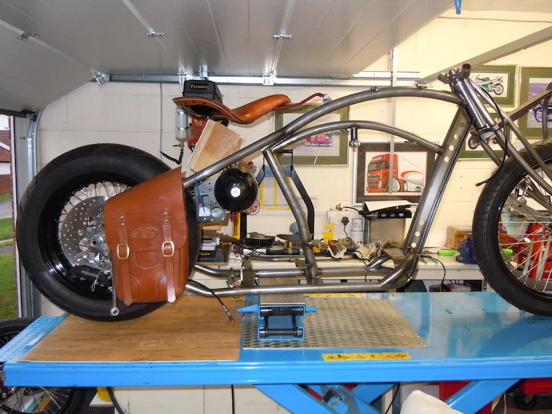

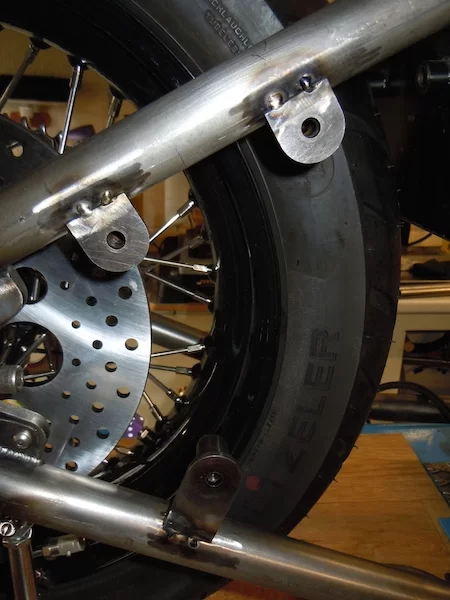

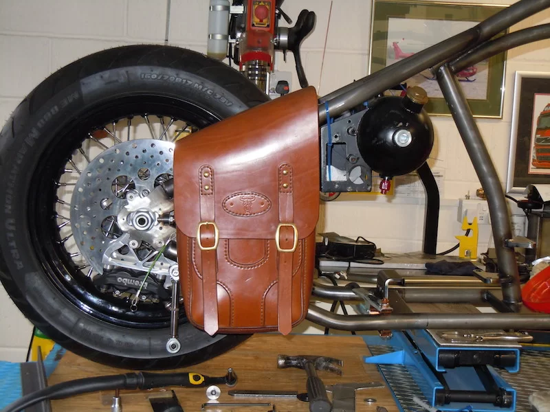

Had a bit of garage time today. Got the saddlebag mounts tacked on in to position & the front seat mount tacked on too. My welding isn't good enough yet to do the final welding, but at least I can tack things in place ready for my welder friend to work his magic ;)
Saddlebag mounts,
And saddlebag mounted. This was the original saddlebag I'd had made for the first bike, but it dragged on the road going round righthand bends so I had another similar one made that lifted it up a bit higher. As this was surplus to requirements I used it for this latest bike, which has a bit more ground clearance & I made the mounts lift it a bit higher too. It will probably still ground out, but it's one of those "it is what it is" jobs ;)
Front seat mount,
And with the seat roughly mounted to check it looks right. Just need to sort out some better suspension now for the seat.

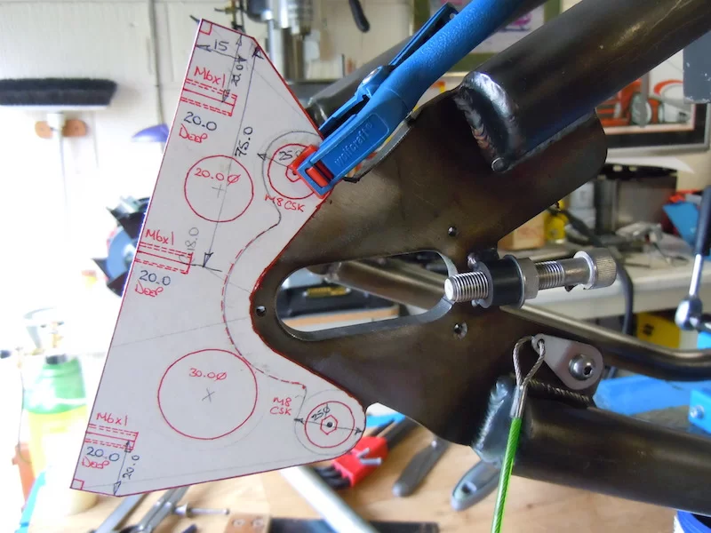

Got the number plate mounting bracket almost finished today. Just need the use of a mate's milling machine now to cut out the 30mm lightening hole, (my pillar drill is not up to that job, was OK for the smaller 20mm hole).
Need to get some black plastic number plate screws too & lengthen/replace the wires to the rear light.
I didn't open out a 20mm hole to 30mm, I drilled a 20mm hole, the upper one & I need to drill the lower 30mm hole. ;)
Because my end mills are not centre-cutting, they need a pilot hole.
I use the term "lightening" hole very loosely here. It's more about the bracket "looking" good rather than the finished bike benefiting from any weight saving modifications !!
The first bike I built has carbon fibre parts, but the frame & engine weight that much there's no real world benefit of using these modern light materials. It's just about "looks" or as some might say, bullshit ! :ROFLMAO:
Much the same as buying a Panigale & putting carbon parts on that, just visible bullshit, nice looking bullshit, but bullshit none the less. ;)
