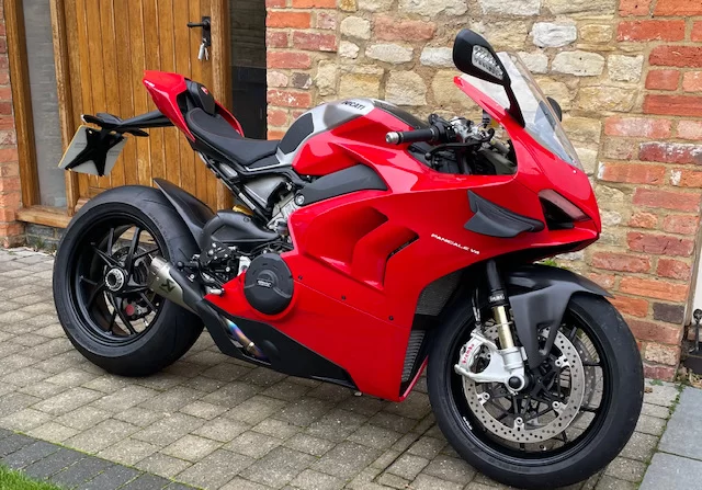

Panigale V4 2020 new bike and mods.
Some rear wheel and tyre weights to ponder
std v4 wheel 200. 60 treaded Pirelli 11.4kg
Forged mag m10 16.5 190 65 sc1 slick 9.8kg
Forged ally m10 17 200. 60 sc1 slick 10.4kg
Forged mag m10 17 200. 65 sc1 slick 10.0kg
woop woop!

So After a successful year of absolute brilliance with this bike and after a casual chat whilst walking past a 998 owner in the paddock at Estoril, it looks like ive sold the bike. After a bit of chat about spec... it ended up like this and barring any hiccup leaves on Sun.........Im on to a new project!
What’s next Andy, V4R?
did it start with "your bike's fucking shit, mine's not, you need to buy mine" delivered in your own inimitably factual no nonsense style?
I said I had one of them… too expensive for the track😂
He said ge was considering a v4 I said buy mine then he said ok!
