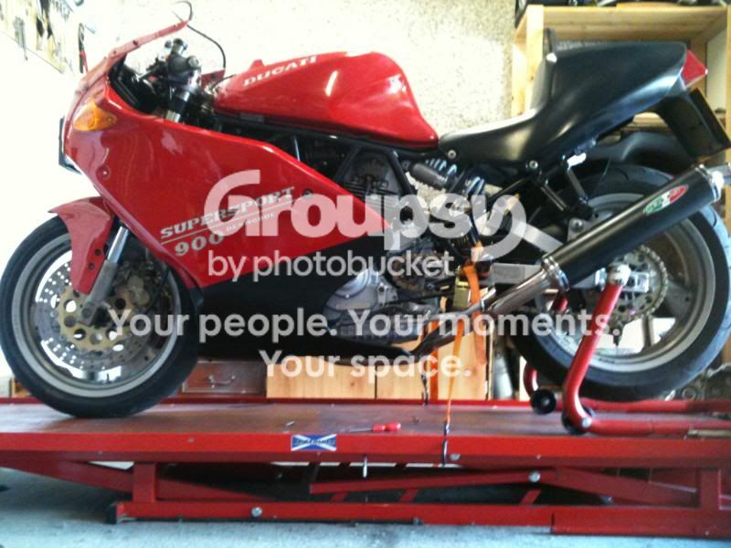

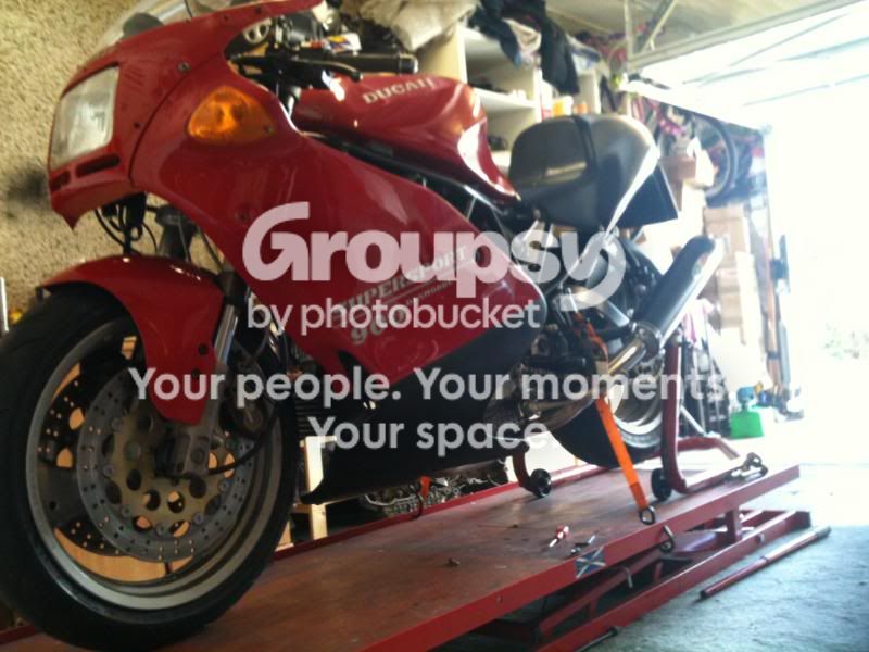

Still resisting the temptation to run with the standard(damaged) fairings on.
But .... helicoiled the rear caliper bolts as the threads were a bit ropey,1st time I've used a helicoil kit,excellent job :thumbs:.

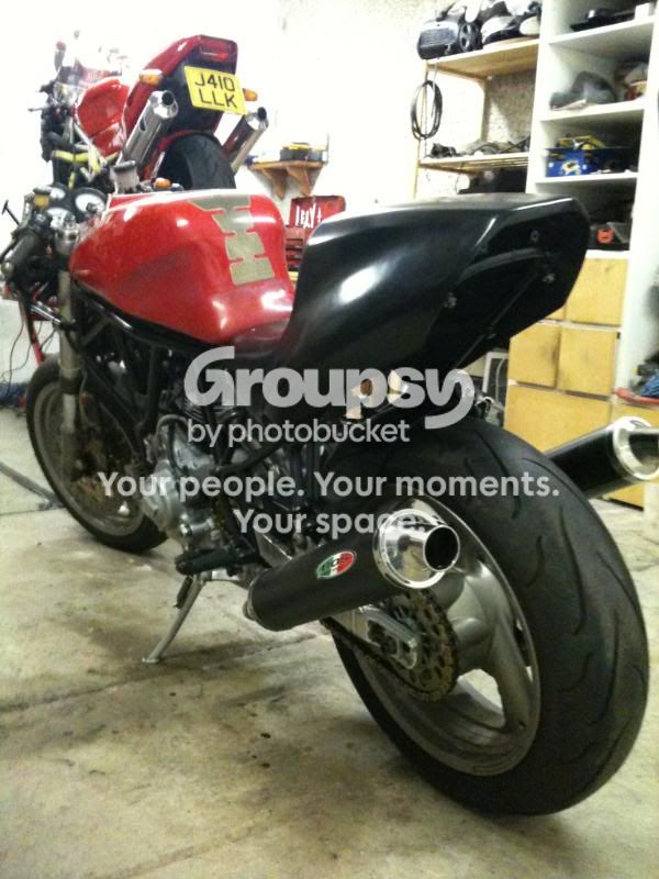

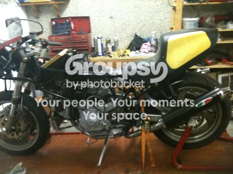

Some mock up pics

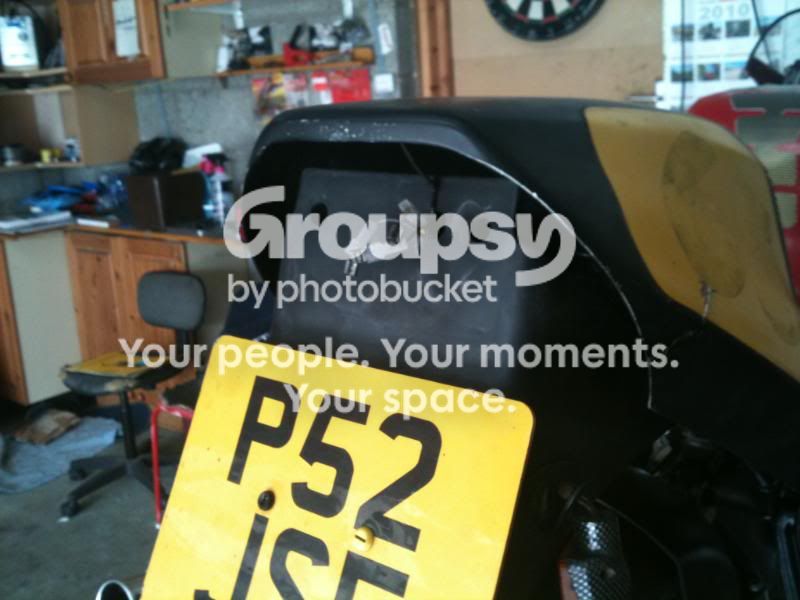

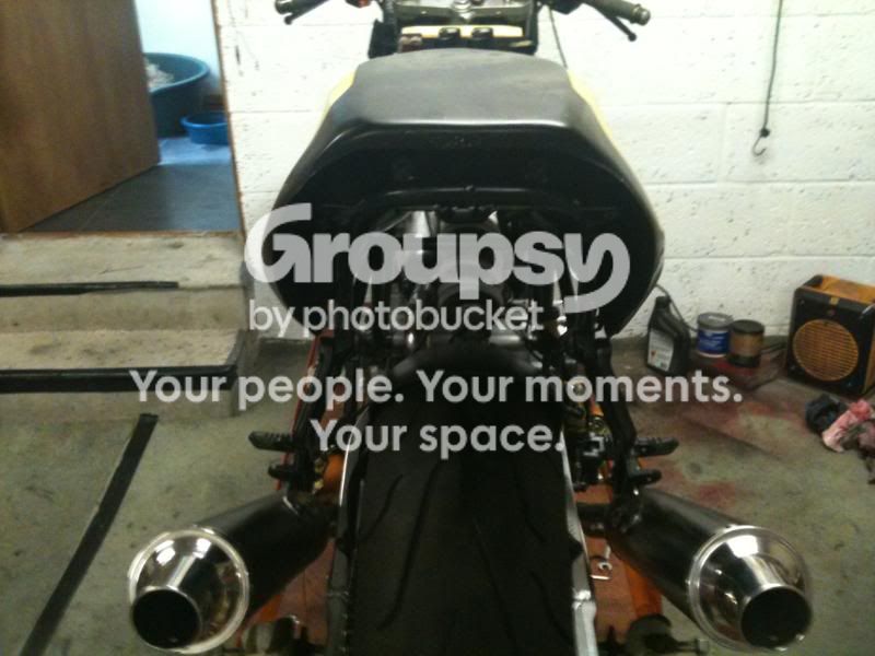

Stuck the standard undertray in,I think a wee trim at the sides and a slightly smaller plate would be ok ??
Because its a race seat it is open at the rear,standard for road bikes I think is more boxed in around the light....I don't know if the undertray with the standard light mounting takes up that space again ????
I have a 916 race seat if its any good to you a bit scabby no light cutouts it yours if you want it
cheers Davie :thumbs:, I'll try sorting this one,its the SL style i want,I'm going to need brackets with rubbers for underneath though,there is a Guy on Ducatisti that's posted up a plan,sizes etc of the brackets for Diy purposes but being the lazy bastid that i am i try buying ready made ones first....don't know if ducati would still stock the support brackets for the SL seat :dunno:

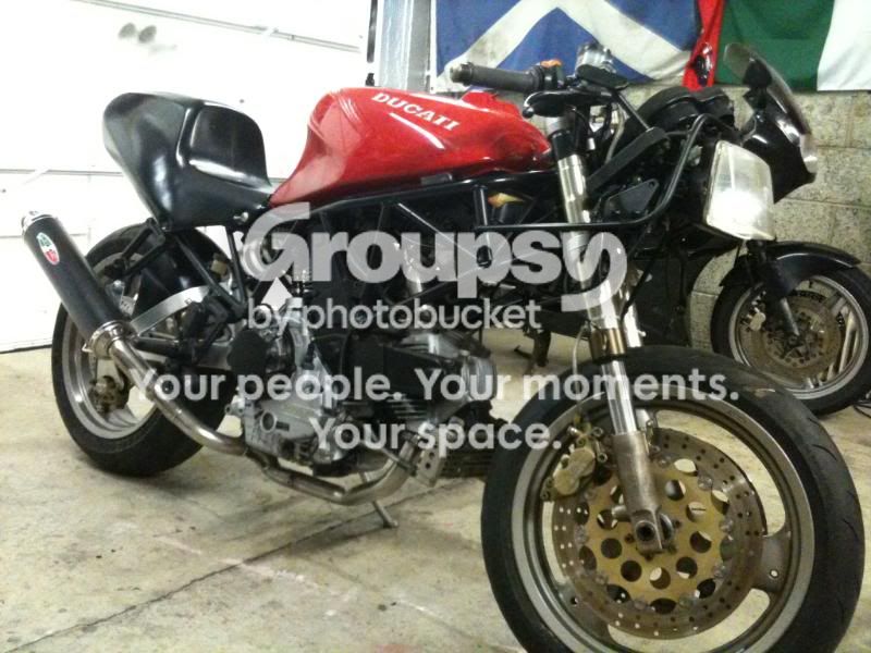

I love the simplicity,if only there wasn't all that sh1t hanging off the front of it...daytime mot ??!! (not decided on colours yet,I've only been at it nearly 6 months c'mon)
Looks good Colin. You thought of just having a monster headlight, the bracket bolts straight on to the SS lower yoke? Involves a fair bit of work tucking all the gubbins under the tank/airbox.
I think there are a couple on the ducati.ms SS pictures section, though I couldn't find them on a quick peruse.

Mmmm,aye ,also like the early ss fairings with the round light.
You can pick up a fairing easily enough and should be able to use the two mounting points on the existing frame for the lower two brackets.

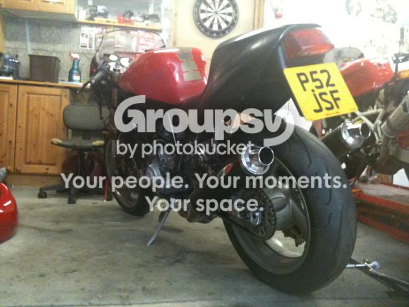

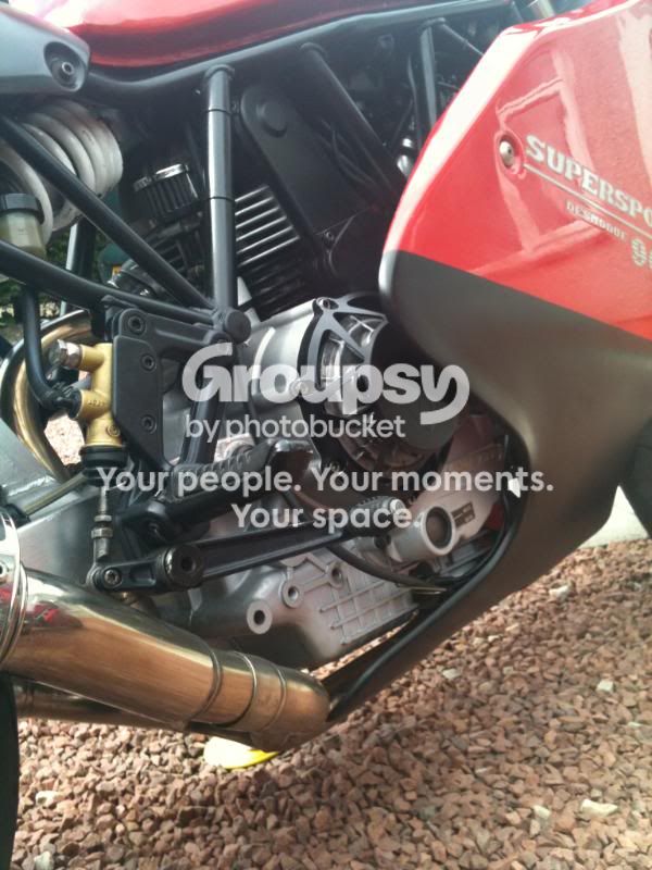

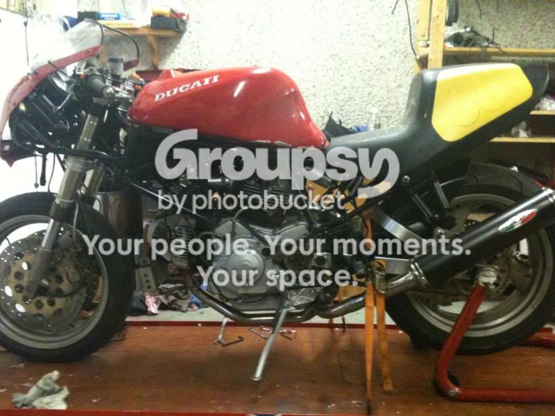

messing with a semi standard back end,undertray/plate hanger area cut away a wee bit

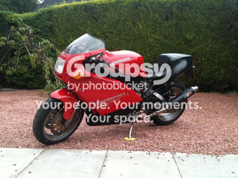

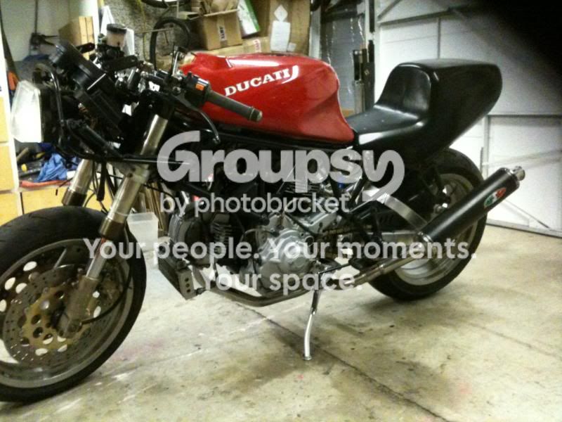

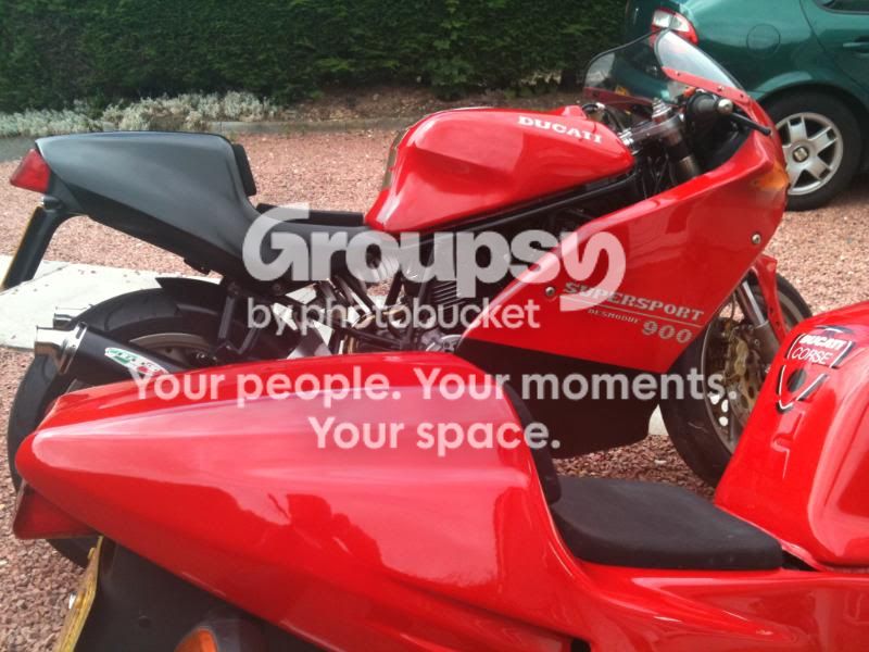

well it moves and under its own steam ! Up and down the path:D:D I've decided to bodge the standard fairings back up and get it all back together and see how it runs I just aint got the cash for what i want and rather than it sitting doing nothing I'll get her on the road at least.

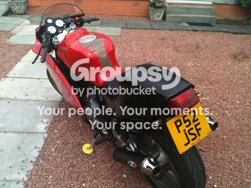

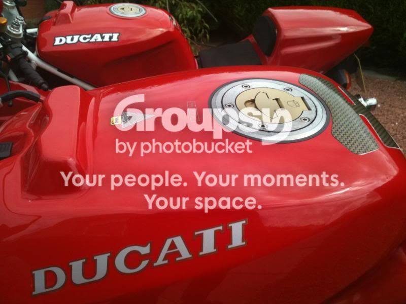

I've tidied up the tank and got that on first and got her running,she started no bother the idle needs fettled a wee bit.If id had more fuel in her id have ran her down the street to,sounds great...luv an aircooled motor :hug:
and again...up and down the street this time.
Its a bit disconcerting seeing all the reek burning from a rebuilt bike though ,as long as none of it smells like burning oil ;)
:flash::flash:
hopefully just temp bodywork,old beat up fairings roughly repaired :o:o:o

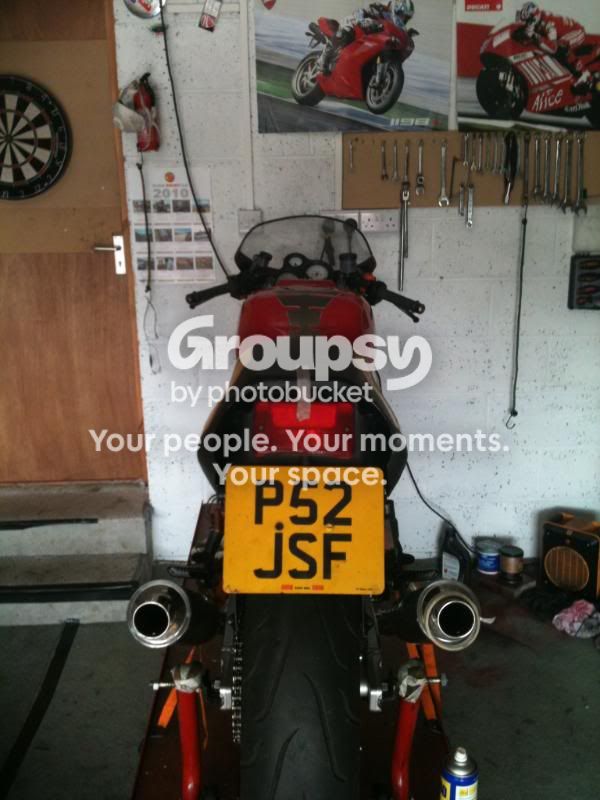

I've the headlight to align and I'll try and get a decent wee run on it then,all going well its going for mot. oooohh and decide what i'm doing for mirrors,fancy wee discreet bar end ones.

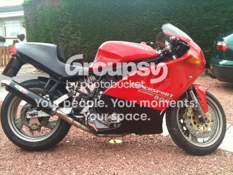

Patched up fairings/paint for now,stage2 superspurt will have wee bikini fairings and a full paint job.
(does anyone have a couple of the fairing bolts and big washers like the ones on the Supersport,I'm 2 short for my seat unit...even just the washers??)

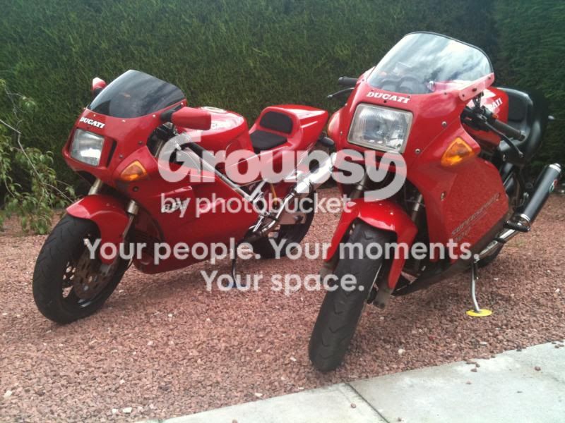

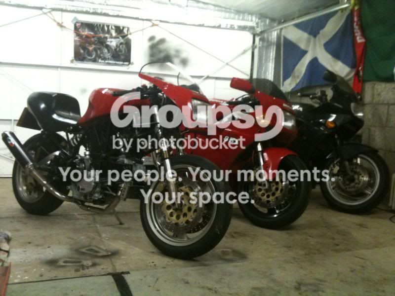

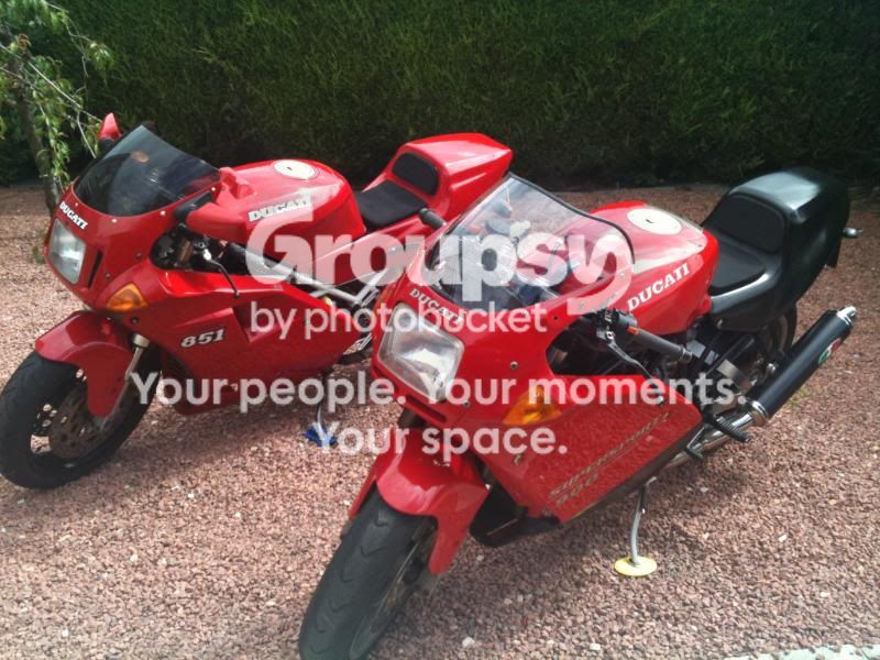

Not quite a D16rr and 1198r,but I luv them :thumbs:
Cracking bike & photos.:D
Bet you are proud as punch :Dwith the bike after all that effort over the winter.
