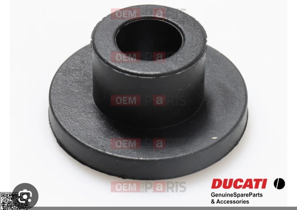

"When I bought the bike, the screw was broken off inside and the rubber grommet was snapped. I ordered the new screw and grommet, but they don't seem to fit...
I don't understand how it was originally set up; if you look closely, there are still remains of the old grommet in the screw hole.
Could someone take a photo of their own bike so I can understand how it's supposed to be mounted? Thanks!"

i can't figure out if the previous owner mounted it wrong or did some DIY fix.
the diagram shows no washer and one grommet, my grommet thus seems mounted backwards according to the diagram.
ALSO, when i got the bike, the screw was just lying inside broken, and there was another grommet just like on the right side. (there are 2, one on each side, on the right side)
i bought another one thinking it would replace it but the one that broke off was different, trying to figure out if it was some DIY BS or i'm missing something. bc according to diagram the left side has only one, not 2 like on the right side as it was when i got the bike.
if anyone still has the OEM setup, pics would help a lot.

They’re different parts.
You need 2 of this type on the RH side, one pushed into the frame hole from each side.
And one of these on the LH side which is pushed into the frame hole from the front.
Edit : I thought the part numbers were on the photo. The top photo is 76410571A, the lower photo is 76410581A
