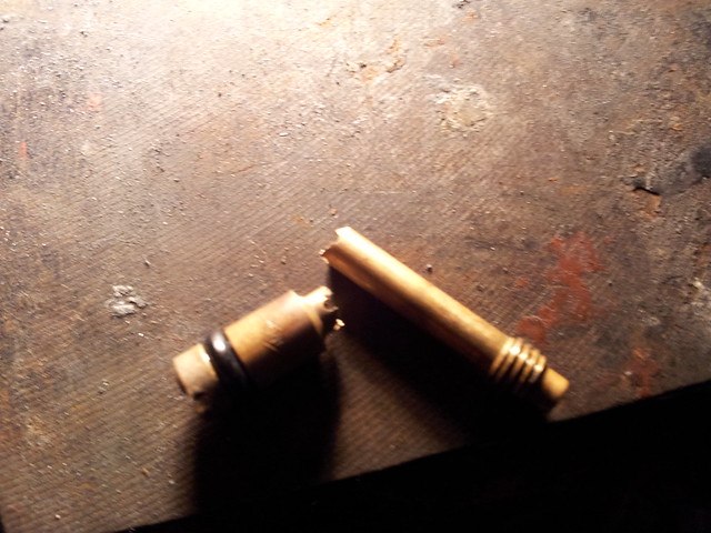

carb is back from the cleaning tank so time to order up some bits... checked the jetting whilst i had it in bits... stock for early Darmah/late 860 apart from the rear pilot being 62 and a 60 in the front.. big difference is with the mains as it has 145 vs standard 122... :eek: i guess its been made richer to account for the contis and no air filters... i'll put it back as i found it for now and see how it runs (ever the optimist!) ..
yep one on order :) it was pretty tight comming out so so maybe had a hairline crack as it had only just seated when it snapped... the one in the other carb looked almost new so not an uncommon thing i guess :)
