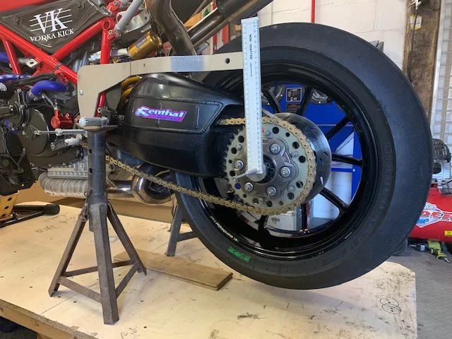

1 is the measurement of full travel of the shock and forks. You can also increase and decrease this on most ducatis with the ride height adjuster ( a common fault is where people measure the tie rod length or measure the ride height with weight on the springs!) This is where the ducati ride height datum tool gives good consistency, but you could also do this to a fixed point on the seat or subframe, ideally directly above the rear axle centre. As long as you use the same points for all three measurements you will get your numbers.

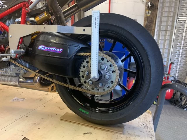

2 is the weight of the bike alone acting on the springs

This is how it worked out on my bike. Given my gentle weight and the type of RS flat/linear suspension rocker and length of S/arm i was using i already knew my rear spring needed to be around 105/110
So a 110 was fitted to my ttxGP shock.
So measurement 1
Weight off the rear spring, tyre clear of the floor. This is also where I can set the rear ride height adjusting the tie rod in this instance to 245mm.
Next bike down on the ground under its own weight. This is the point you see suspension gurus lift the rear lightly and press it down lightly They are looking to eliminate Stiction where a light drag on the moving parts either way can affect the measurements. To be really accurate you can take both upper and lower number add and divide to get the average.

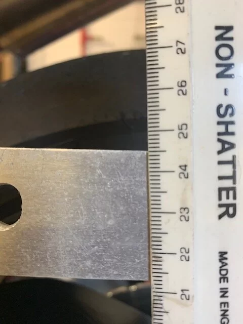

So my free sag, the weight of the bike compressing the spring. Down to 234 giving me 11mm of free sag.
Now to rider and bike or static sag, so with me on the bike (ideally in normal sitting position fully kitted) it's down to 214mm.
So to recap the numbers
ride height 245
free sag 234
rider and bike static 214
that gives me 11mm of free sag and a total of 31 static sag.
these are good number for my weight and set up the free sag means I'm not the second kid on the trampoline every time it goes over a bump and the static sag is correct meaning the spring is the right rate for this set up.
