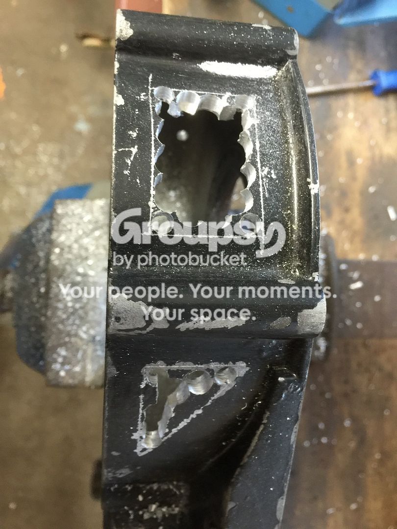

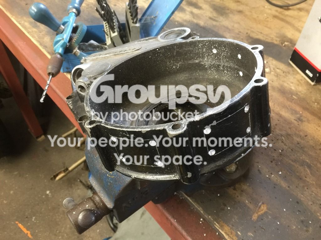

Yesterday was another learning day, hand tools hurt. I did a little bit of fettling for the Cafe Racer project, I made a Corse style clutch case using a hand drill and various files.
Marked up:
Drilled out:
Filed down and finished:
All ready for powder-coating. I just need to decide what the next one will look like.

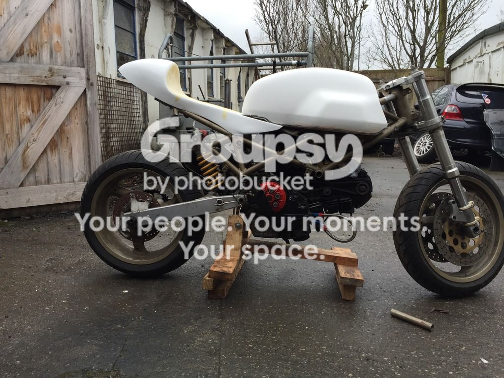

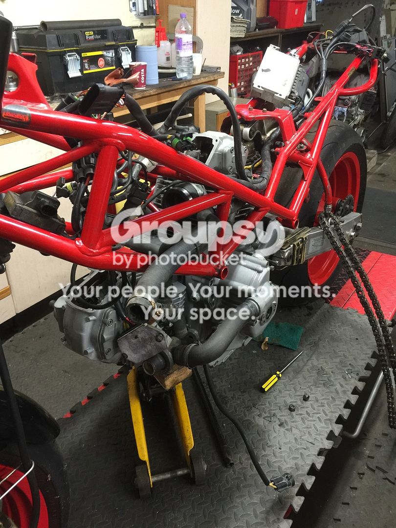

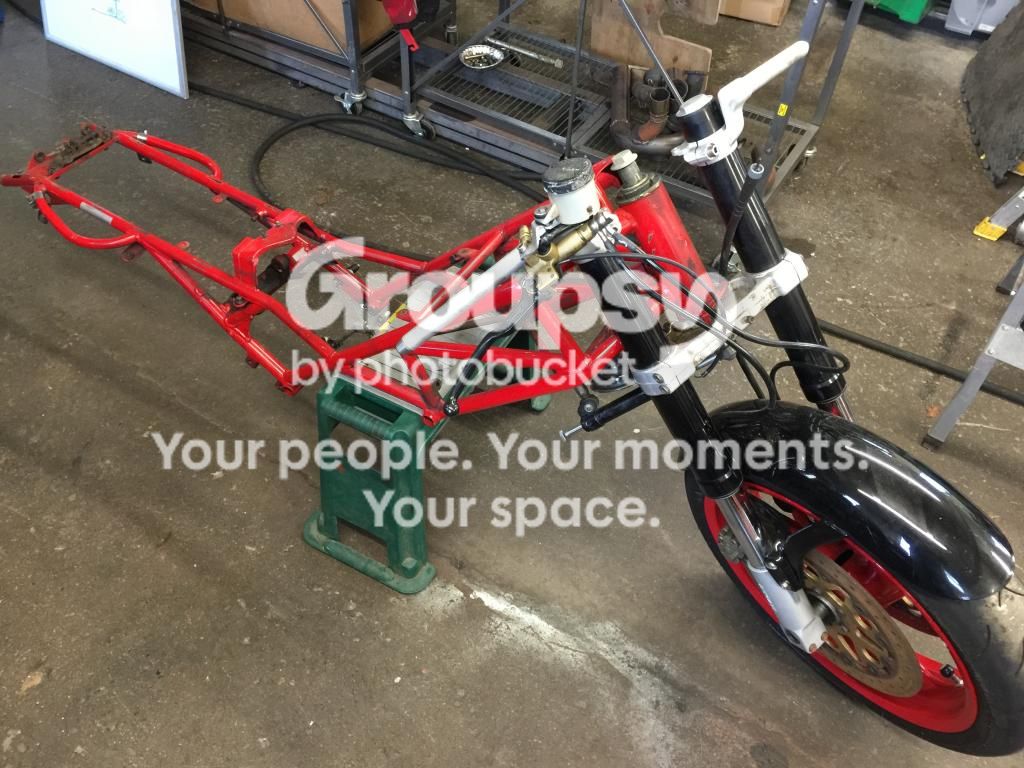

Nearly 6 months since I played with this project, that's the drama with doing two projects at once.
So with the Monster waiting for an oil scraper ring or a Hi-comp piston replacement for the ST2 engine I decided to crack on with this for a bit.

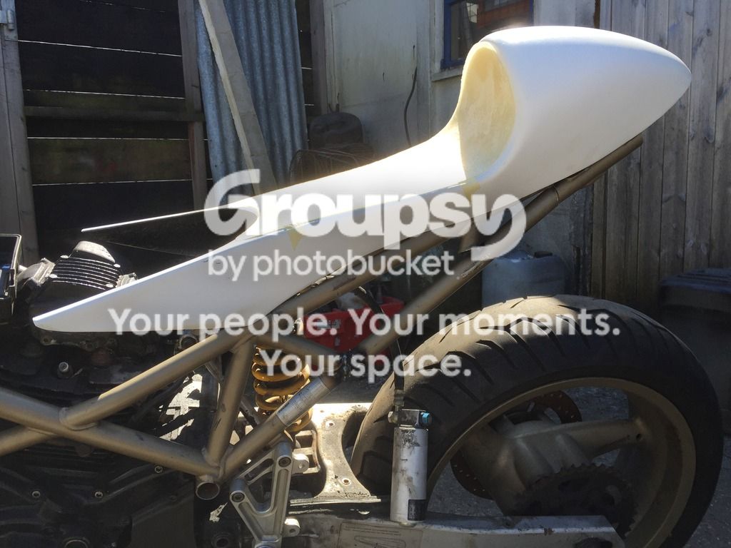

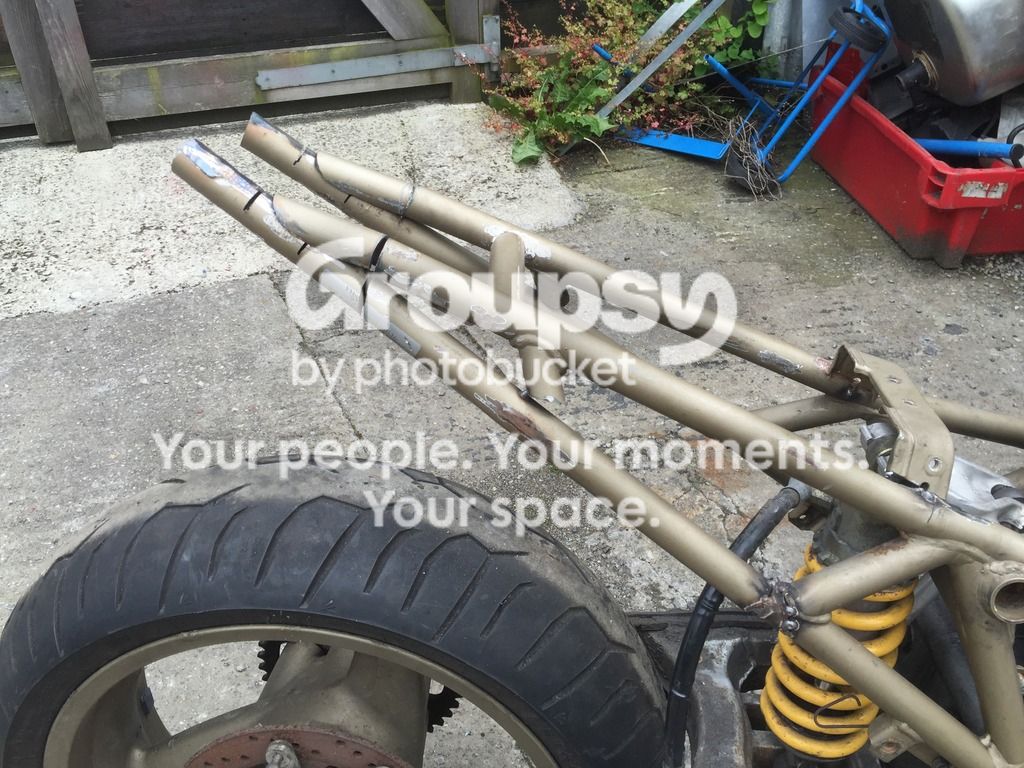

This is the end result that I want for the rear end, so a bit more cutting and shaping was needed:

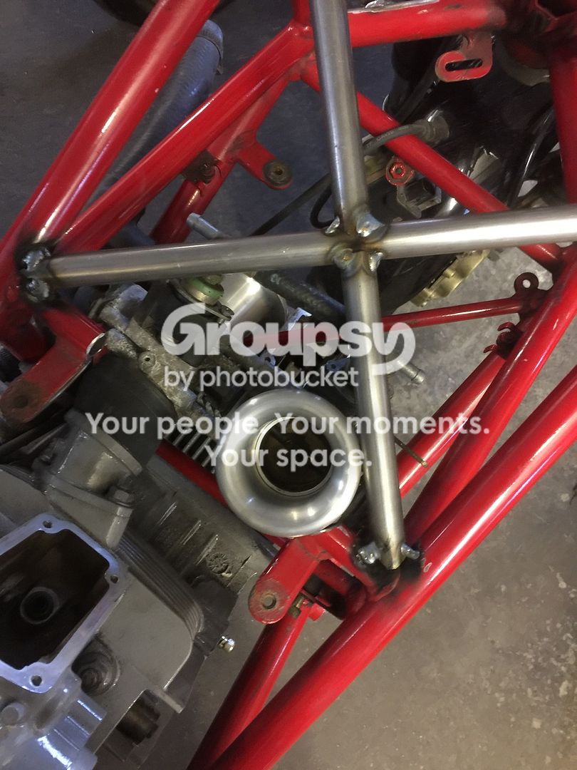

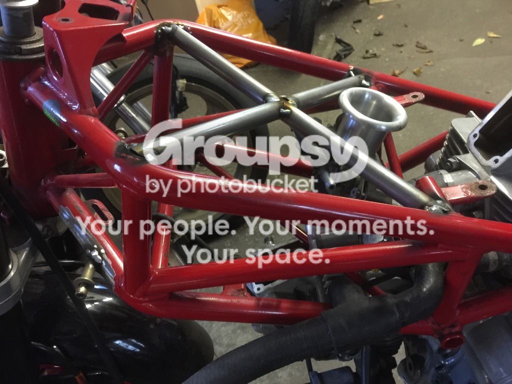

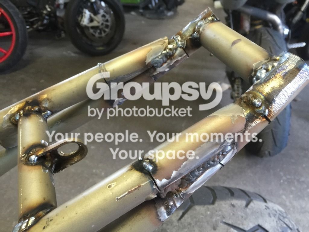

I cut the frame at the rear some more and made some shaped pieces to finish off where the frames meet:

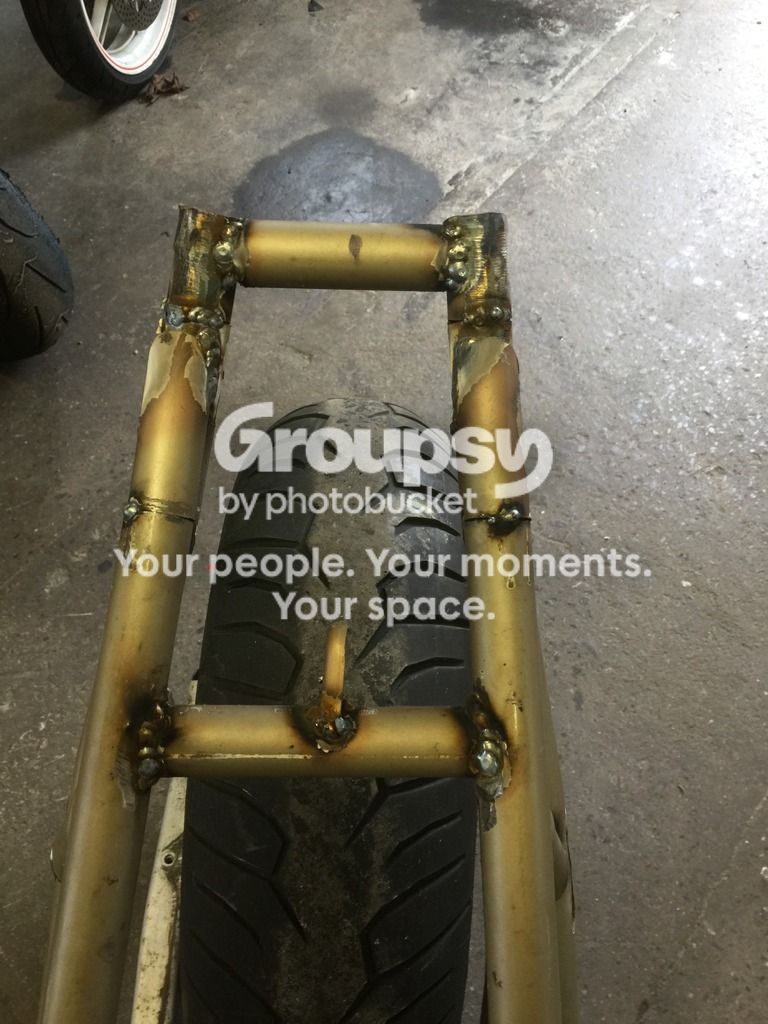

Rear frame brace shaped and test fitted:
It looks a little like Frankenstein's Monster but it will be tidied up once it is properly welded :

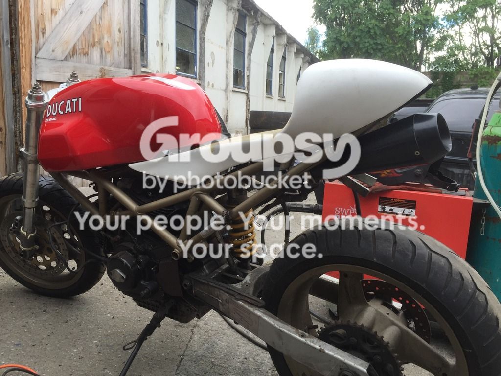

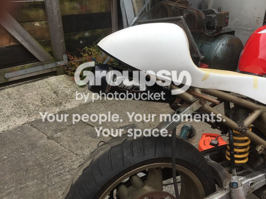

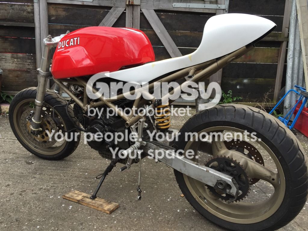

With the exhaust mount in place:

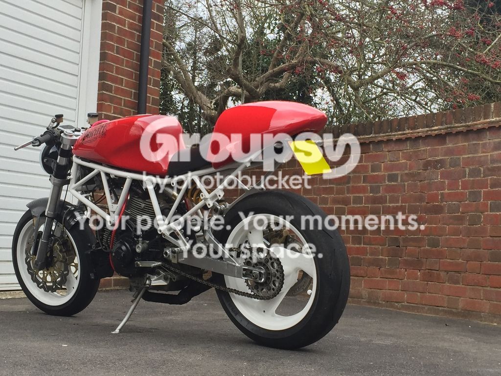

With the bodywork fitted it looks okay:
It really is coming together....
