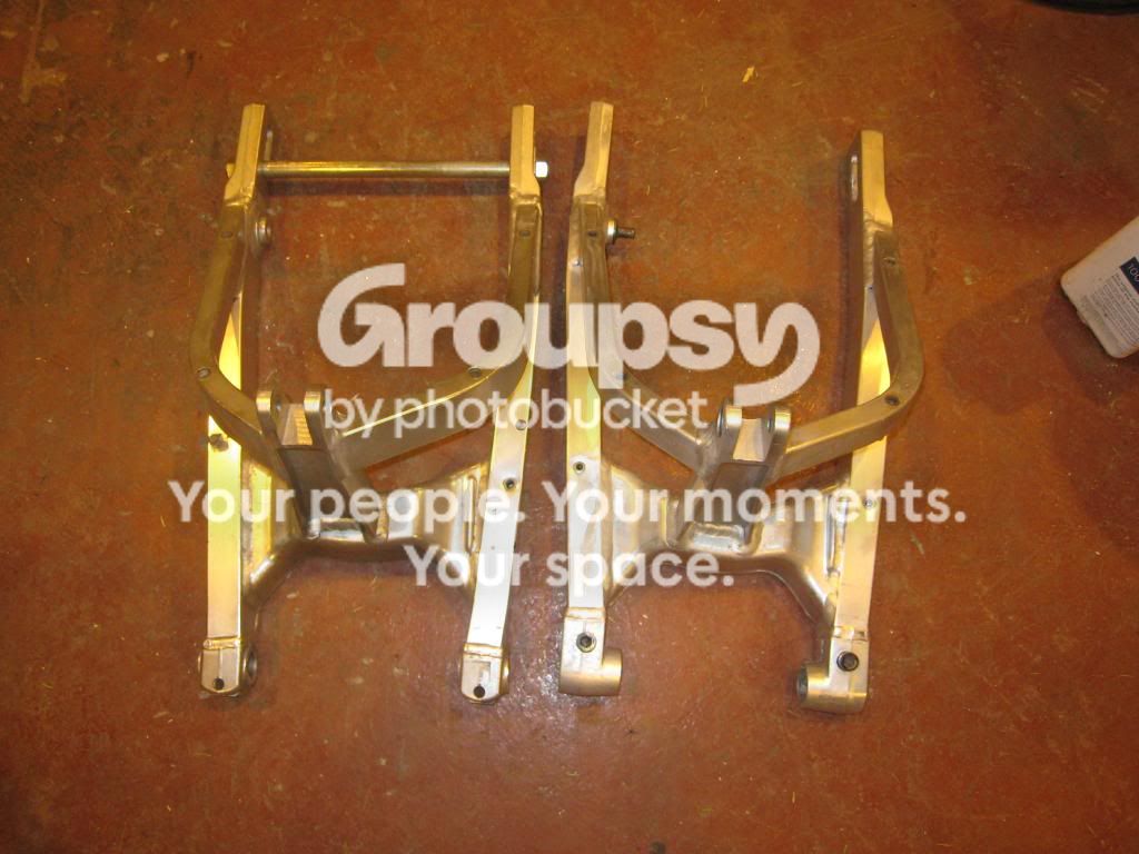

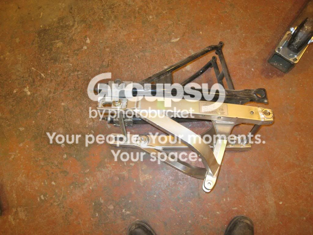

so i neede a swinging arm , and the Original alloy one looks too modern to me and is a route too easy (two wheel classics use this )
so i dug out a pantah swinging arm , cut it in half and widdened it
i first made a jig to locate the 2 halves , turned up the spacers for the rear wheel (bevel-style) ,turned spacers for the engine-swingarm spindle and clanped everything up so it would not move during welding
you need to turn spacers for the engine-swingarm spindle as the pantah spindle is narrower and thickerView attachment 10191
as one can see i cut the arm in the middle but cut the gusset back an inch or more because i did not want all welding to be done in one line
the spacer wich sits between the 2 halves is spigotted in both halves
i next added the gusset

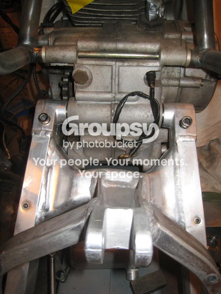

next i bent two tubes over 35 degrees and welded them to the swingarm ,MIG
View attachment 10193View attachment 10194
you can see the mounting point for the shock is to the left and in line with the small tube forming the connection for both arms forming the cantilever
i saw this way of fixing the shock on a bike built by Tony Foales and liked the idea
perhaps a little more complex than welding 2 tabs on but i liked it
the shock is made to measure so i could make it as short as i wanted to (or at least that is what i thought , wrongly)
