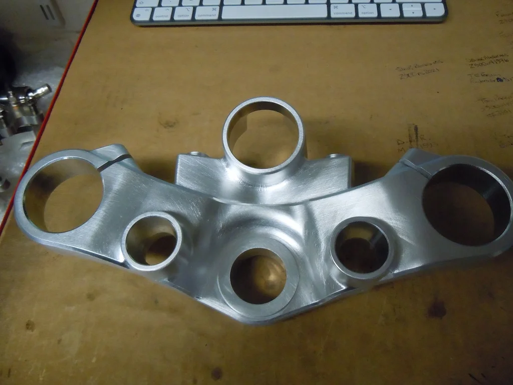

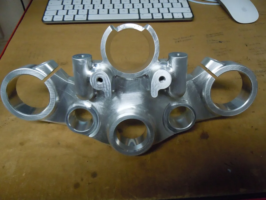

And here's the top yoke, just needs vapour blasting now & then anodising.

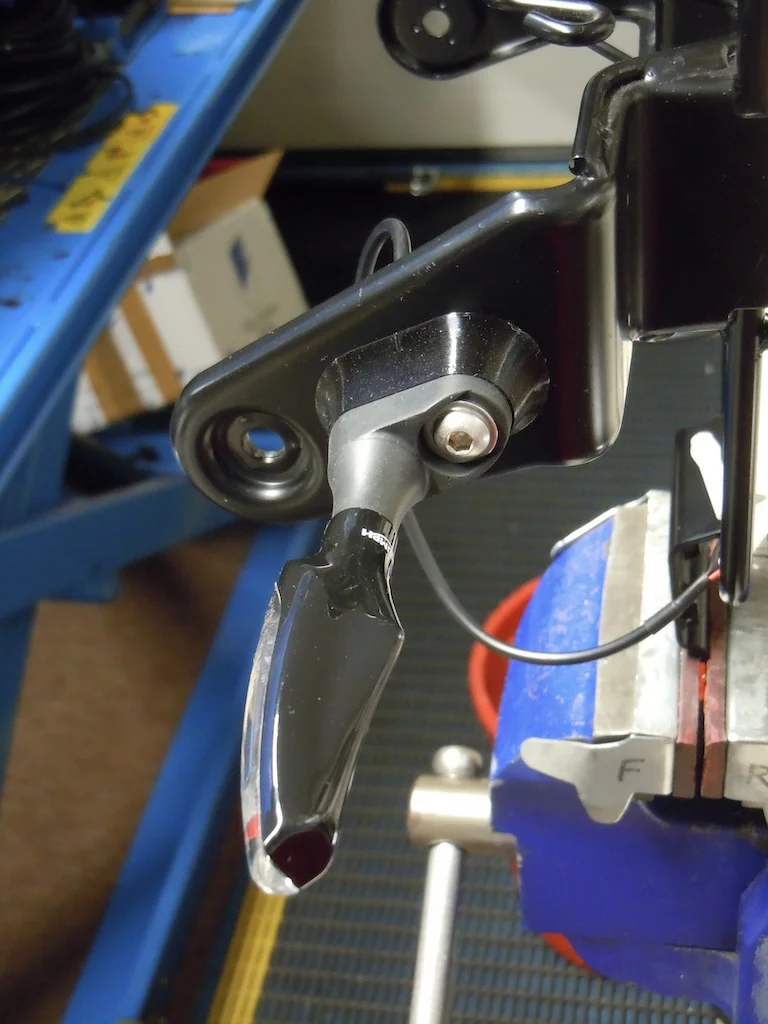

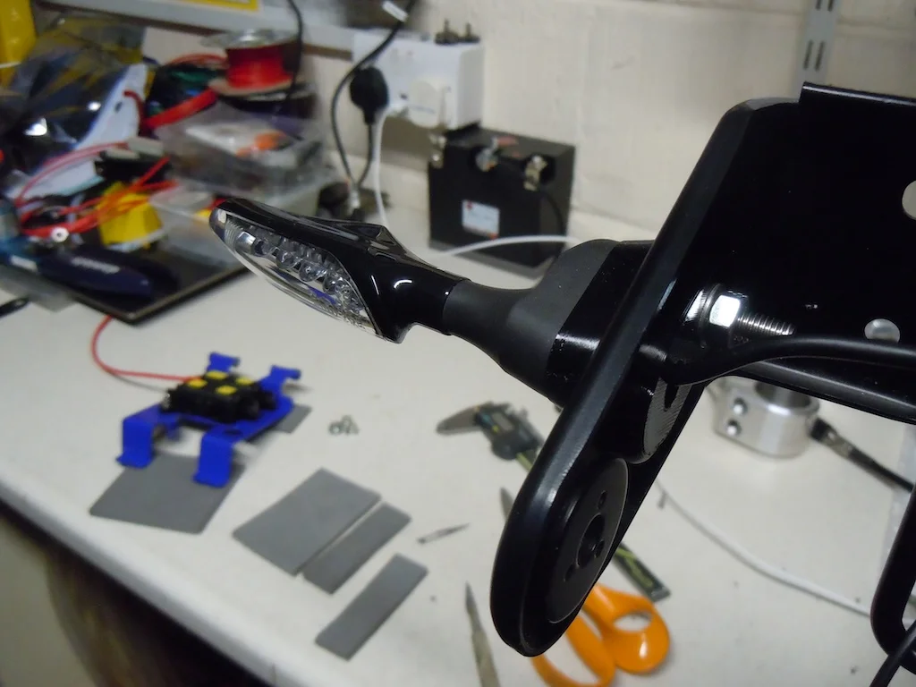

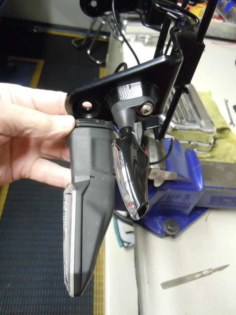

While I'm messing around with the front fork swop I'd decided that I didn't really like the standard Kawasaki LED indicators the RS's come with. Some years ago I'd bought some later model Triumph LED indicators to replace the earlier Triumph "normal" indicators fitted to my Daytona 955i, ( a job I still haven't got round to doing !!). Anyway, I got a guy to 3D print me some adaptors to mount the Triumph indicators in place of the Kawasaki ones. The only trouble is now I'll have to do the same for the rear indicators, so they all match & buy four more for the Daytona !! :ROFLMAO:
I think they look much than the Kawasaki offerings.

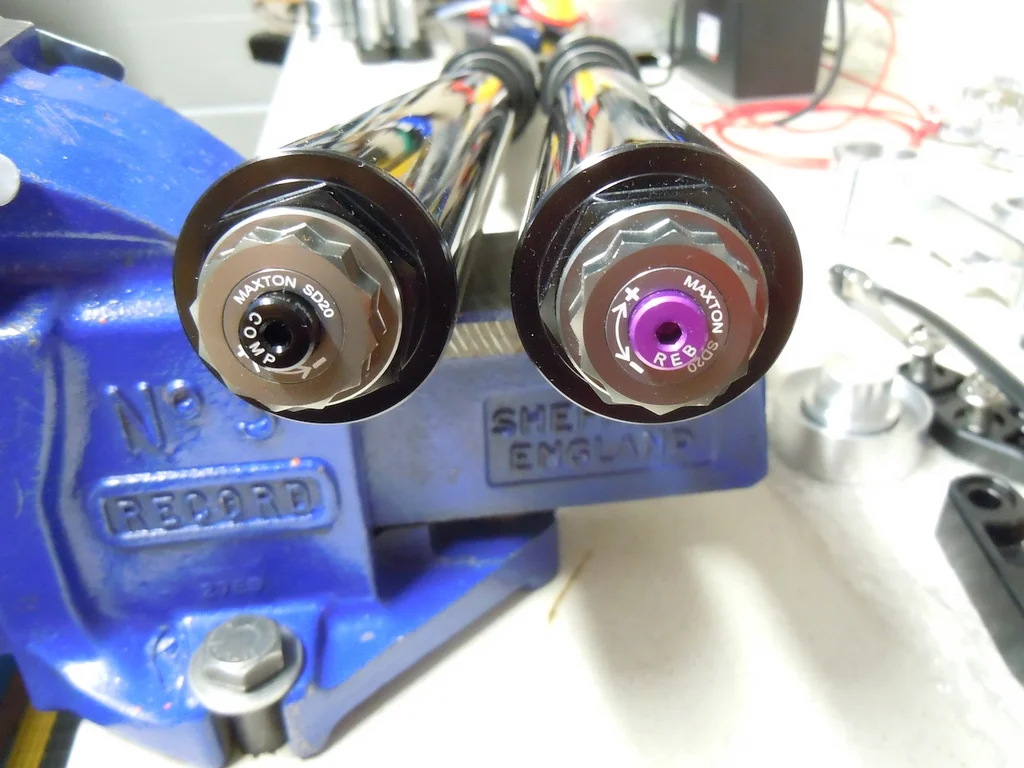

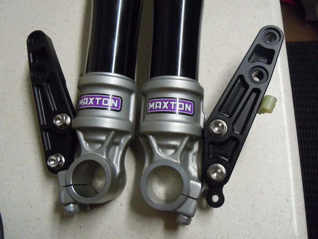

A quick glance & the forks don't really look that much different. Both have adjustable pre-load & the left leg has the compression adjustment while the right leg does the rebound adjustment.

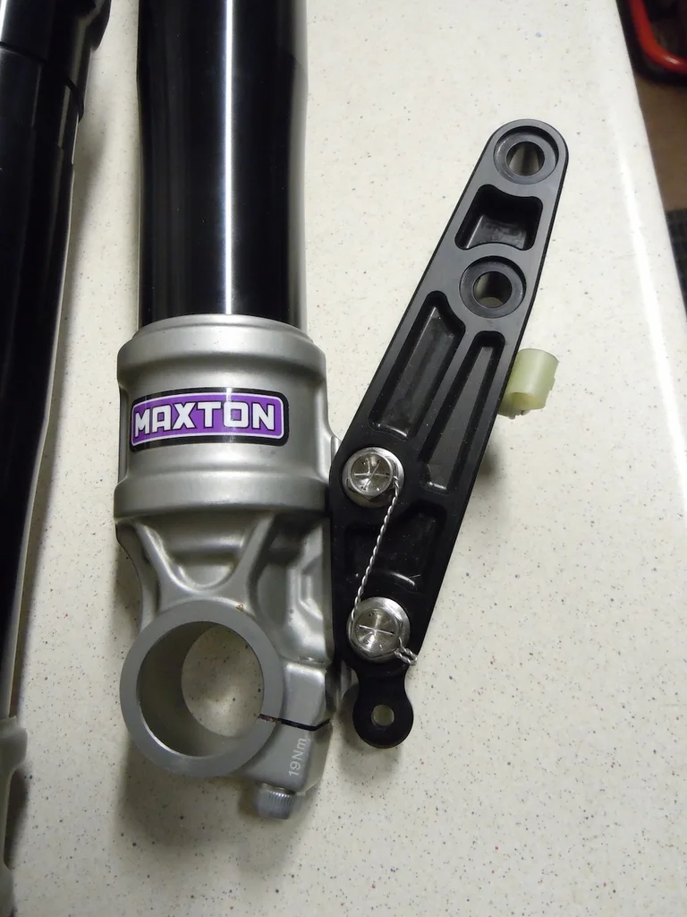

Fork bottoms with the new, anodised caliper carriers.
Fork tops, can't beat a bit of anodised purple !!

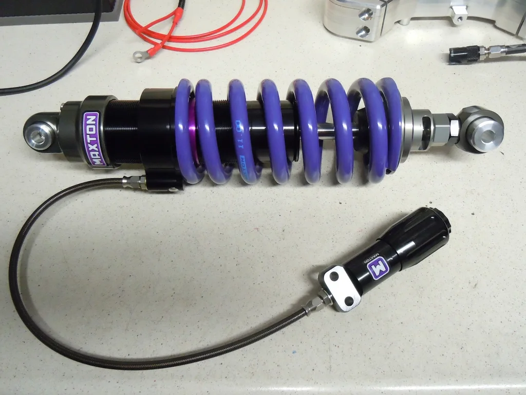

And the NR4 rear unit with remote spring pre-load adjuster. I could have gone the whole hog & gone for a GP10 rear unit, but positioning the piggy-back reservoir would have been problematic due to space/clearance. I'm sure this "lesser" unit will be more than adequate for my abilities !! :ROFLMAO:
The unit also comes with a suitable mounting bracket, spacer & machined cap-head screws to mount the adjuster using the right-hand passenger footpeg mount.

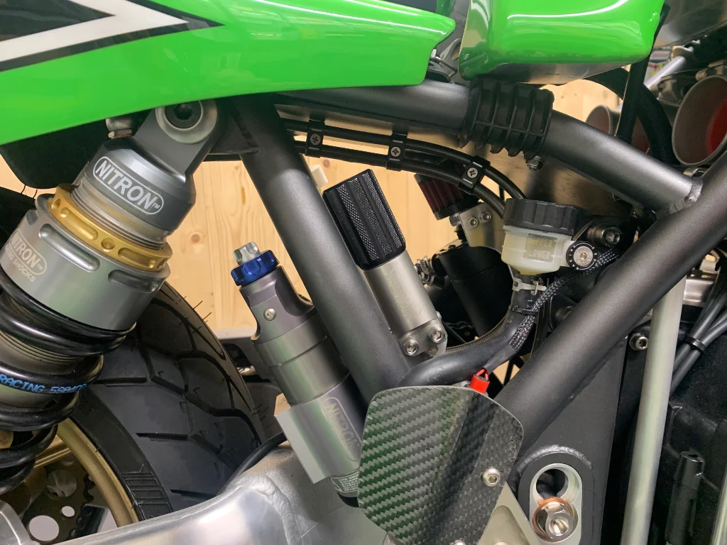

I know hyperpro offer both Purple and black springs for bikes, as do Nitron with their light blue or black
The spring on my KR’s Nitron (a bike I finished building years ago btw) has a black spring, specced by my local Ohlins official dealer and made to his spec using my geometry measurements 🙂 - I told him I wanted black but it does have some jaunty blue writing on it 👀 its still got an anodised blue adjuster on one of the the remote adjusters though 😡

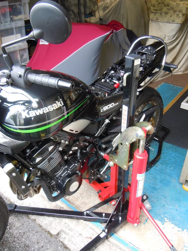

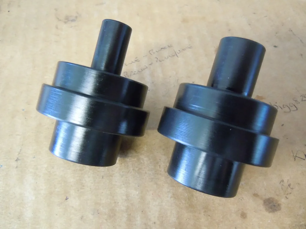

Made a couple of adaptors today out of plastic so I can use my SkyLift to lift the RS up to change the rear shock. They plug into the swingarm pivots & being plastic they shouldn't scratch the frame paint.
These SkyLifts are really so, so useful & I got it cheap off some old bloke, somewhere in the York area, (I think he'd bought it for a project that he never finished) :ROFLMAO:

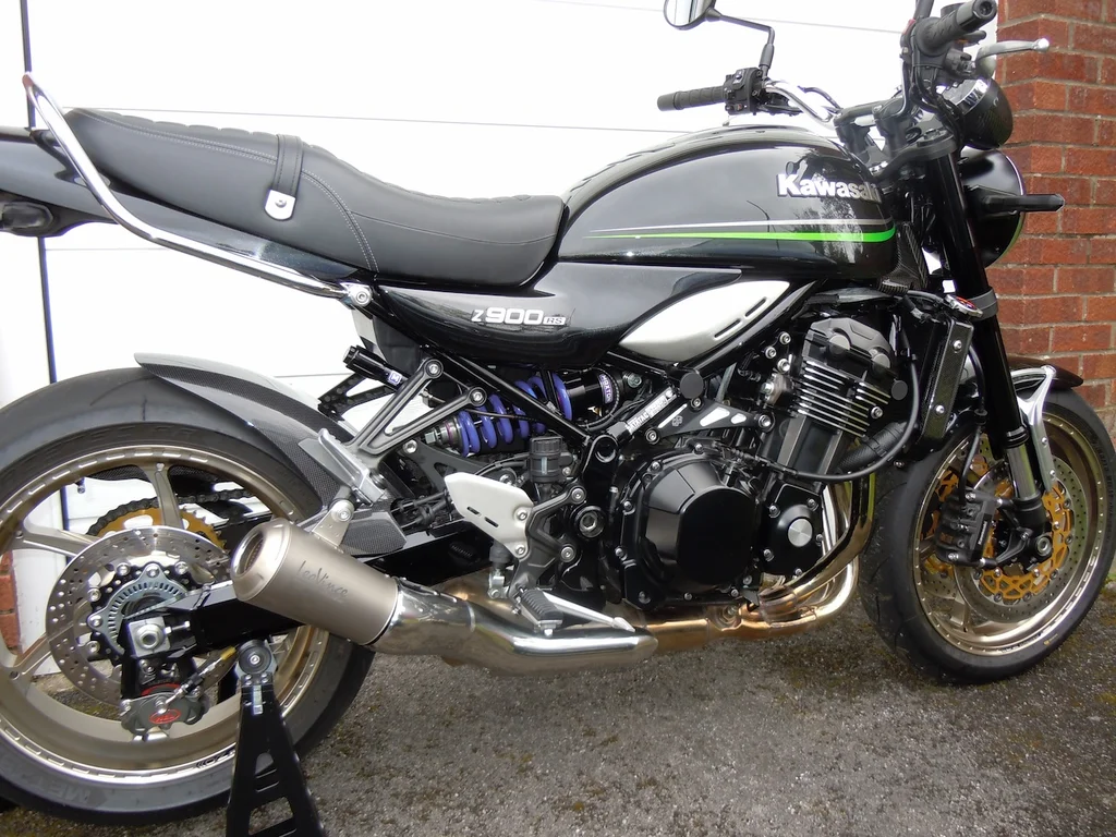

This is the bike as it currently stands,
I did consider having the green strip on the tank changed to PURPLE, but I think it's just too much work when it looks OK to me as it is :love:

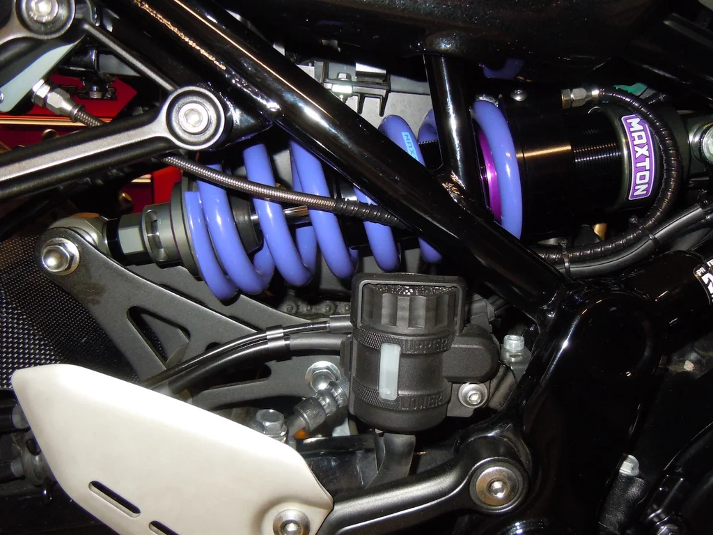

I've noticed today, as I was messing about with the pre-load adjuster, the more you wind the pre-load up the more PURPLE you see on the shock body as the anodised PURPLE sleeve comes more into view !! :ROFLMAO::devilish:
