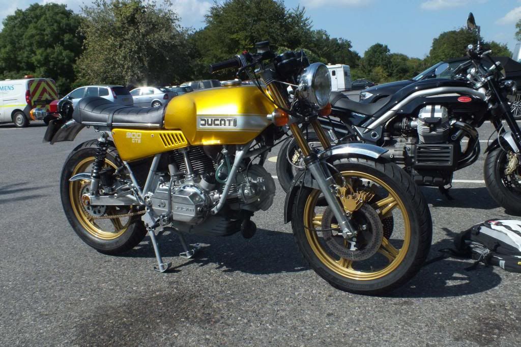

On the way home after the MOT...
Full marks at the MOT, brakes all excellent and everything was working.
However, the old girl had one trick up her sleeve, a nice bit of embarrassment when I left. She took and hour of my time before she condescended to start. I was knackered. I am knackered. My back hurts! I may have felt clever when I shaved the pounds by dumping the electric start but I promise you I wasn't feeling clever today.
I hadn't realised one of the side effects of changing the primary gearing which is the engine is harder to turn over, add to that a larger capacity and increased compression ratio and you potentially have starting nightmares. At least one Yamaha Bulldog owner had a good laugh.
Anyway, after that capricious, enigmatic and idiosyncratic shaming I was in no doubt of the gender of the soul of the bike.
Here she is on the way home, parked next to a friendly V twin. Note how she is dwarfed by the Guzzi!...

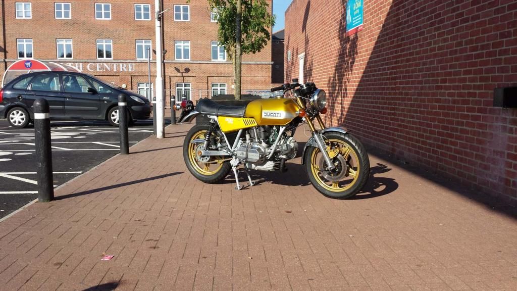

So here is my usual Tesco's shopping run picky...
The paintwork is so shiny it bleached out my phone camera ;)
Apart from being slightly intimidating to start (and it is getting better) it is oil tight which for me is a revelation. It has absolutely fantastic brakes with loads of feel; It is nimble, light and fun to ride and if I could liken it to anything, the motor feels like a 900 Monster motor. I say this because it feels like an 1100 Monster I rode, but with a little less Ooomph - although I am running in.

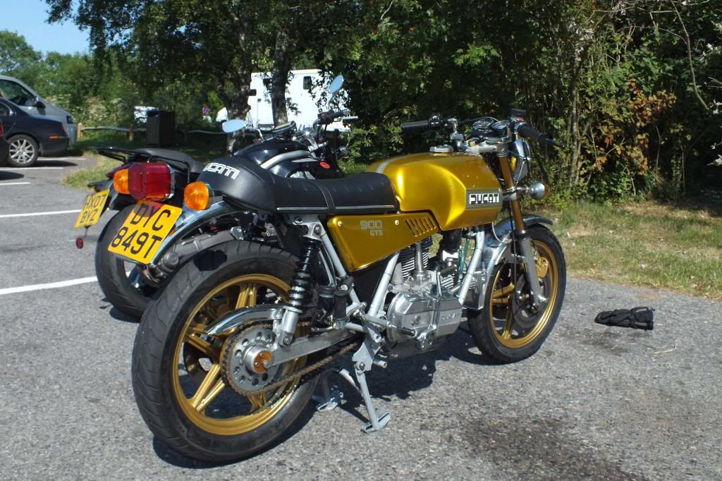

I took it to Box Hill yesterday, a popular bike meet down south. I went with a neighbour on his rather tasty 750 Lavatory and his wife on her very nice 350 Morini. The the best thing to turn up was a really neat thumpin' great Boss Hog, folowed by a small swarm of supporting acolyte Harley's. Oh yes! One of the new Indians - and I forgot to take photos. I adjusted the carbs there and was lent tools by a very nice Harley Road King rider, so thank you Mr Anonymous Road King rider.
All in all, it is looking very promising. Now fully taxed & road legal, done about 150 miles or so, I can't really tell

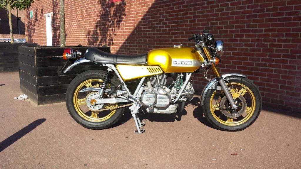

Fragile...
Weird thing is, I remember GTS's being heavy looking, thickset, sturdy but it looks lightweight & birdlike - what has changed? Derek's looks similarly nimble.

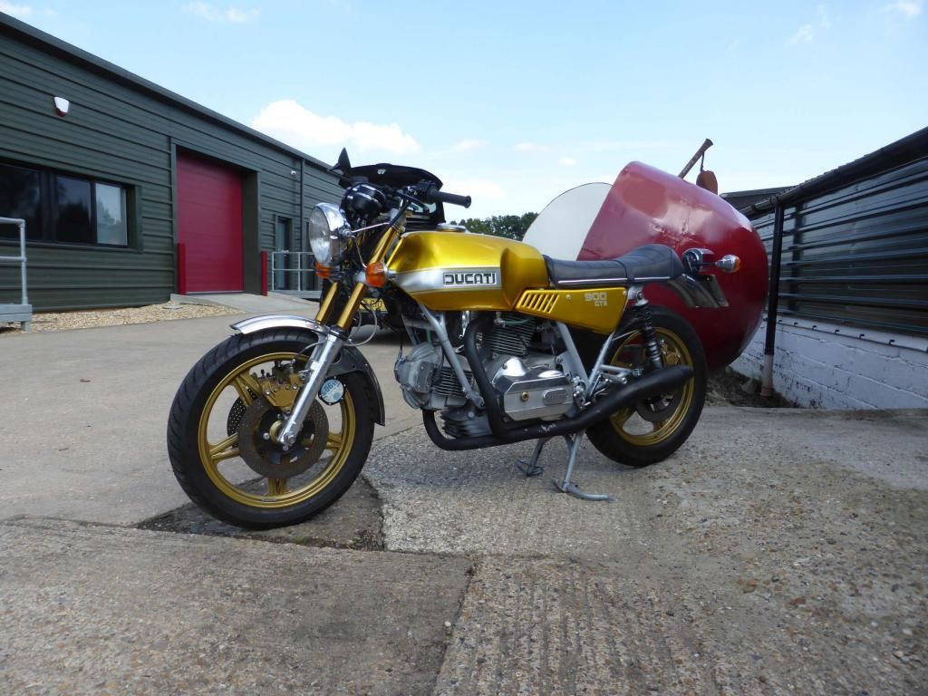

Mirrors - black or chrome?
Since the above pictures, I have affixed an ancient black mirror which is functional but really quite nasty. Thirty years have not been kind to it.
For me, at least one mirror is an absolute necessity, preferably two. I hate not being able to see what is behind me.
Because of the style of the bike I can get away with either black or chrome - this is the era of the matt black adorned Mk 1 & 2 Le Mans, although Ducati went mainly stainless/chrome.
Possibilities include these Ducati belt drive GTS style chrome items or possibly modern Monster items like these.
Visibility is important, whilst I am a fashion victim, I'd like to stay alive and retain my licence.
What do you think?

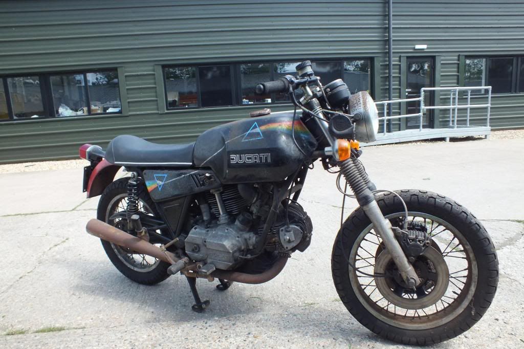

Took the head of the front of my latest project today :)
Only question is......should i change the rings ?
Hmmm. That'll need more than a bucket of water throwing over it Paddy.
Takes me back to when I was examining my spare (original) engine which I used the crankcases from. You don't need to be Sherlock Holmes to work out what catastrophe happened here!
