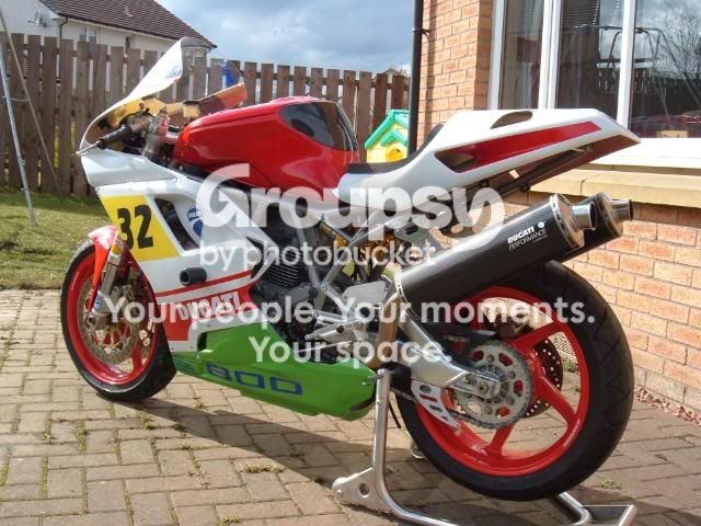

Here are some pics.
Love the bike already G. i'm glad you went for a japanese twin,
and by the way, those sunloungers are putting all the wheelie bins to shame , atb :)
Great looking bike Anteater!!
