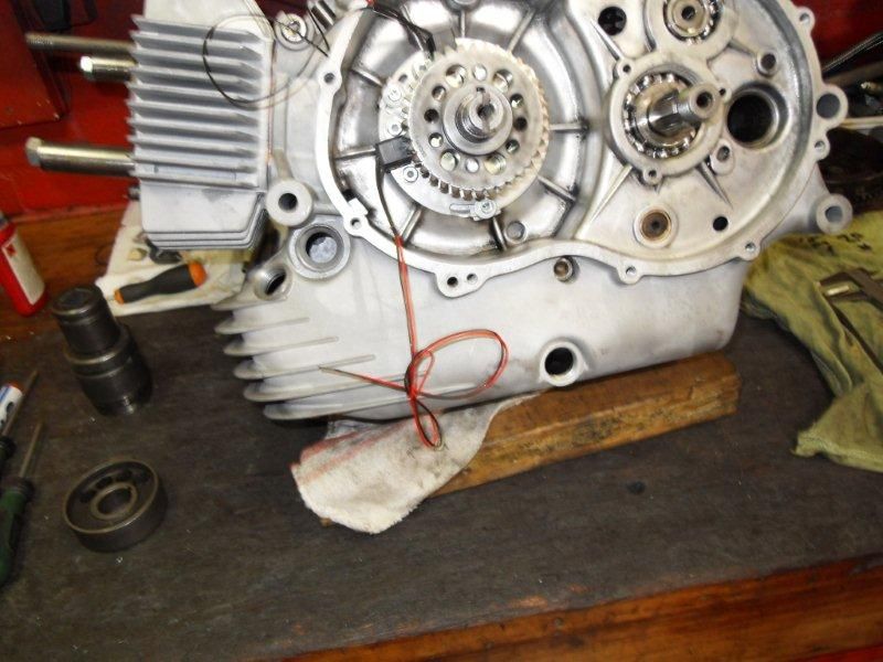

Going back to the Sachse website it does look like there's the option of both kickstart and electric start, which is great news if confirmed. I completely missed that. If Andrew has it in stock I'd better snap it up.
This is the Sachse page where it shows the system fitted on a kickstart system without the flywheel. It looks the same as the Mdina picture. But if the flywheel does fit, how the hell do you adjust the timing? It would mean taking off the flywheel. Anyway, sounds more promising. I was having nightmares about Paddy sneaking into my garage and fitting a Lucas carbuncle to my lovely polished engine....

• Andrew at Mdina confirms that he has a Sachse electronic ignition to fit with the starter ring flywheel – so this is the way I’ll go with the ignition.

On the more technical side I am now in possession of a Sachse Electronic Ignition of the correct type to retain the flywheel / starter ring. Lucky that Andrew at Mdina had one remaining in stock. Although the Czech guys I'm sure could have made a similar system much cheaper, it all seemed a bit experimental for me.
One point regarding the ignition is that the coils weren't included (the are on the Silenk Hektik) so I need to buy coils. I'm not sure what I need here. A basic 12v coil seems to be less than £20 whereas those fancy Dynacoils are nearer £100. Do I need more than the regular standard coils? It looks like they will sit nicely on the brackets vacated by the Ellectronica boxes.
