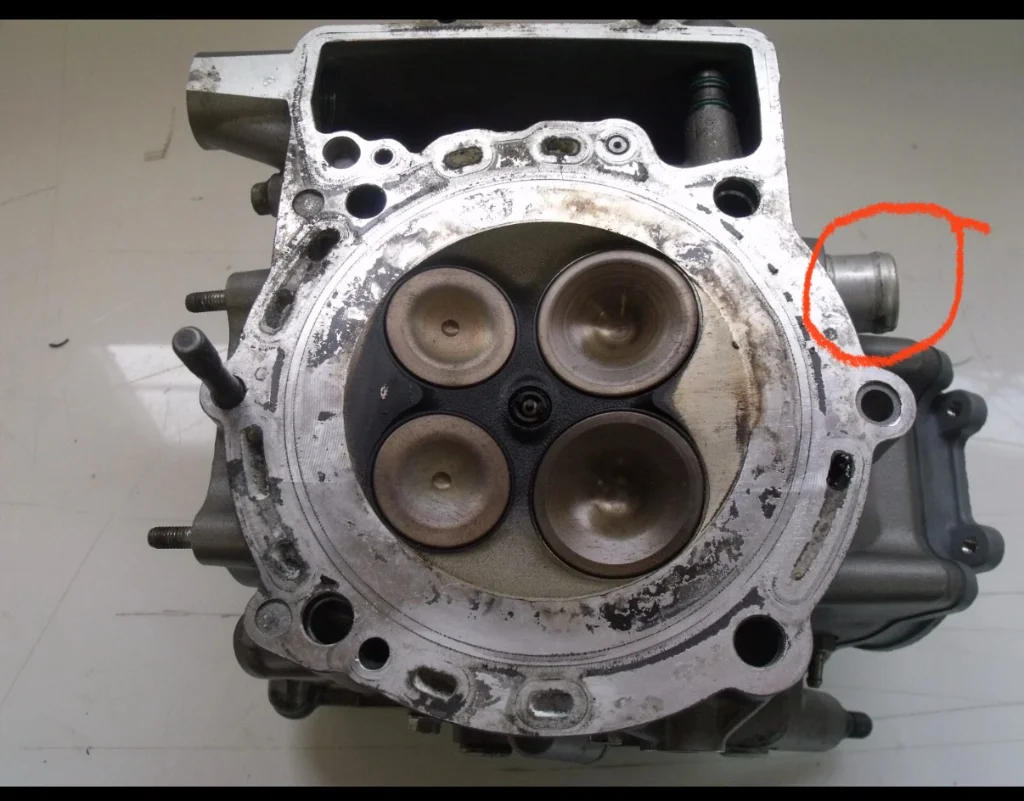

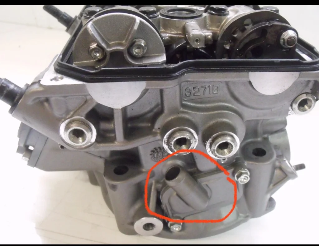

There are no coolant hoses above the head gasket level so certainly nothing above to drip down onto the spark plug hole.
The red circle areas in these photos are where coolant enters/exits the head area on the LHS and front of the cylinder head. The top of the plug chamber can be seen in the top centre of the photo. It can also be seen the head gasket area is below the electrodes of the plug.

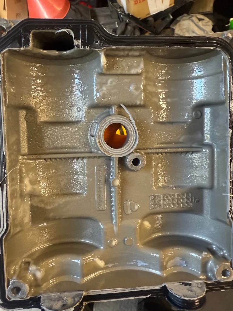

I’m going to put up a load of photos here. I took the V valve train cover off today.
As was expected it’s full of watery emulsified oil.

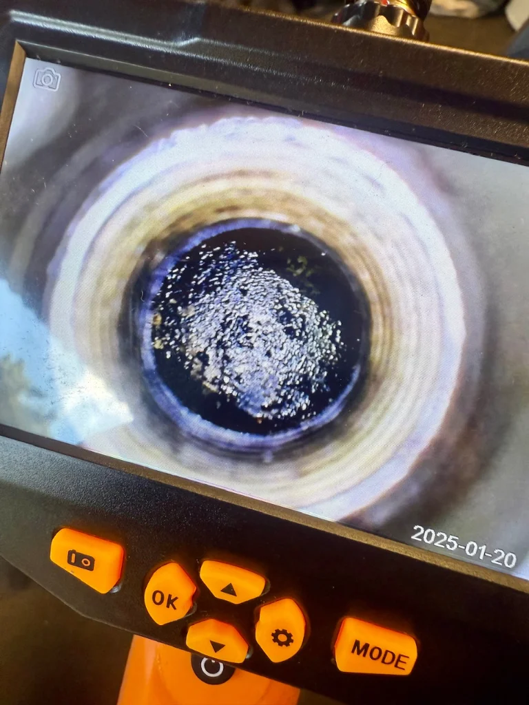

Having dried out the spark plug hole I also pulled the plug, it was soaking wet, wet with what suspiciously looked like coolant and not just wet at the electrodes but over the length of the thread too.
Inside the valve train were droplets of what looks like water 🤷🏻‍♂️
and a clear and distinct droplet of coolant.

That’s taken with the borescope down there.
Yet, the V cylinder runs 🤷🏻‍♂️. I checked the manifold temp yesterday, it’s the same as the H cylinder, about 270c.
There are no obvious and apparent cracks I can see with the borescope. I suspect the head gasket has gone hence unbuned coolant in the chamber after the engine is turned off. Clearly it’s f&&ked big time 😟.
