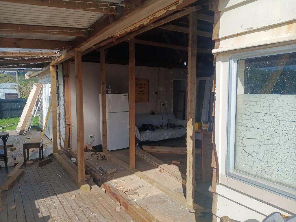

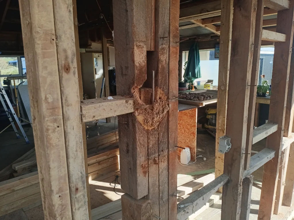

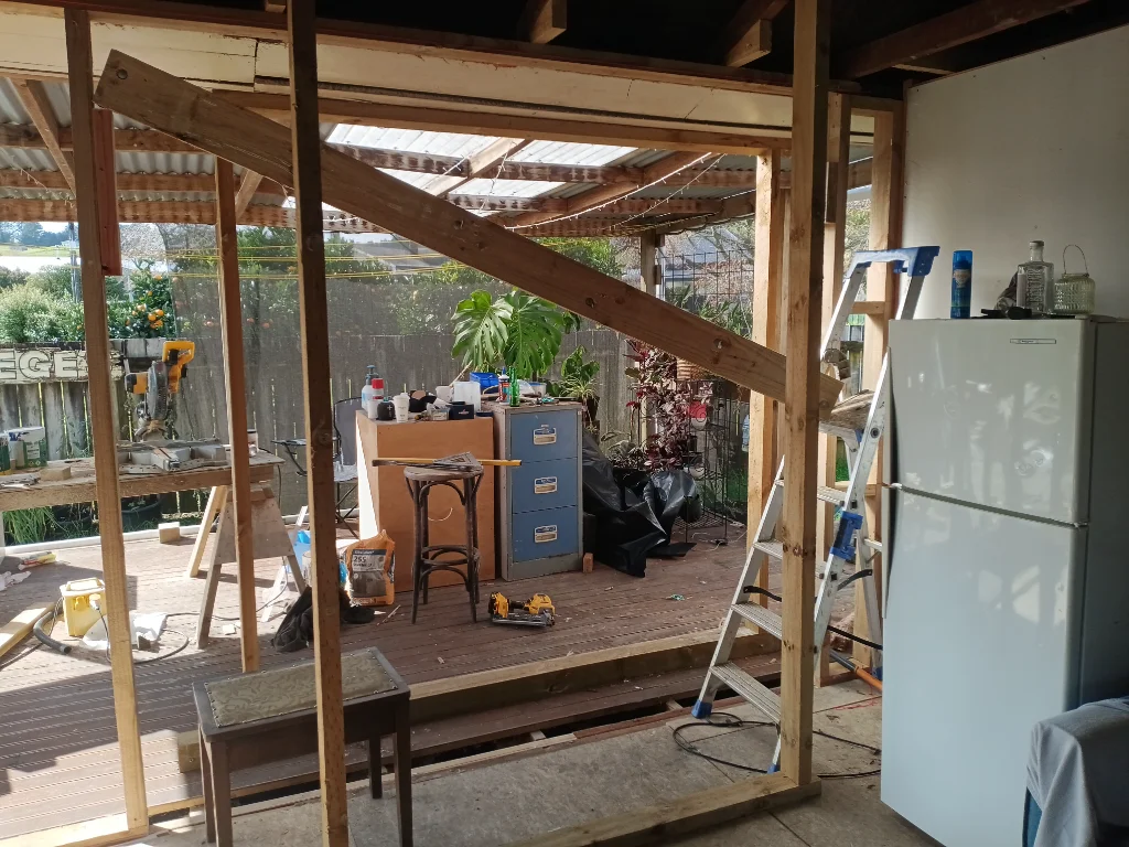

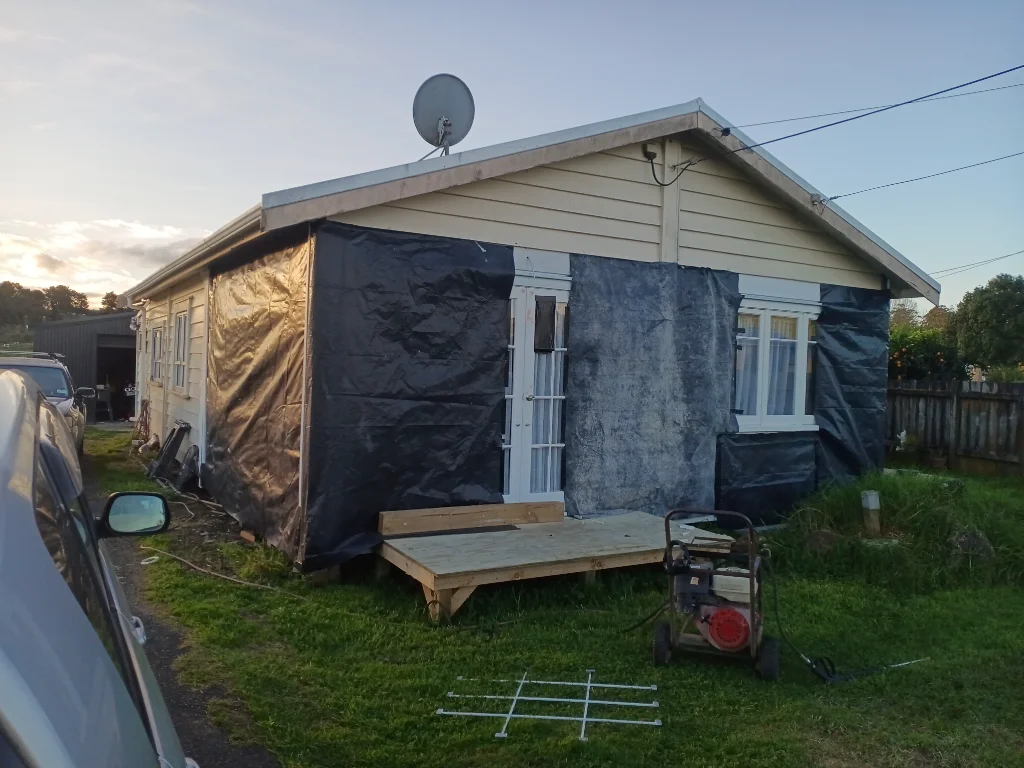

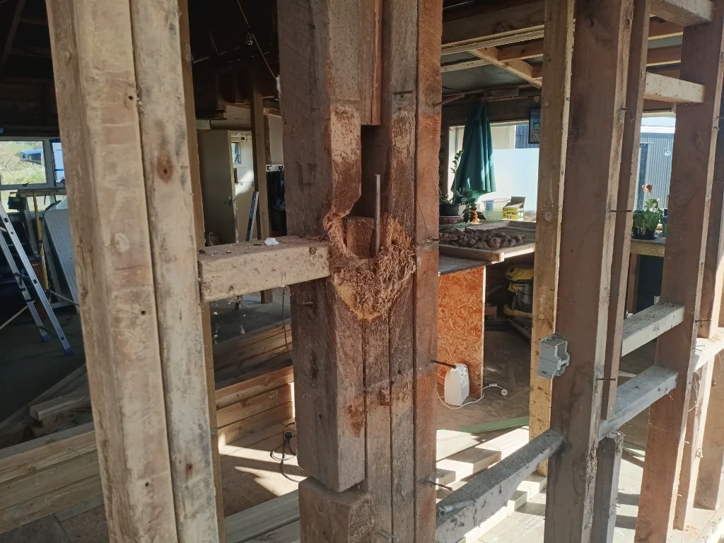

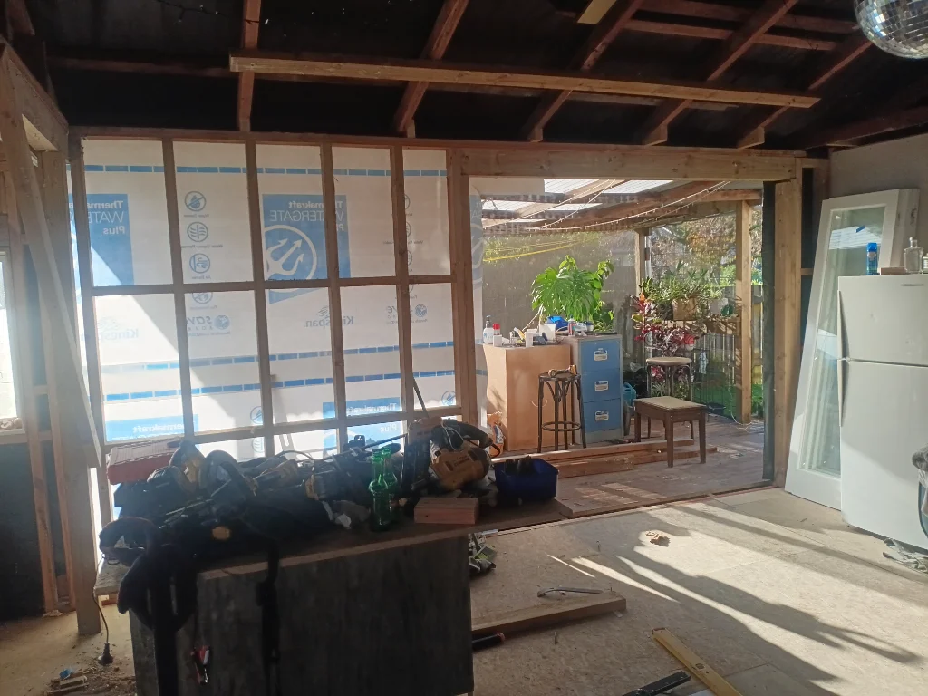

Thought i would get the bulk of it buttoned up today but as always there was a few curve balls. Bit of rot in the doublec4x2's the are onto top of the bearers on the external wall.
When doing the piles/floor it wasnt possible to see it and the internal 4x2 was fine.
So i had to chop that out, fortunately the bearer underneath was solid.
Got the top and bottom plate in and a few studs but that was it as the pub was calling.
Literally,.. the have a small job for me to do this week.
Ive tuesday and Wednesday off this week so will hopefully get the doors in and some cladding on.
An odd place/position to get rot though ! How's that happened ?
Its where the lengths of cladding meet.
Instead of the joins being staggered and metal soakers used, all the boards meet in a bottom to top vertical join and are covered by a length of timber and some scribers.
Id say at some point in the past that had been leaking and then repaired as it looked ok.

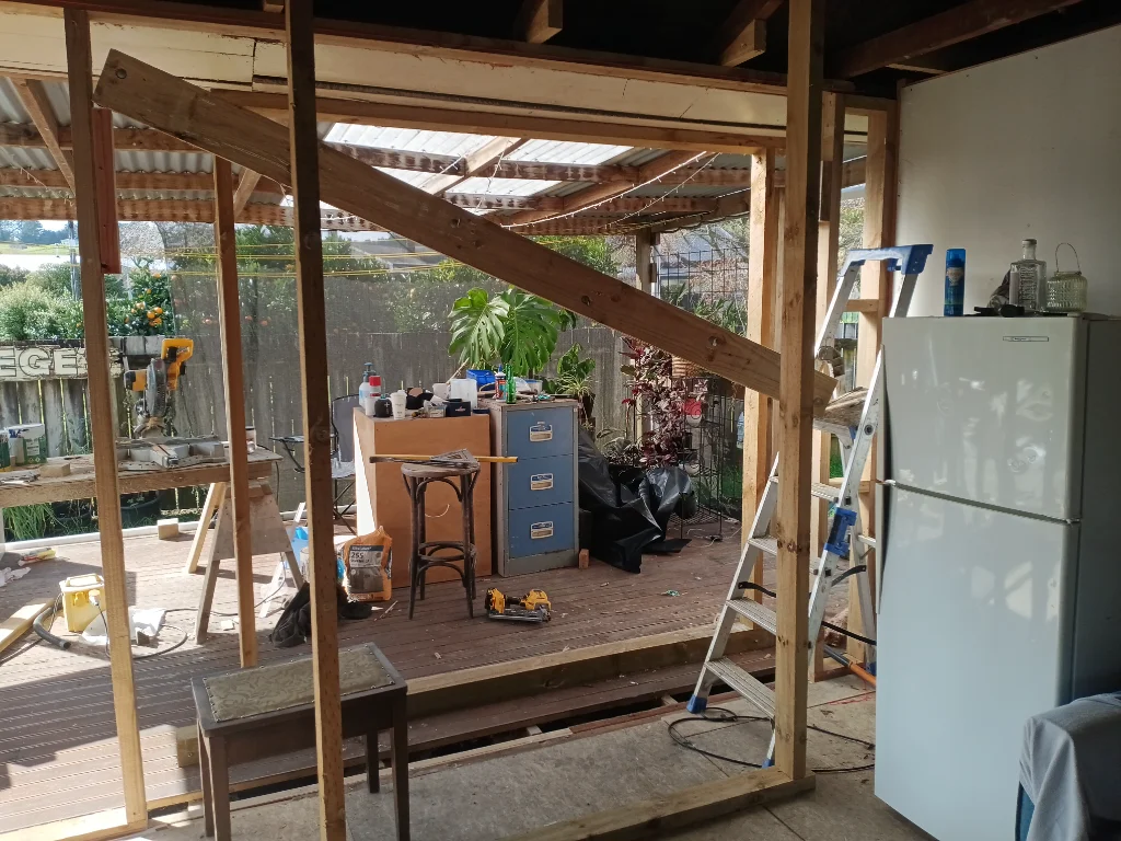

Anyhu, yesreday i carried on with the framing on the wall. Was a bit of a pain as the timber for the wall was also being used to prop the house up!
Had to mess about a bit , put what studs i had in then remove a prop, use it as a stud, remove another pro ect.. managed to turn a simple job into a bit of all day event.

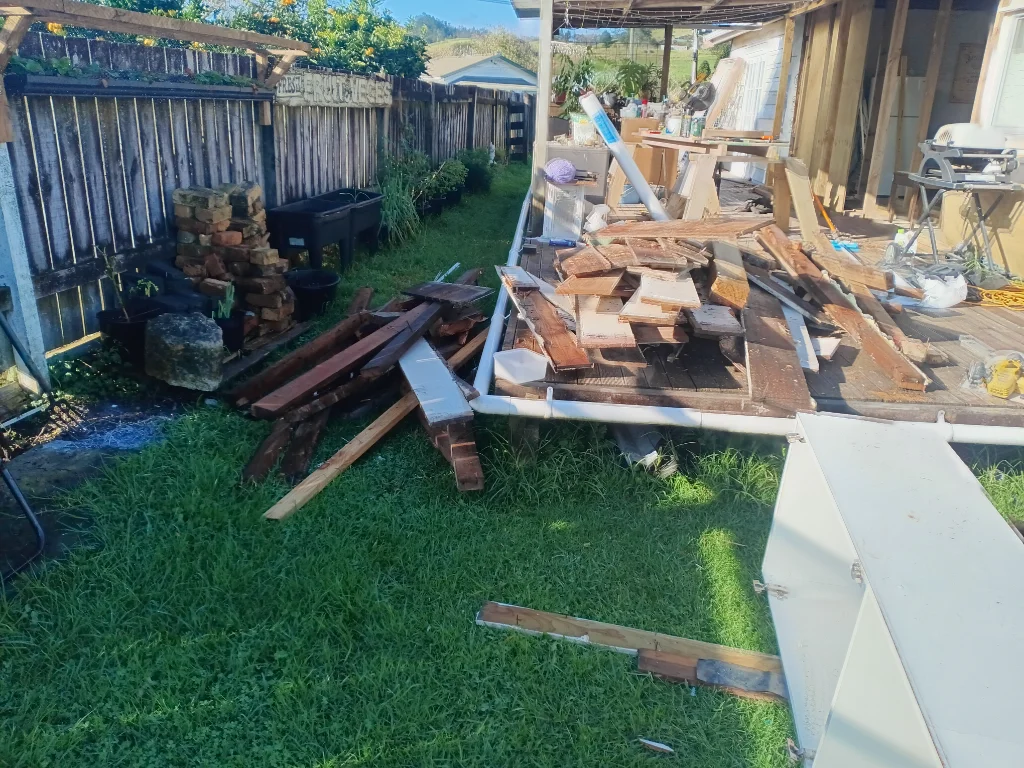

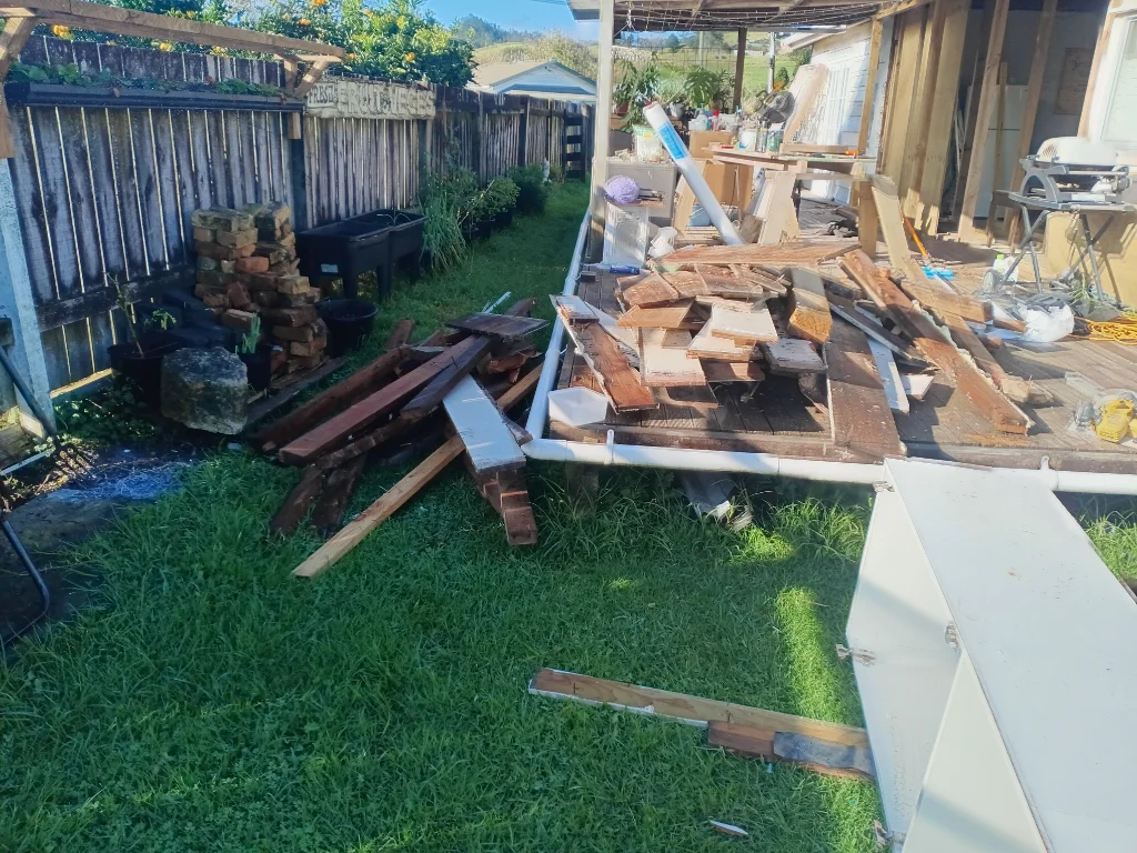

Tbh i was in no rush and had the fire going for 7 hours and was constantly chopping up timber and feeding it.
Got about 80% of it gone.
The embers still hot this morning, i throughsome wood in before i went to the cafe and its blazing away again.

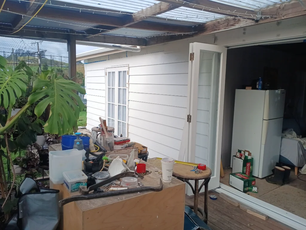

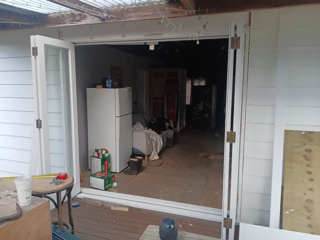

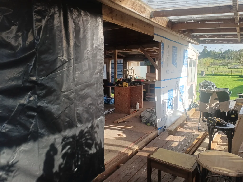

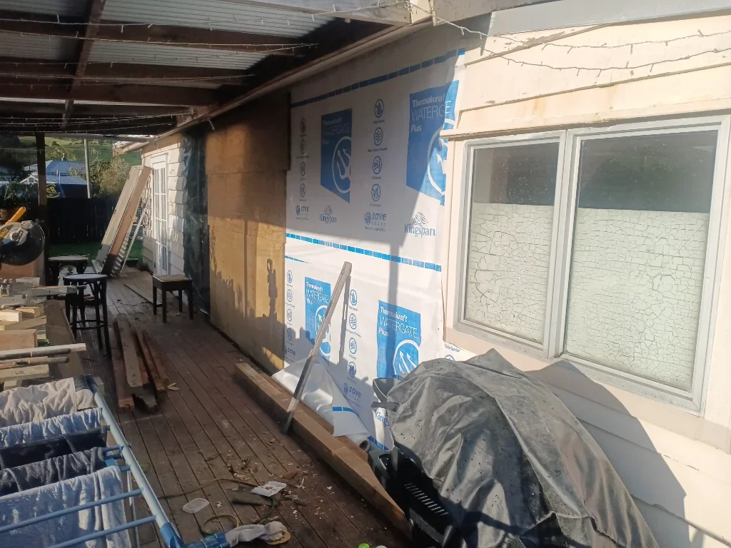

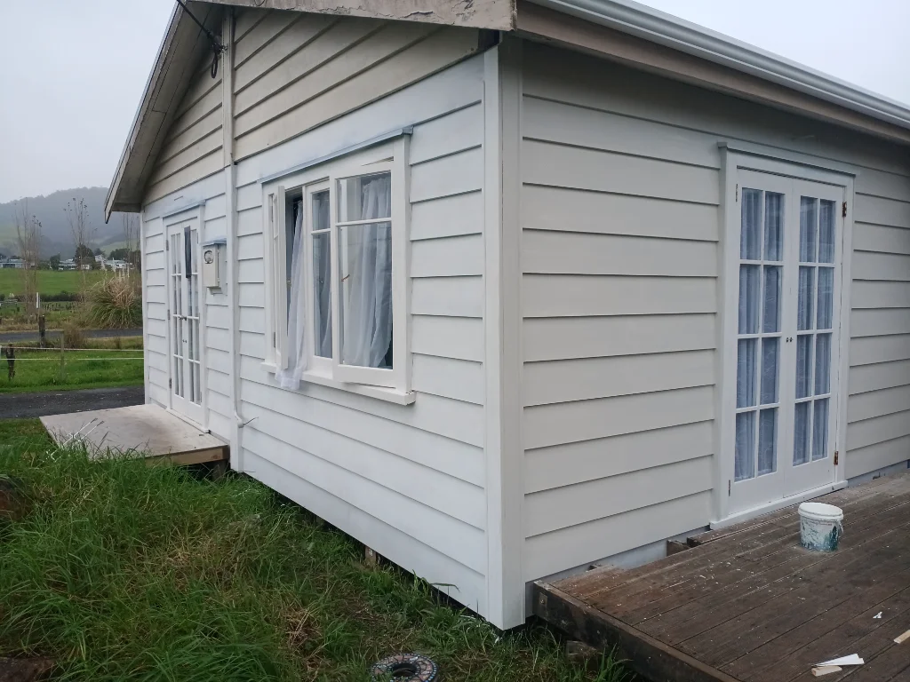

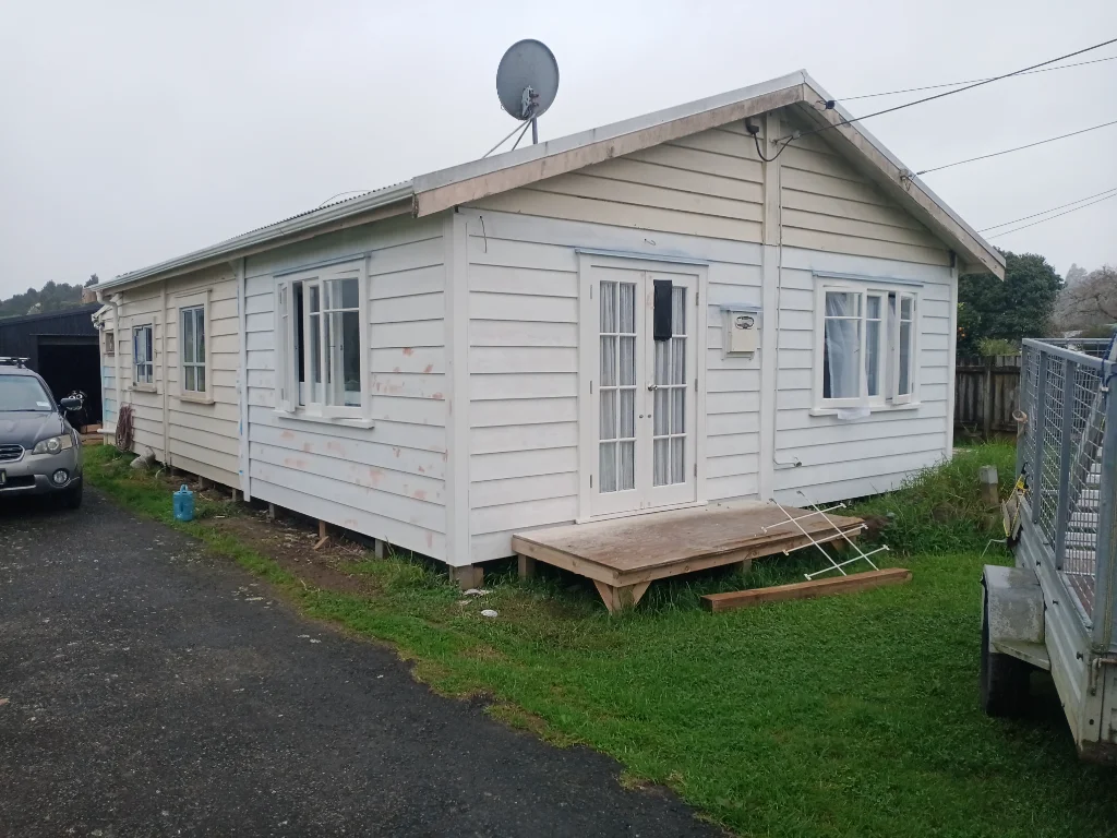

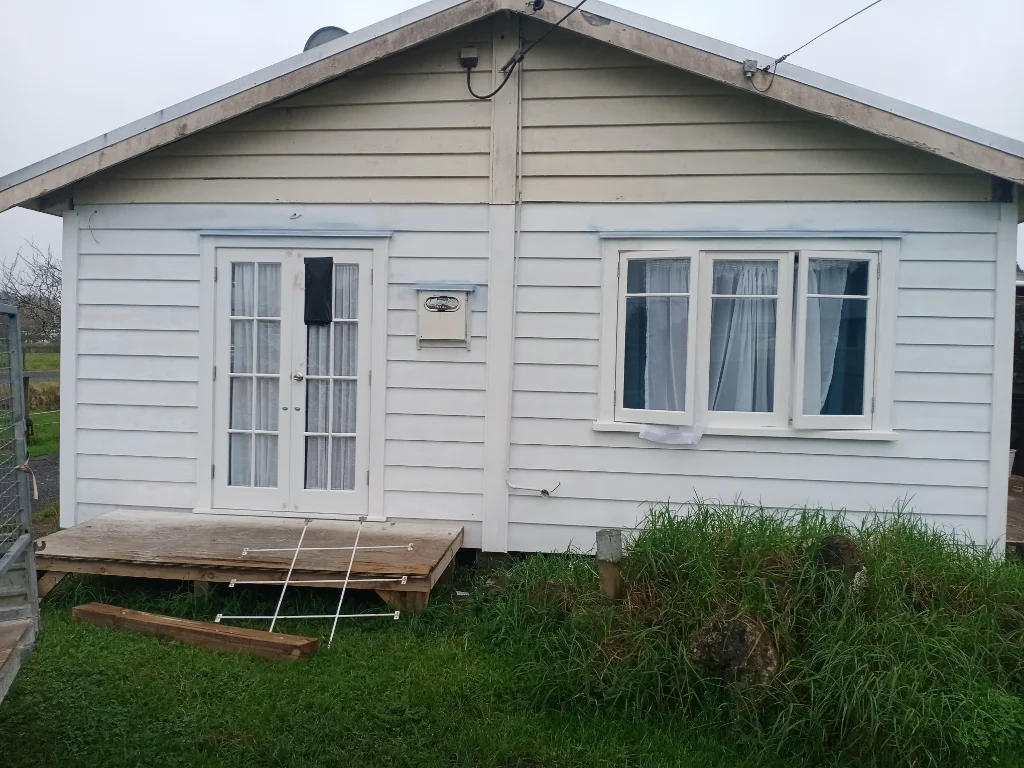

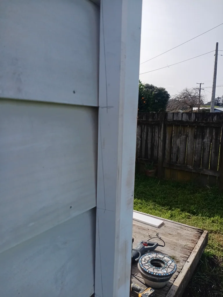

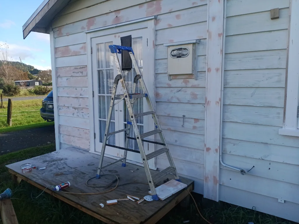

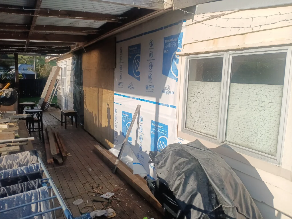

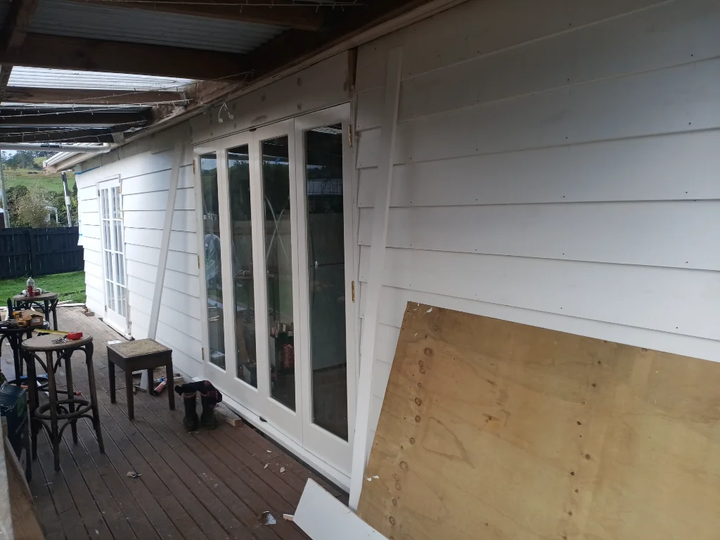

Last week and over the weekend i got the doors in, cladding on most of that wall and burnt the last of the crap.
Stupidly, i had left a section fo the old cladding on where the french doors are in the master bed. Id finished all the trim around the doors as well.
When i put the new cladding on, it made that are look so shit, that and the amount of workstill left to sand up, fill and paint that area made me decided to rip it off and put up new.
So more shit to burn and trims to re-make for around the doors.
Worth it though i think. You live and learn.

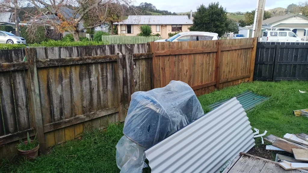

Yesterday was out getting materials and making a start on the trims. Also waterblasted a coulpe of sections of fence in the afternoon. Tmpretty sure mark said he built the fence 30 od years ago. It look like it but im absolutely amazed how nice it comes up!
Today im back on the trims and will start punching nails and filling stuff.
Im hoping the weather plays ball as id love to get some paint on as much as possible as winter is closing in fast.

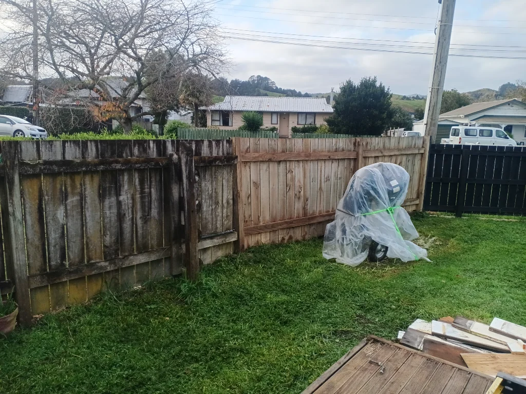

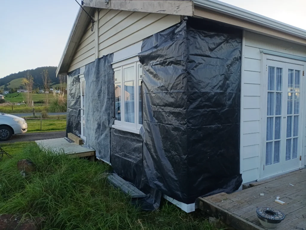

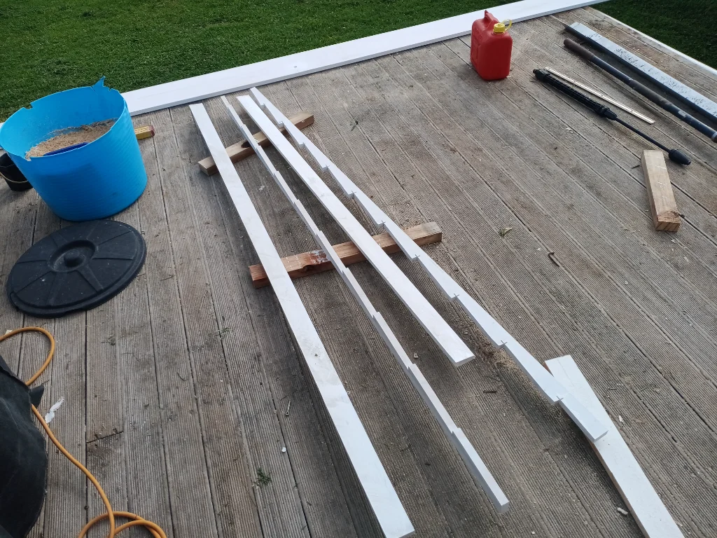

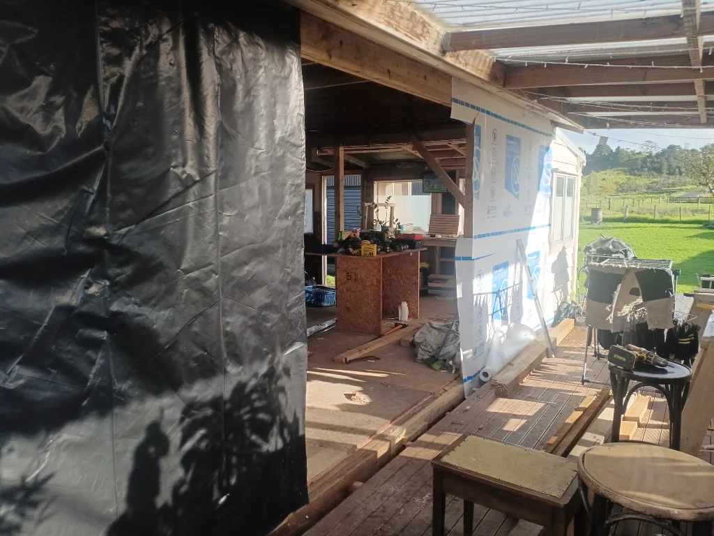

Well apart from a few cracking days the weather has been largely shit for the last few weeks. I manged to get the boards that i undercoated and fitted last year sanded up ( the weather had fucked em up a bit) and covered in plastic before the rain came.
They sat like that for about 3 days then it was take the plastic down, do a few hours work then put it back up overnight. That went on for about 3 days befor i got em primed, filled and undercoated.

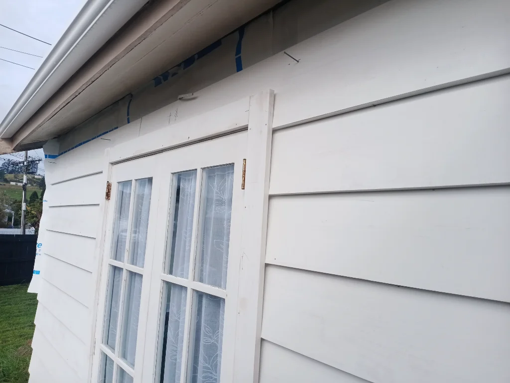

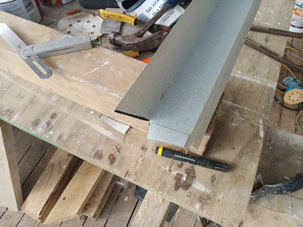

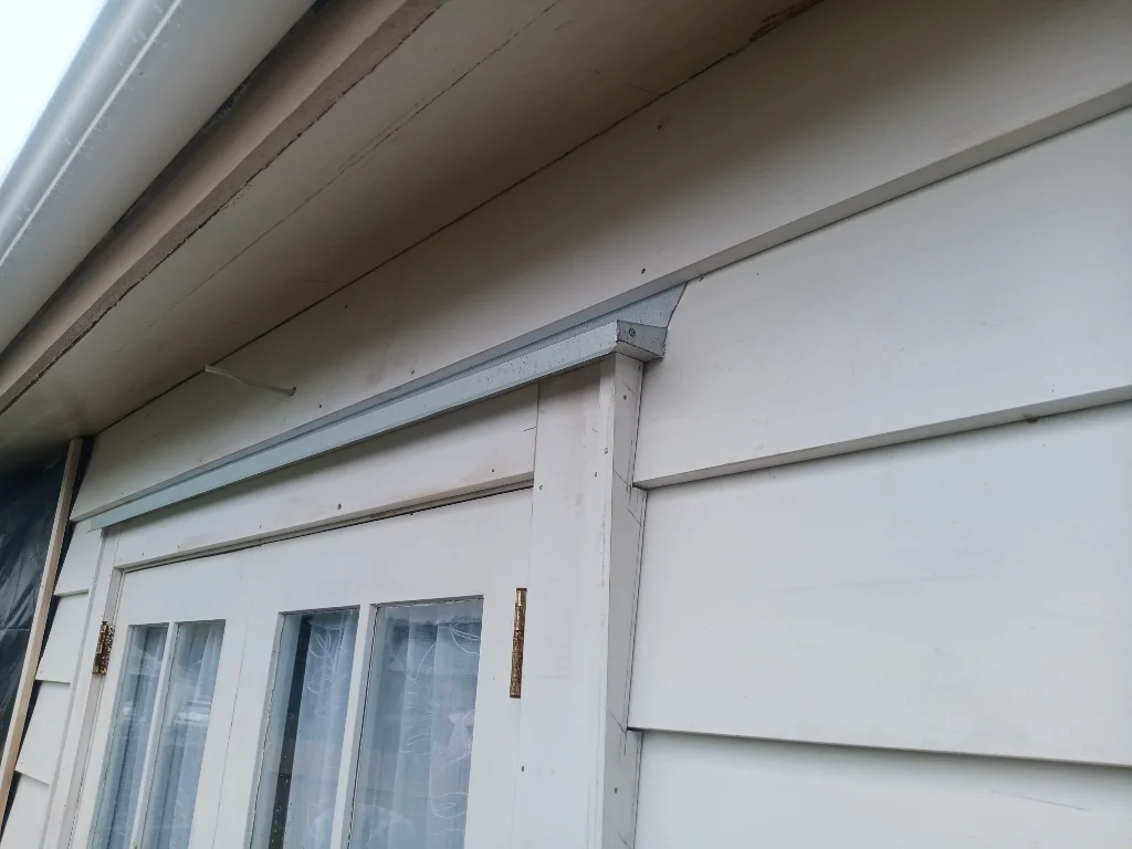

Also got the metal flashings above the windows and doors, had them made up about a year ago but other jobs took priority.
Got the trims around the windows and all scribers on and now everything new is pretty much ready for gap filling and top coats.
Got 1st top coat on the walls on the new patio door side and really like the color.

Sum pics befor i head to work.

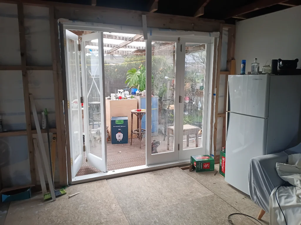

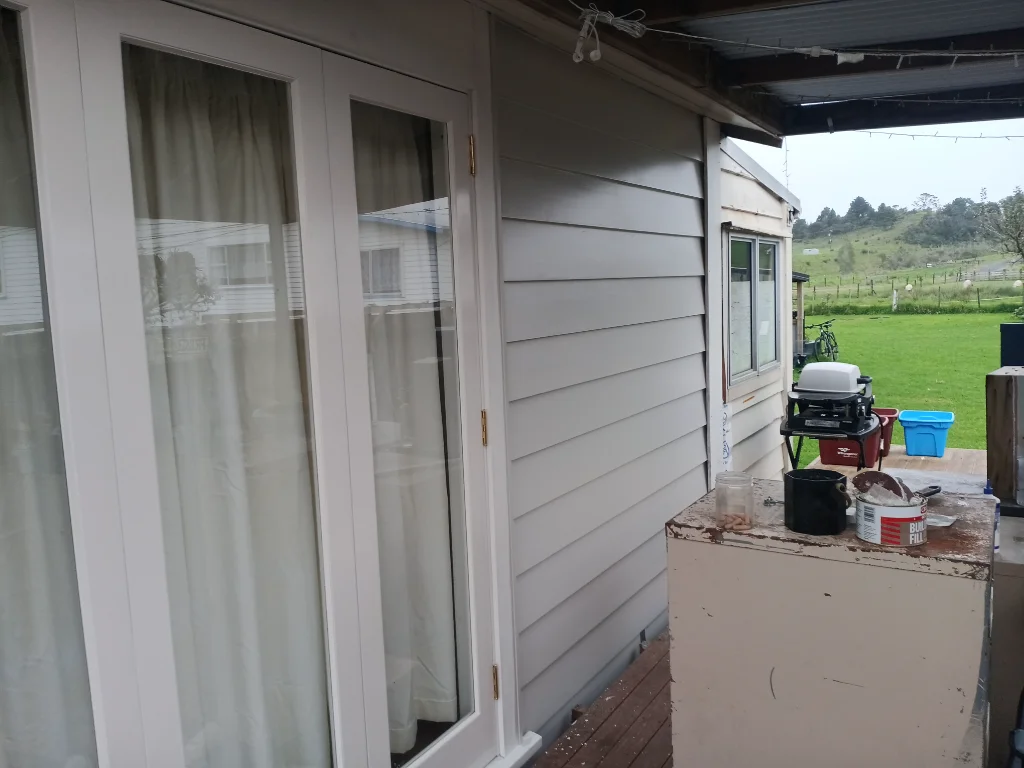

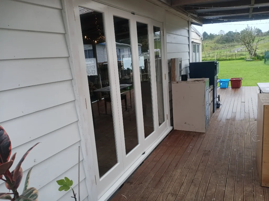

The bigger doors look fantastic bud. Even the chooks like them. Either that or she's offering herself as a sunday roast :unsure:

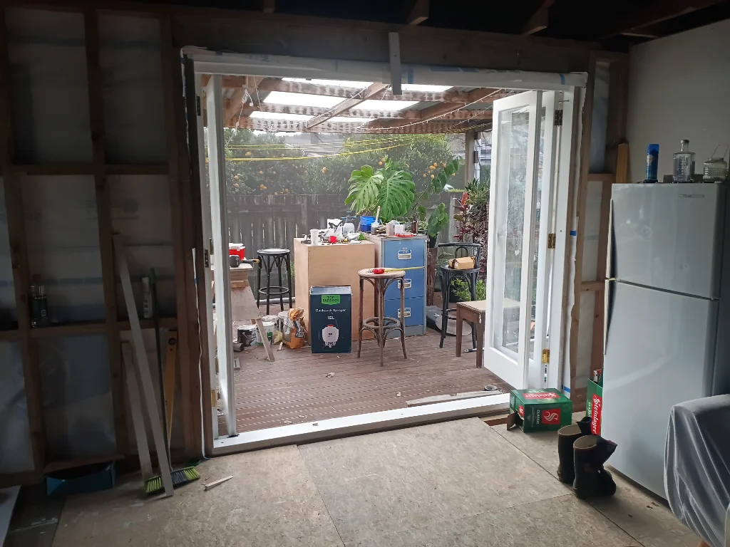

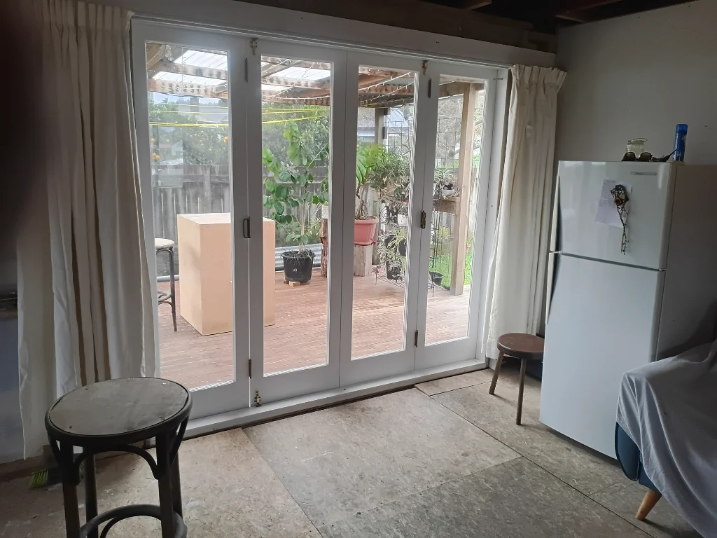

Yea man, the doors are ace! They look the dogs now b has cleaned the glass.
One of our best buys i think. We paid a grand for em but tbh the toughened glass alone would cost that. They needed a fair amount of work but no where near as much as the other joinery.
They are a perfect size for what we are doing internally and let in a load more light.
All they need now is a final top coat, the new draft strips fitting and a keep for one of the shoot bolts. Bit of a shit, found a company the stocks em but they wont sell the keep separate. Its 65 bucks which aint huge money but the keep would only be like 10% of the brass involved.
