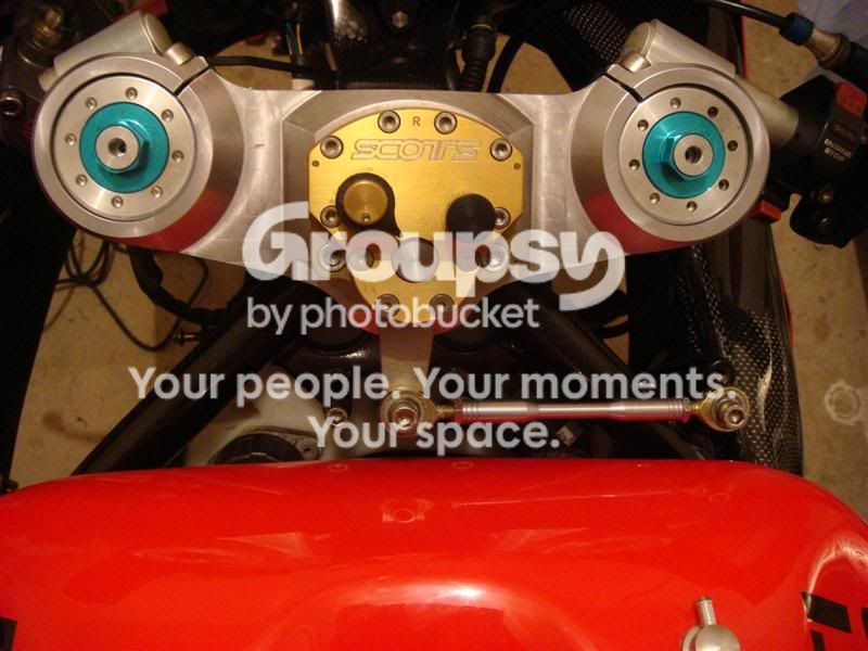

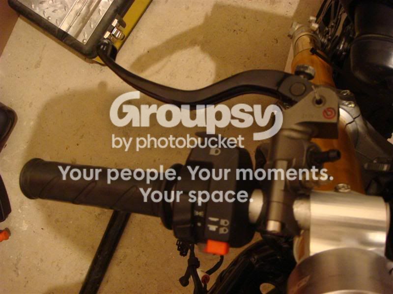

Finally got a rolling chassis completed last night, should be a simple enough operation in theory but the reality of fitting a load of Corse parts to a street 748R frame is quite different! :mad:
Had to modify loads of bits but we're there now!

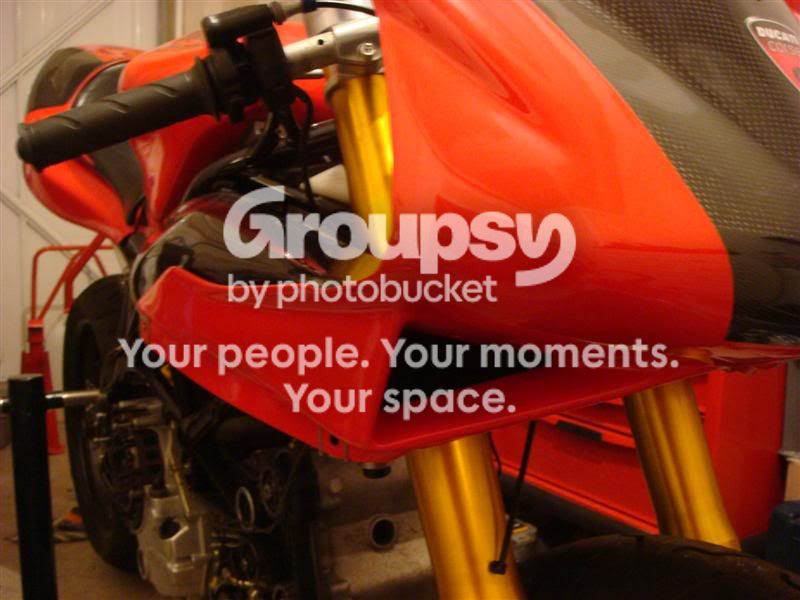

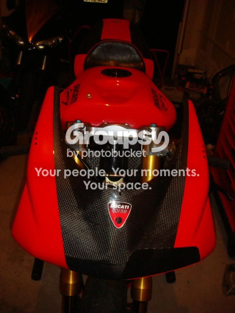

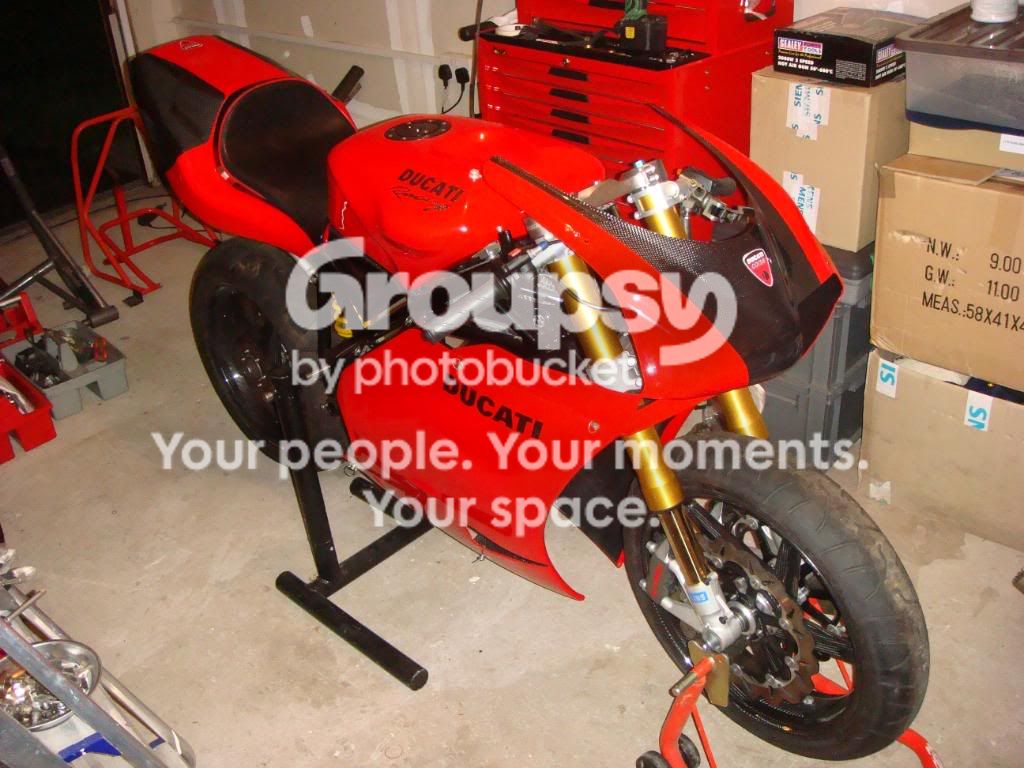

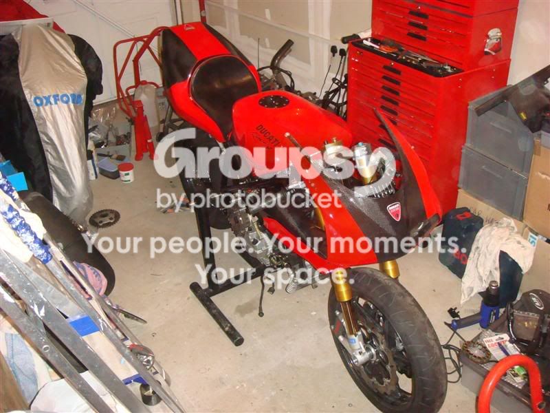

I've hung the bodywork on temporalily to see how she'll look (and to reinstate some of the enthusiasm that has been drained from me in getting the compatibiliy problems sorted out) but she's looking good, IMHO, and I'm raring to go again.

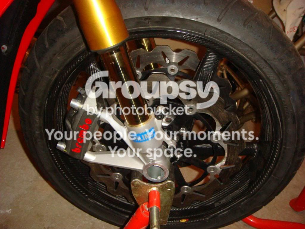

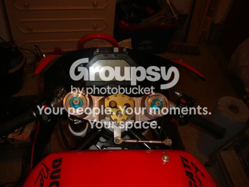

Front end (1098s front end, Galfer discs, BST wheel)

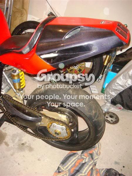

Rear end (Mag arm, Corse Ohlins, BST wheel)

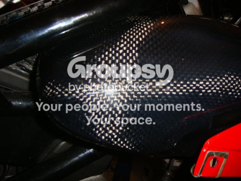

Found a rear hugger that’ll fit mag arm with minimal mods - a nice Harris item.

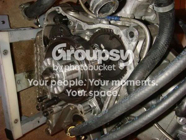

Fitted Engine to frame

Fitted Brembo brake and clutch master cylinders
Mounting twin Brembo reservoirs on the top yoke ala ‘Moto GP’ style! (not in pics)

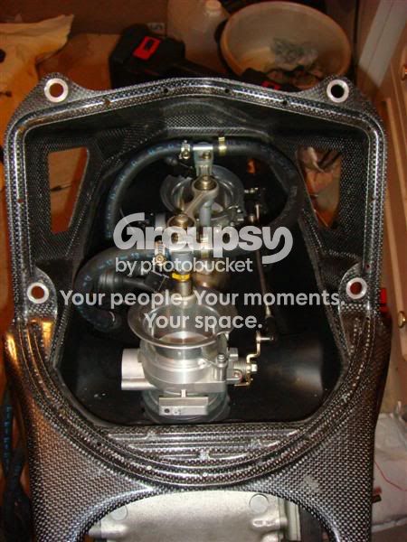

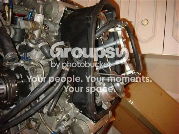

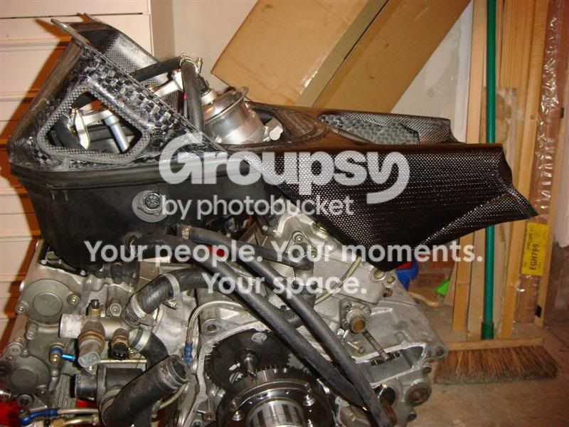

Got all the parts for the 748R injectors/airbox conversion together - cheers Eddie!
Matched 748R inlet rubbers to 996 Corse engine
Trial fit of carbon tank - clears the overhead injector assembly fine - phew….!
Modded 748R airbox for oversize Corse air tubes
Ordered airbox entry filters from Australia - suitable for big air tubes (allegedly!)

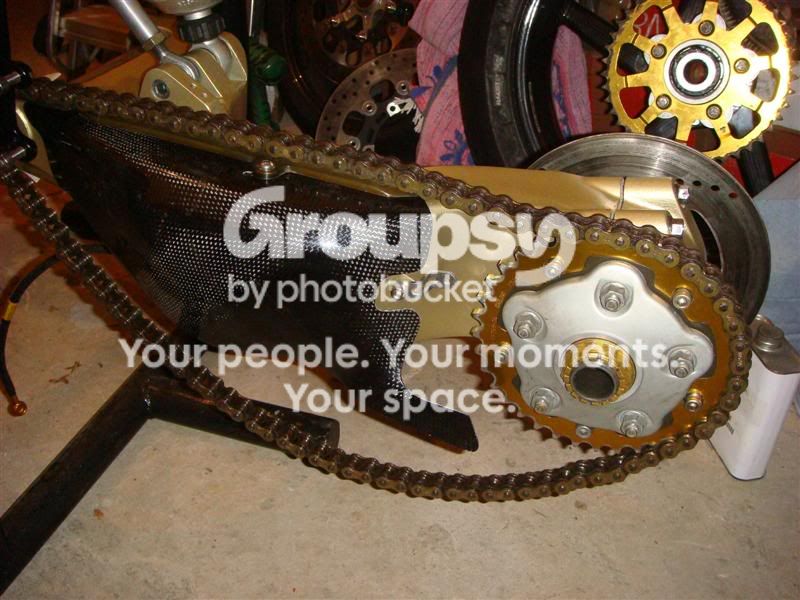

Realising that I have to machine the mag arm again after I’ve had it Alodined and painted.
Not ‘computing’ that ‘Mag arm = 19mm longer = original nearly new chain too short’
Realising that bigger mag arm needs a tiny AP calliper at £500+, so modded arm for a GBM item.

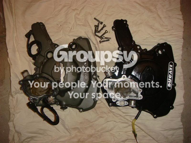

Finding out that the lovely satin black engine cases I have had saved for this project for ages are not compatible with the Corse engine so I’ll have to get the existing ones refinished.

Waiting for engine cases to be done.

Hi Brian, the Mag arm is alot broader than the std item, where a std item has a 'wrist' at the point where the hub section tapers down to a narrower beam section, the Mag arm doesn't taper at all, it stays the same breadth as the hub along it's length.
The problem arises from the chain adjustment using the eccentric action, the picture in my post is of the hub at it's lowest point with no chain fitted so there is a lot of room between hub and caliper. After the chain is fitted and some of the adjustment is taken up, the caliper will naturally move inwards towards the hub due to the eccentric action, but there is not enough room to adjust the chain on the eccentric hub with a std caliper fitted. The Caliper just abutts the arm before the correct tension is reached. Even with the GBM item fitted (a good bit smaller than the std Brembo) I had to machine a notch in the casting to allow the caliper to clear during chain adjustment.
The other problem was with the billet rocker arm you need to fit to maintain the correct suspension ratio. The one I got was from a factory RS which has a lot more meat on it than the item you get with the road bike mag arm kit but the RS has a different frame with more space in this area so I had to make a template and machine it a little for full clearance through full travel in the 748R frame.
