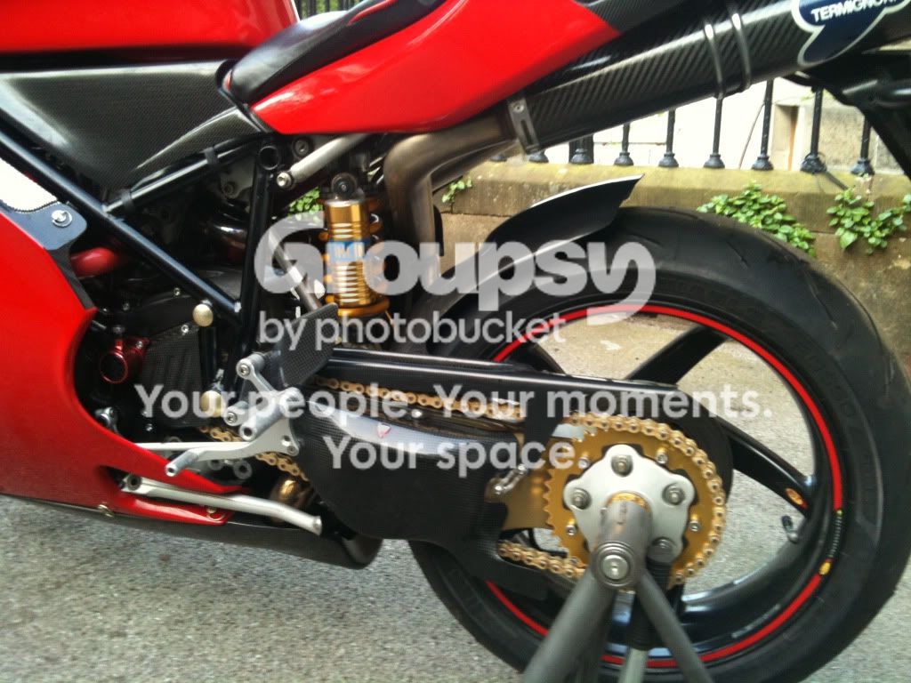

Well she eventually made it to Eddies for a final check over and MOT so here's a few pics of the finished machine, until I find an 1198 motor that is!
(they're never really finished are they?)
She turned out ok I think.

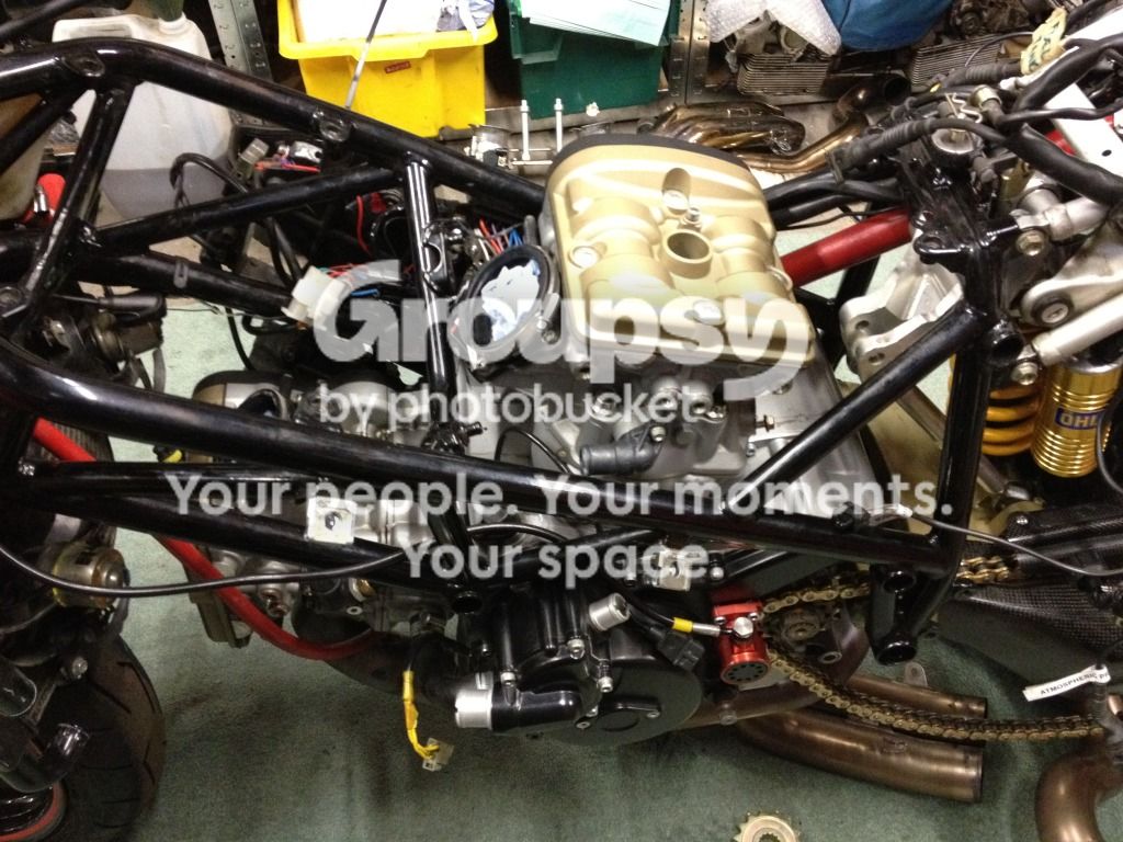

She's in bits again!
Old lump oot, 150 horse superbike Desmo engine anyone?
1198 engine in!

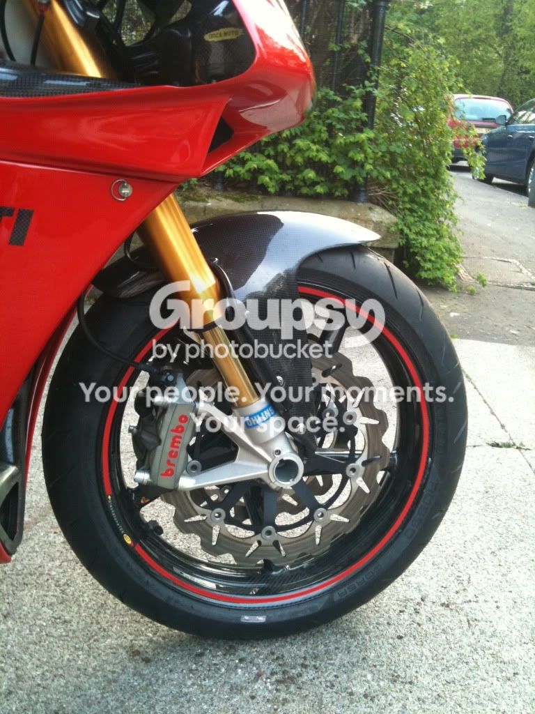

What was supposed to be a 'temporary' chopped 70mm 1098R Termi system ended up fitting so well and looking so 'right' on the 748 silhouette that I didn't bother fitting the super-rare 60mm 998RS system I had procured, instead I swapped it with a chap who was re-building a BSB 998 (he has another few Ducati race bikes as well) for these babies he had "just lying" around! :eek:
Allegedly from Vermuelen's MotoGP bike circa 2005ish, absolutely over the top for road use but hey! :D
Hung in, but going to swap to widetrack Corse yokes:
Even got Magnesium top caps!
