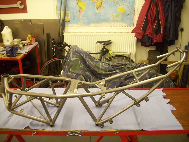

Frame ready for paint
Frame - Bare by Pict CB, on Flickr
That's it right down to the bare metal now. Plenty stripper and pan scourers were involved. Eagle eyed / anoraks will notice a few wee bits have been hacked off along the way including the 'helmet holder' bracket :eek: How will I hold my helmet now :confused:
Next is steam clean to ensure all the stripper is removed, then rust treatment, etch primer, 2k primer, flat with 600, then 2k paint (487.111) but that's all going to be done by uncle Ally who knows what he's doing ;)

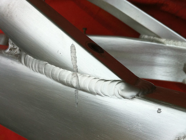

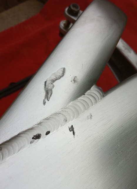

The late / rare swingarm that I sourced from Barksie on here had some marks in the anodising. Credit to Steve, he did ask if I still wanted it when he noticed on dis-assembly.
Swingarm before 1 by Pict CB, on Flickr
Swingarm before 2 by Pict CB, on Flickr

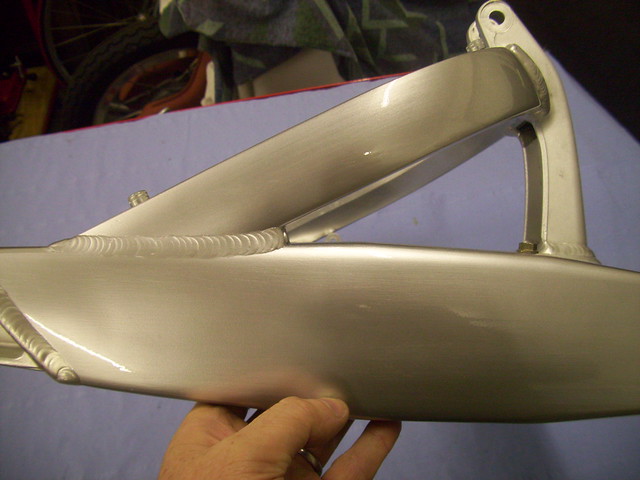

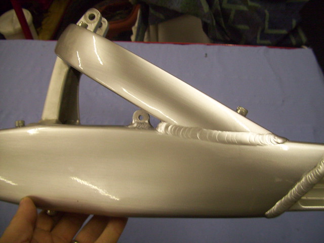

Bike Paints worked their usual magic;
Swingarm 001 by Pict CB, on Flickr
Swingarm 002 by Pict CB, on Flickr
You can make out in the photo's that they replicated the 'brushed' effect of the original anodised alloy, just the look I was after, I didn't want it too 'painted'.
Fantastic job, very reasonably priced, but took ****ing ages!

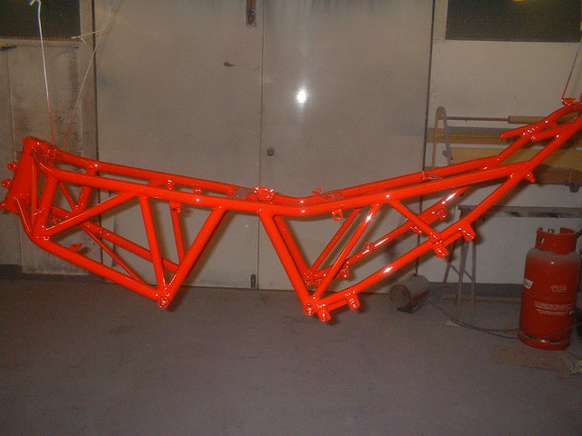

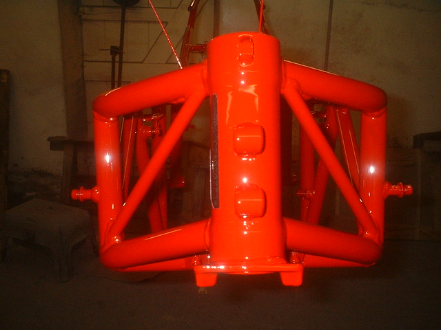

That's a bonny shade of red :)
It's the Ducati shade 487.111
In the end he couldn't get that shade in 2K and the base coat colour was fell thin so after the rust treatment, etch primer, primer it got a wee undercoat of generic red then the 487.111 base coat then lacquer. Not seen it in the flesh yet, collect next week :D
Don't expect it to be sooo bright in the flesh, I think the flash is messing with the colour.
I think it will look sweet once put together......ready to head out with the ss clan come spring? Mine is running loverly now, since Brian P sorted my carbs oot.......had a nice wee borders blast to myself last night...:D
