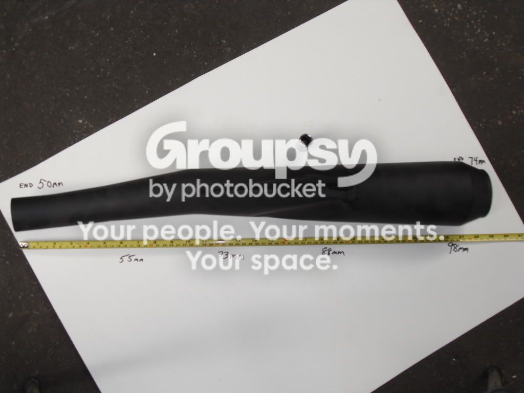

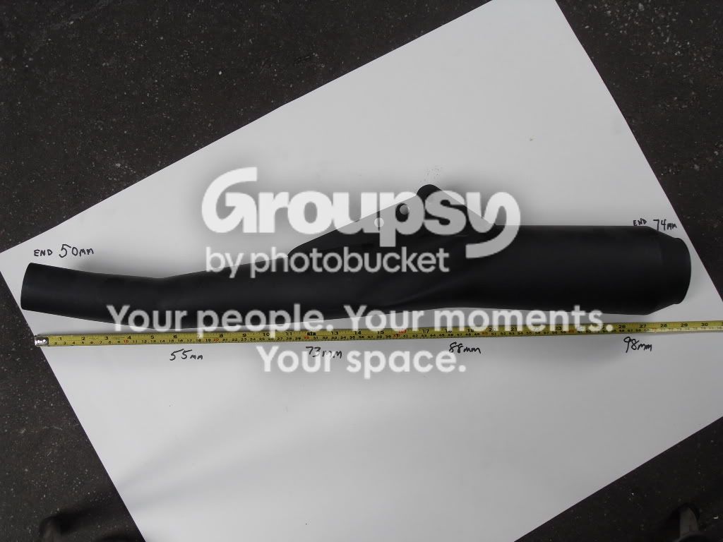

The silencer looks great , Like the panel beating too. Did you roll the cones and seam weld them or buy the parts? What tubing would you recommend for for the down pipes?
Have you good any pictures of the bike in its latest state? keep up the great work.
Stainless for the headers and silencer look on fleabay for stainless exhaust bends pay attention to the CLR (centre line radius) and make sure they suit the rad you need. Are you any good with radial line development for the cone? if not download "plate n sheet 4" trial version you can do the indavidual cones there and print off (make them a wee bit longer so you can trim them back to give the off sets) save up your cornflake boxes to make the templates from or if ye feel adventurous try hydro forming the cone slice cut and move around untill ye get a good snug fitting silencer. Have not worked on the bike for a while now and doubt i will for a while yet, looking at building an extension on the house fitting a biomass heating system mezzanine floor in the workshop, finish my wee brewery off ( before any of the previous) and then chill for a wee while ready for the winter setting in (next winter) :)
