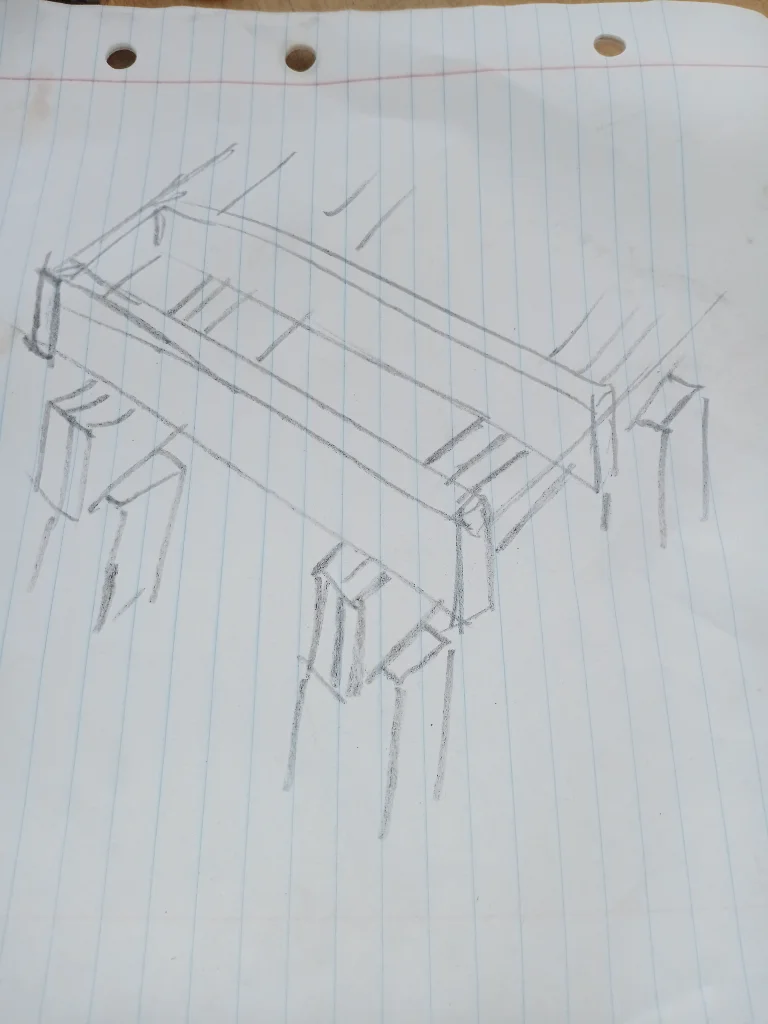

I thought 6 x 2 joists across wooden piles.
How high of the ground are you going?
You could get away with something like double 6x2 bearers and 6x2 joist at 400 centers ( think they span just over 3 mtrs for a floor) and at 5mtrs long put 5 posts under each of the 2 bearers, that would make em roughly 1250 centers. More than enough. Unless you are parking a car in there!
Something like this very rough sketch!
Excellent thanks mate that’s along the lines I was thinking but probably wouldn’t have doubled up the 6x2 bearers so good info.

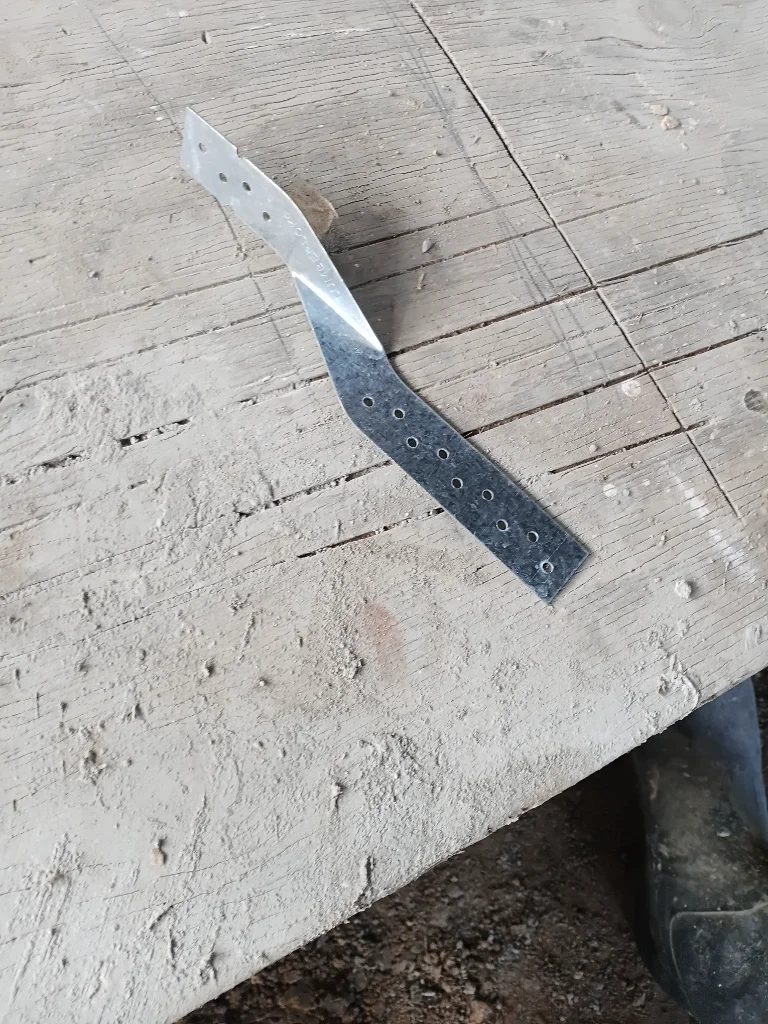

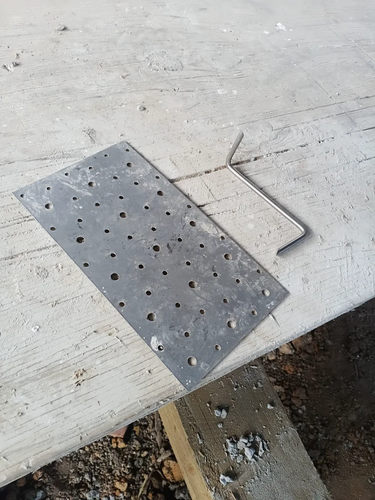

Nails all day long!!! For post to bearers use plates like in this Pic and square shank twist nails ( not galv clouts like wha the polish do!) And or the z nails in the pic.
For joist to bearers I just skew nails with my framing gun 4 per or for belt and braces brackets like in 2nd Pic and square shanks.
Screws are shit!!!
But im sure the correct ones would work fine...
Those plates are 100 x 200 BTW. You would probably get away with doing the corners with those and z nails on the rest. Im not structural engineer , these details are usually provided to the builder but from experience , this info is very much along the lines of previous projects. If in doubt, go ott, none of the fixings are hugely expensive and dont take long to fit at all ..
Screws are shit!!!
View attachment 158767View attachment 158768
How on earth do you hammer those Z nails in?
That looks like a regular, straight, nail AFTER I’ve bashed it with a hammer.

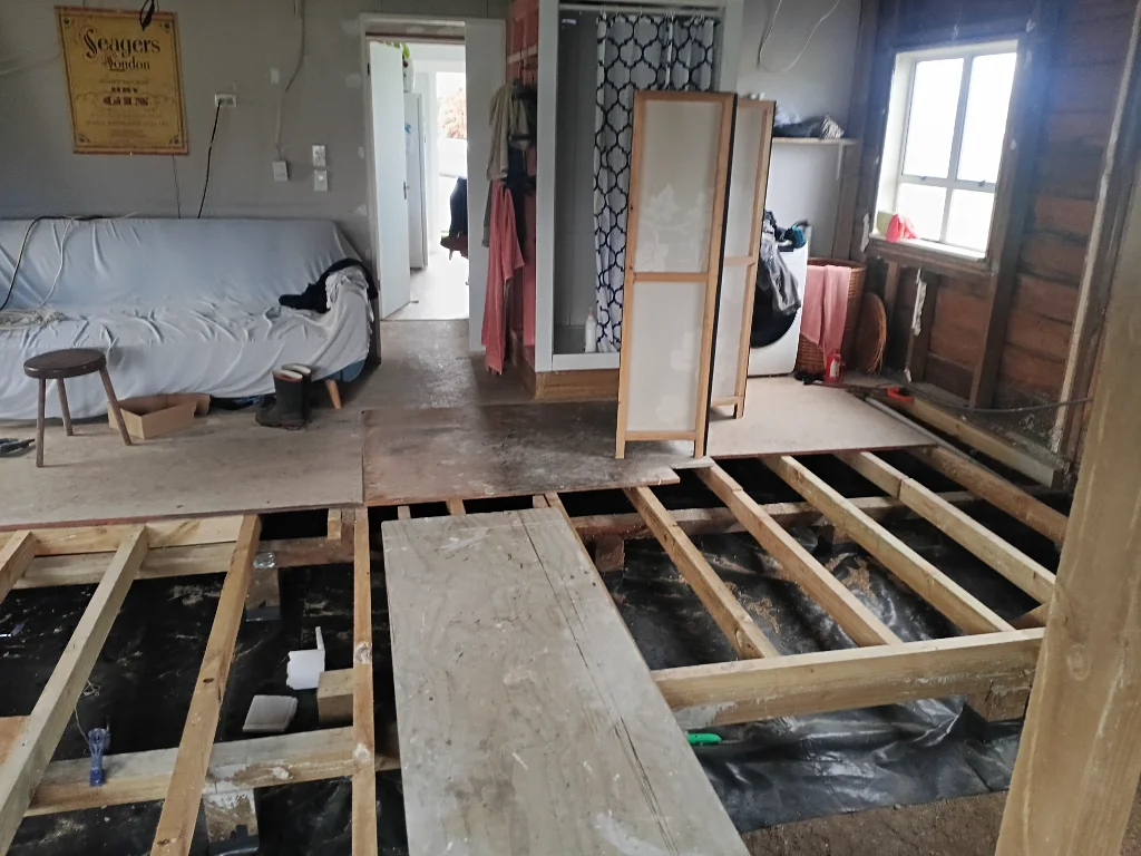

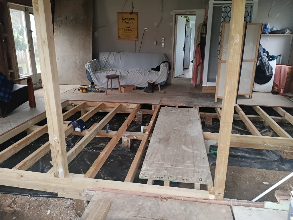

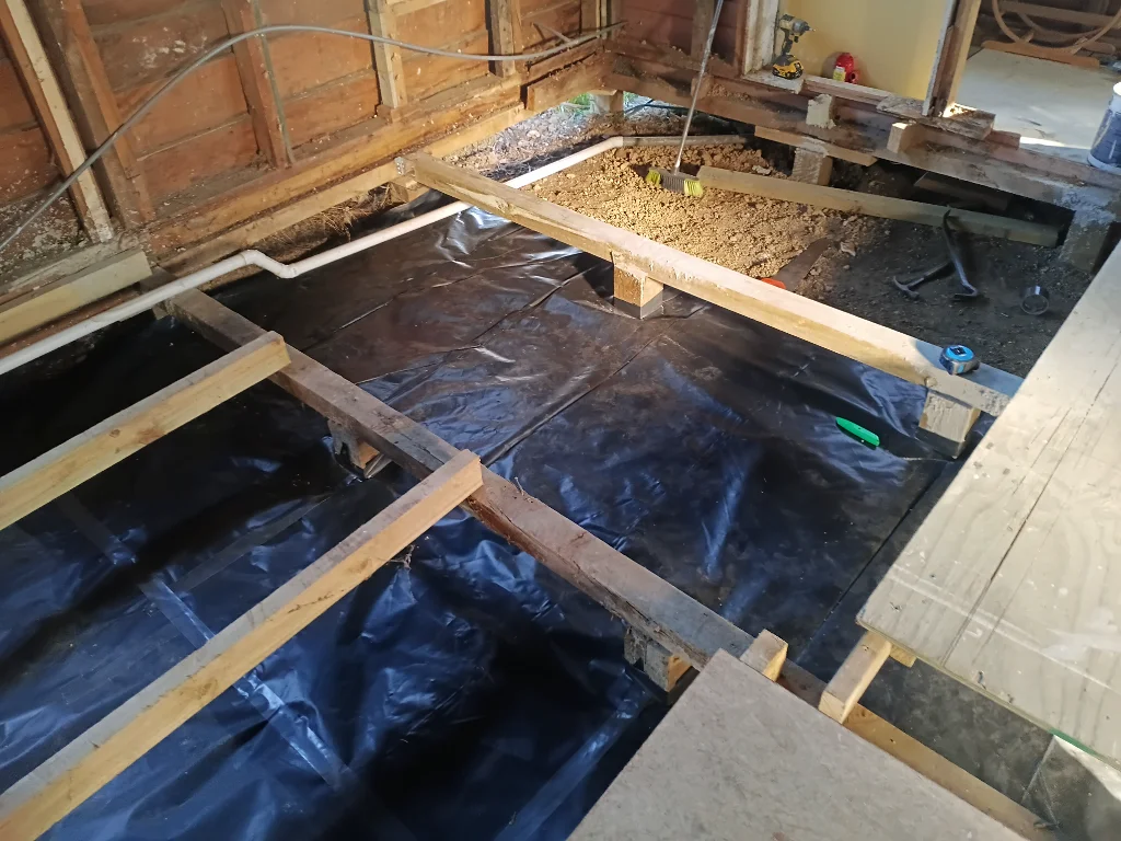

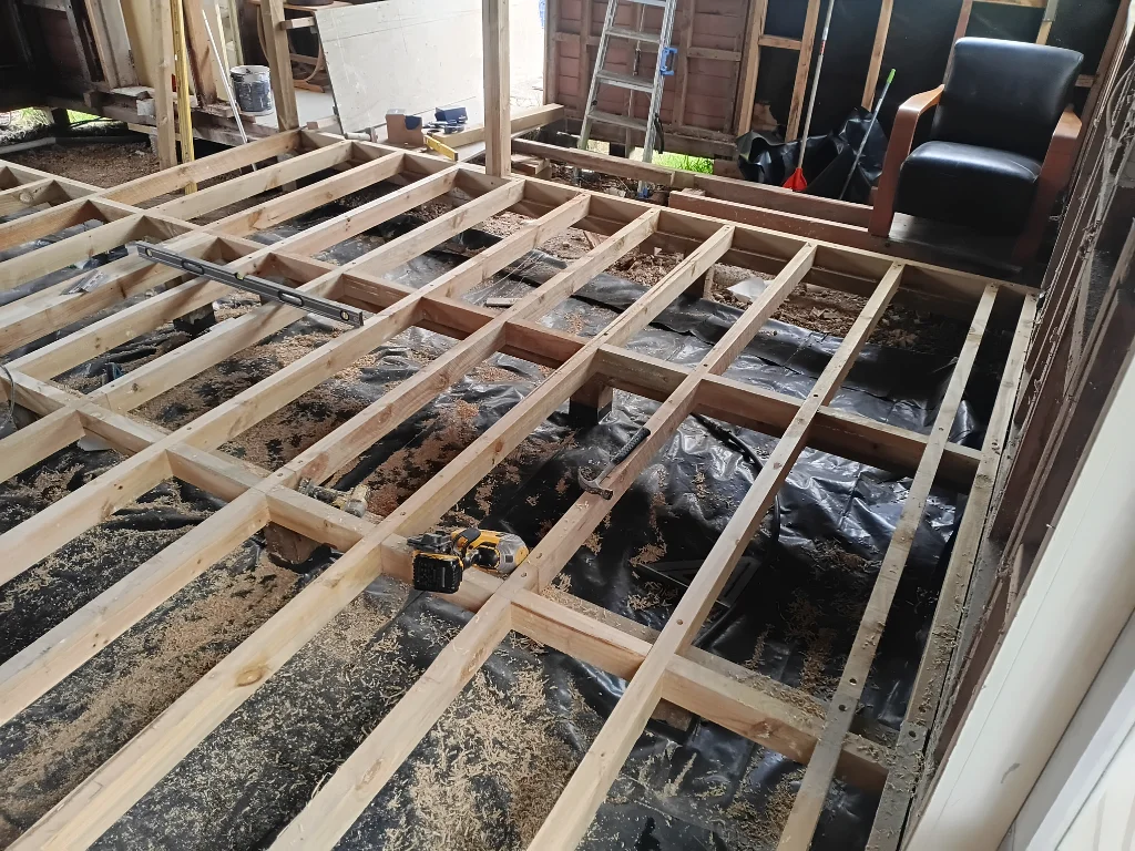

So over the last few weekends ive got what joist I can put in errrr put in... got the damp proof membrane in and done loads of clearing of crap around the property.

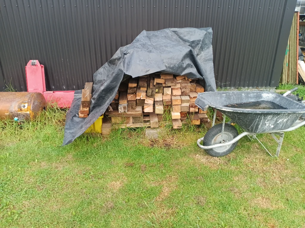

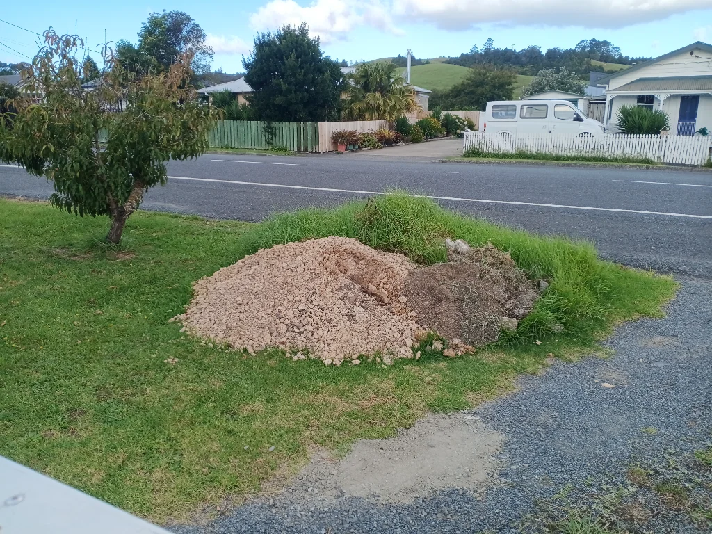

Used the last of the builders mix up, removed the ply it was sitting on and emptied the potting mix from the now dead tomatoe plants onto the bald spot , one week on and grass is already sprouting there!
Couple of days ago a mate turned up with his digger and cleared the pile of clay from out the front, glad to see that gone, musta started piling it out there a year of so back..
All the dunage and bits of timber that were laying around have been chopped up and stacked for burning at my birthday bash in a few weeks.
The lawn is getting bigger as piles of crap dissappear, its great.
Today I am about to pull up the temporary flooring, put a straight edge on the joists and plane out any high spots, finish the nogs and start installing the insulation.
Don't know how far I will get before mates start turning up and corrupting me..
Then it permanently fix down what flooring I can. Got to do a tip run as well.
It's all fucking go here I tells yas..
Some pics of stuff...
