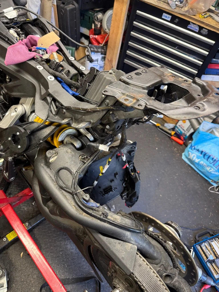

Had a bit of a mare today. I finished off a Desmo service on an XDiavel on Friday, went to start it up after putting it all back together to check all was ok and the DVT timing was doing what it should do but it wouldn’t start, dash came on, but nothing when the starter button was pressed. It was 5.30 on Friday so I left it over the weekend, thinking ‘ what have I forgotten to reconnect?’ 🤔.
Went back in the workshop this morning, same thing. Feck it. Checked the fuses, all ok. Checked the relays - not easy to get to on the XDiavel. Not ok. Got the multimeter out, ran some tests, no power going to the starter relay to fire it. Study the wiring diagram, It gets a feed from the ECU. I need to check there’s continuity on the wire and whether or not 12v is even coming out of the ECU.
The problem is you have to do this to get the ECU out so you can remove the connectors, to remove the protective cover to get a back probe in.
Dismantle the whole of the rest of the bike to remove the panel the ECU is attached to, there’s not enough gap between the subframe members to remove it from the top.
Sod’s Law is one of the bolts holding the panel in place was seized and has been rounded off by a previous person. Ended up having to drill it out. 2 hrs and 2 drill bits later it’s finally out.
ECU off, check for continuity on the cable to the relay - all good, check for power out - nothing, 0V 😕. Check the ECU is actually getting power into it - more back ironing snd yep, 12V 👍. So, why the F isn’t it coming out?
Lots of head scratching. Fecking thing, it was fine before I started working on it. I haven’t even touched the ECU until today, WTF is going on.
Then, light bulb moment. ‘Uhhh, it is in Neutral isn’t it? ‘ ‘Well, I think so, because I could rotate the rear wheel on Friday and I wheeled it in here on Thursday and put it on the stand’. Was the green light on on the dash? Was it f&&k 😡. 5 hrs wasted. A wiggle of the gear lever, the light comes on and the bike starts. What a f&&king muppet 😔.
Still, lesson learned.

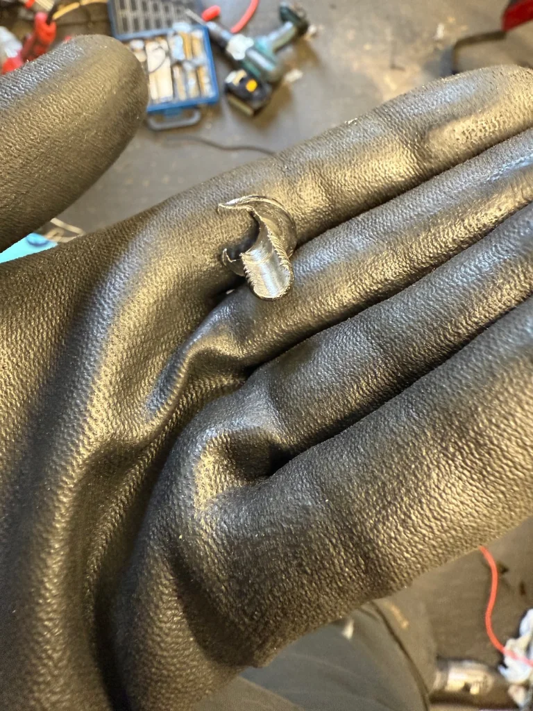

At least you wore gloves. Vote Labour, fight climate change, celebrate diversity and observe health and safety. Yah. ✊

I dont think there is a person who works on bikes that does not have a similar story. You learn something every time even if its something you already know

It's ok I had a bike sit for 2 years me trying to figure out wtf it I couldn't get it to start. Ended up the sidestand was down and in gear.
A favourite false flag on KTMs is an improperly seated quick release fuel line connector. On the 1190 it's clearly in view above the radiator but it's quite tricky to get your fingers in to press the tab and push the thing home at the same time because there isn't much slack in the fuel line and it's a tight space if you've got big hands. You think it's on solidly but if it isn't and the tab hasn't clicked home the fuel is cut off and the engine won't start.
It happened to me late one afternoon the day before a pre-dawn start for a long ride up to Scotland. I'd even loaded the bike up with luggage and fitted the tank bag so it was all ready to swing a leg over at 4:00 am. Thought I'd better just check everything was OK, so prodded the starter and nothing. Wouldn't fire.
Luckily I'd only had the tank off to service the airbox and replace the socks on the intake ducts. I knew I hadn't touched anything electrical or mechanical so I just retraced my steps and found the problem quickly. But I know of people who've done top-end services and when it wouldn't go afterwards have practically had the bike in bits trying to find the fault when all they had to do was poke a finger up under the tank and push the connector a bit harder.
