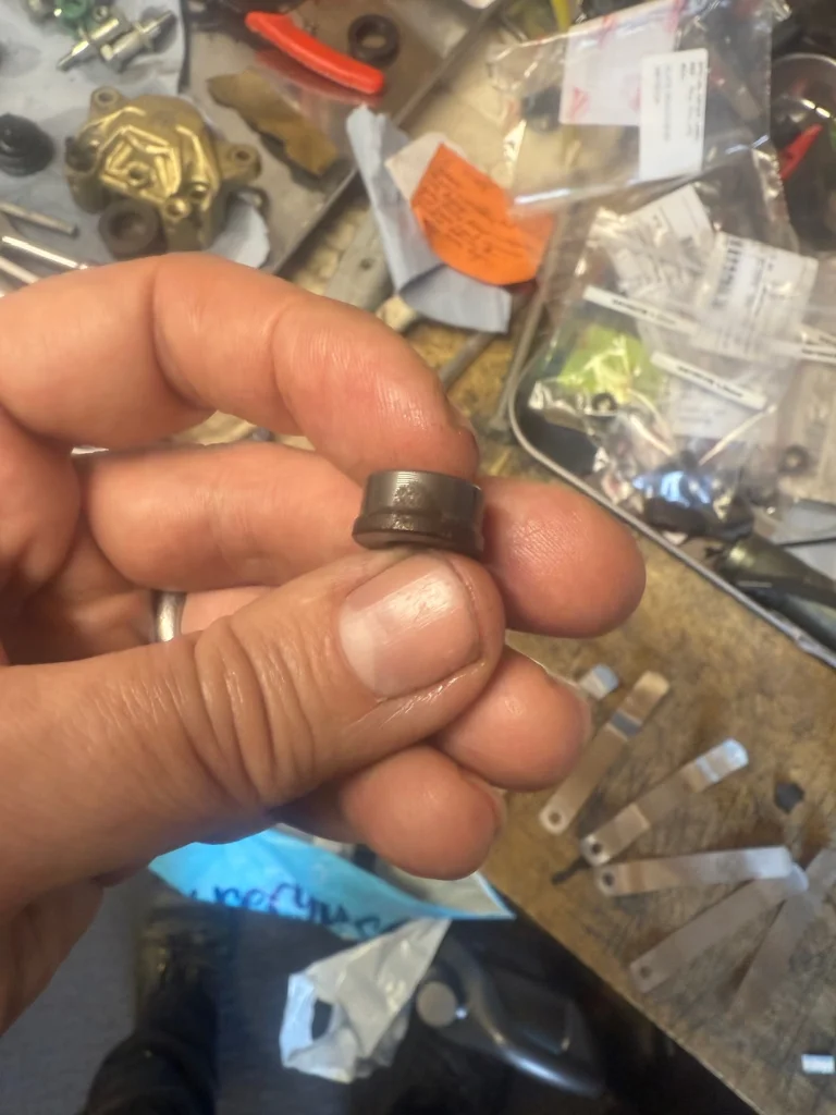

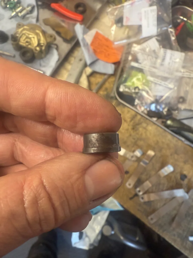

Multi 1200S DVT Desmo service time. It’s the first one it’s ever had done. Will you look at the rusty state of the closing shims inside 😮.
How the f&&k did they get in there ?
They are really pitted!!
Actually they’re not, it’s just surface rust, came off with a bit of elbow grease and some 400grit paper.
They were coming out anyway to be replaced with 0.05mm larger ones, but I’m shocked. I can’t believe the factory put those in which implies someone’s been inside there before 🤔.

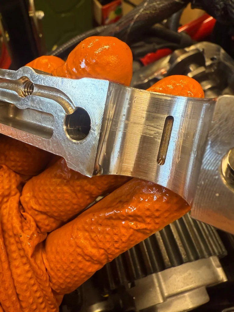

There’s a bit of scoring on one of the cam cap journals as well.
View attachment 135668View attachment 135669
Is it not possible that the bike has been parked up for a long time in a hostile environment (Ireland) and the rust has formed on the inside?
