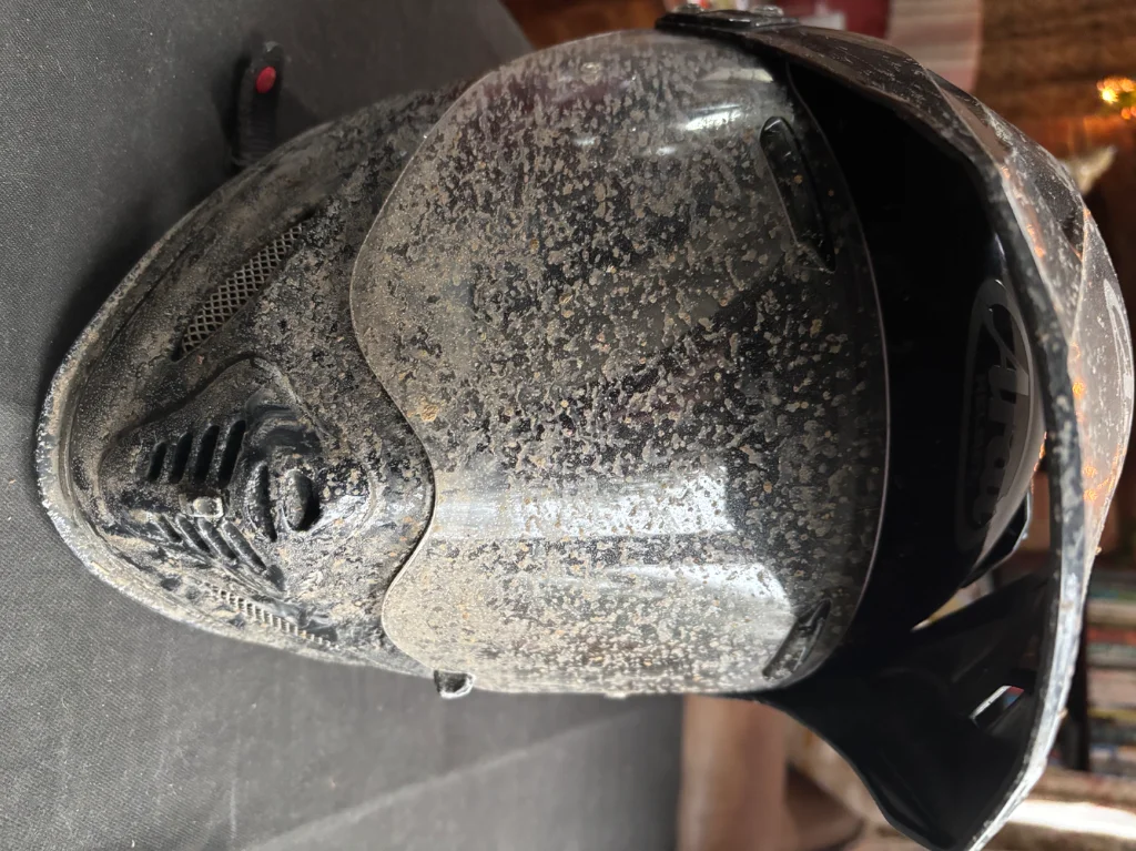

I tried to start the Multi again today - no go, I put my spare battery on- still no go. I tried to start the DR-Z to use with jump leads -no go. Despite knowing better I jumped on the CCM and rode out though the lanes to Cadbury Castle and back. I could hardly see out the visor as it and the bike were minging
I tried to start the Multi again today - no go, I put my spare battery on- still no go. I tried to start the DR-Z to use with jump leads -no go. Despite knowing better I jumped on the CCM and rode out though the lanes to Cadbury Castle and back. I could hardly see out the visor as it and the bike were mingingView attachment 154638
That front mudguard must have been a huge help....
