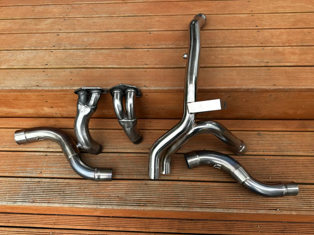

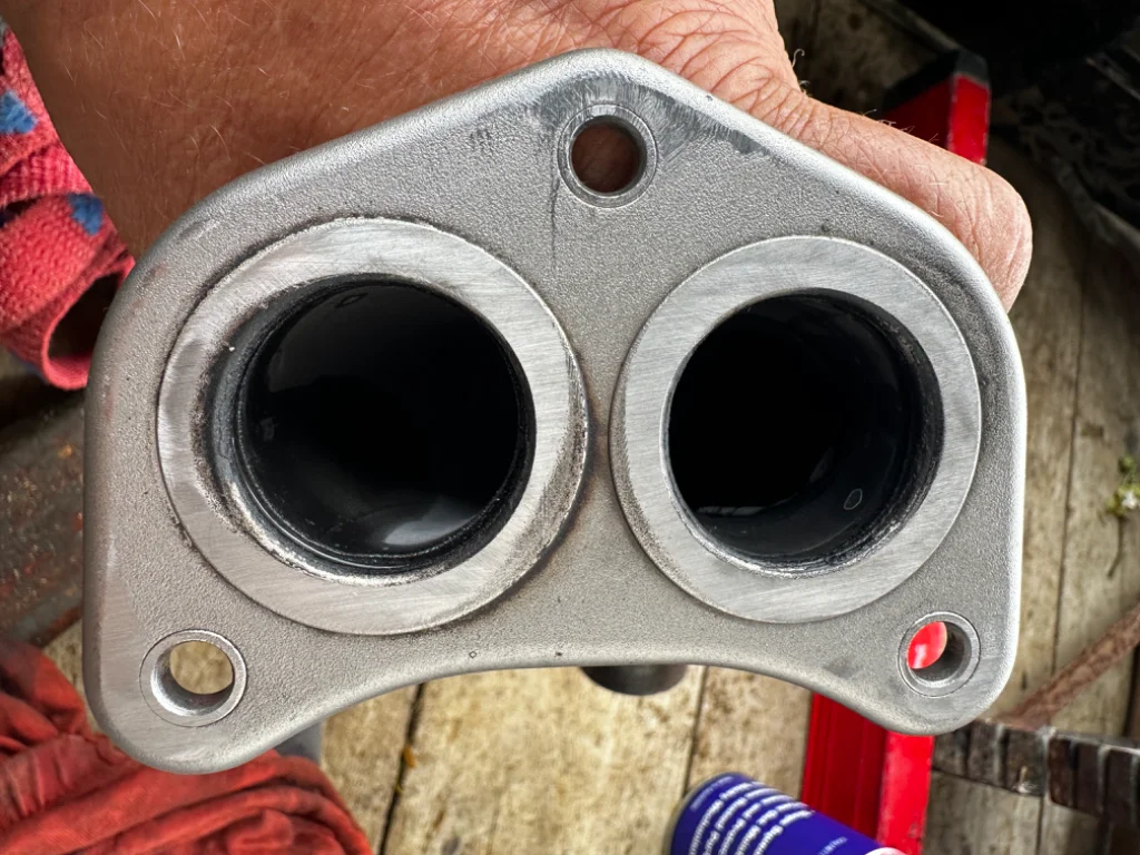

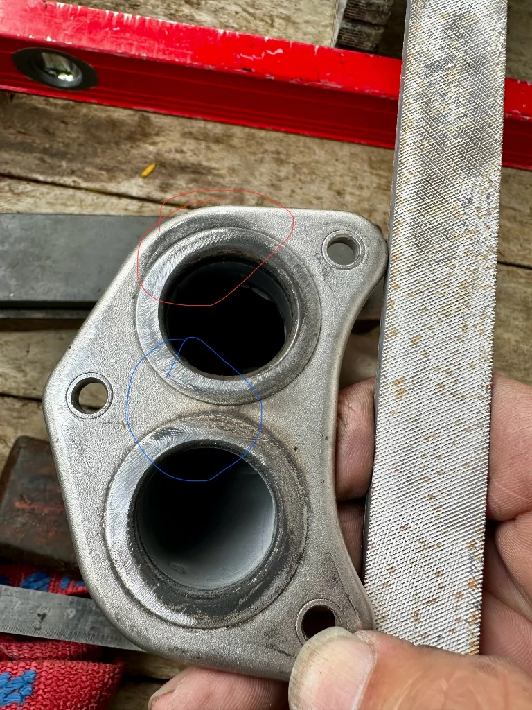

I have been doing a bit of work on my S4R. Put new rear hub bearings in and then stripped the exhaust system off to fix it and clean it. I had to unrivet the ends of the mufflers and sent one of them away to get some titanium welding done on it. Repacked them both and riveted back together. I ended up polishing the whole lot as cleaning just wasn’t doing the job. I also found that the H cylinder has had a warped exhaust manifold which has been blowing by a little bit, ringed in red. When I put a straight edge over it, it rocked up and down about half a mm and so I filed off a bit of meat in the area ringed in blue and then honed it for a while on an oilstone to make it all nice and clean. I am ready to put it all back on but Am going to burn some colour into the titanium muffler risers first with a blowtorch.
