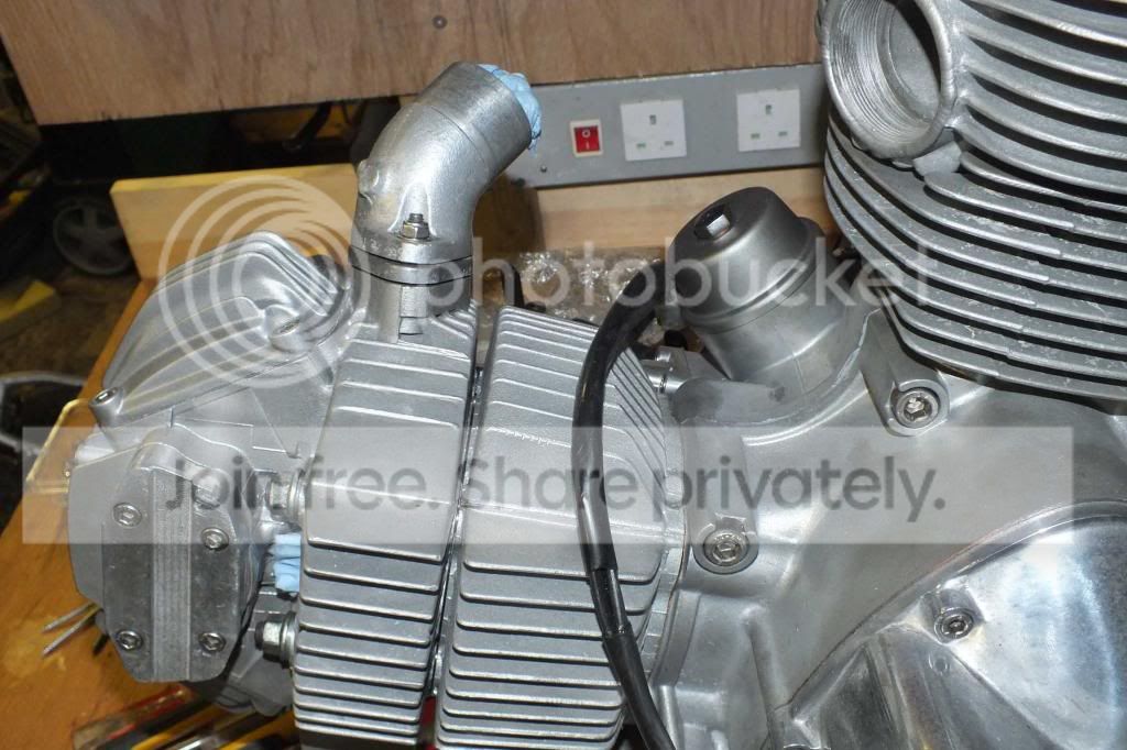

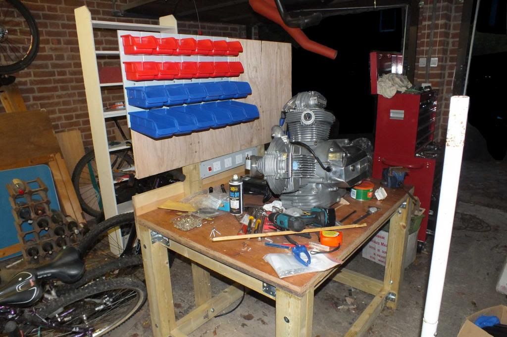

Wow! I managed to fit the Malossi manifold heat barrier & manifold.
But it does give me an excuse to show off my shelving and powerpoints now attached to my workbench. Just the tongue & groove to give me a lower shelf and it's pretty much done. My garage is my shed ;-)

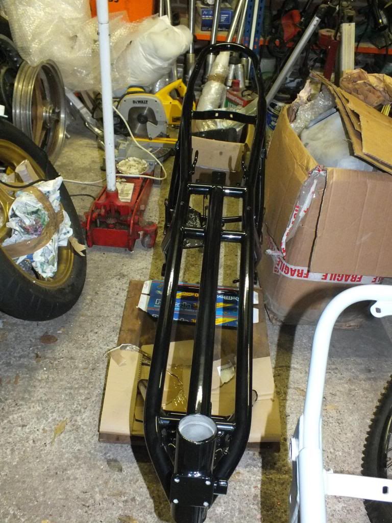

Dropped the frame & brackets in for stoving today at Vulcan Stove Enamelling Ltd, will be buying new tyres so I can skid off on the first corner (only joking I hope!) and it is all looking very exciting again.

Frame(s) and all brackets now back from Vulcan Stove Enamelling.

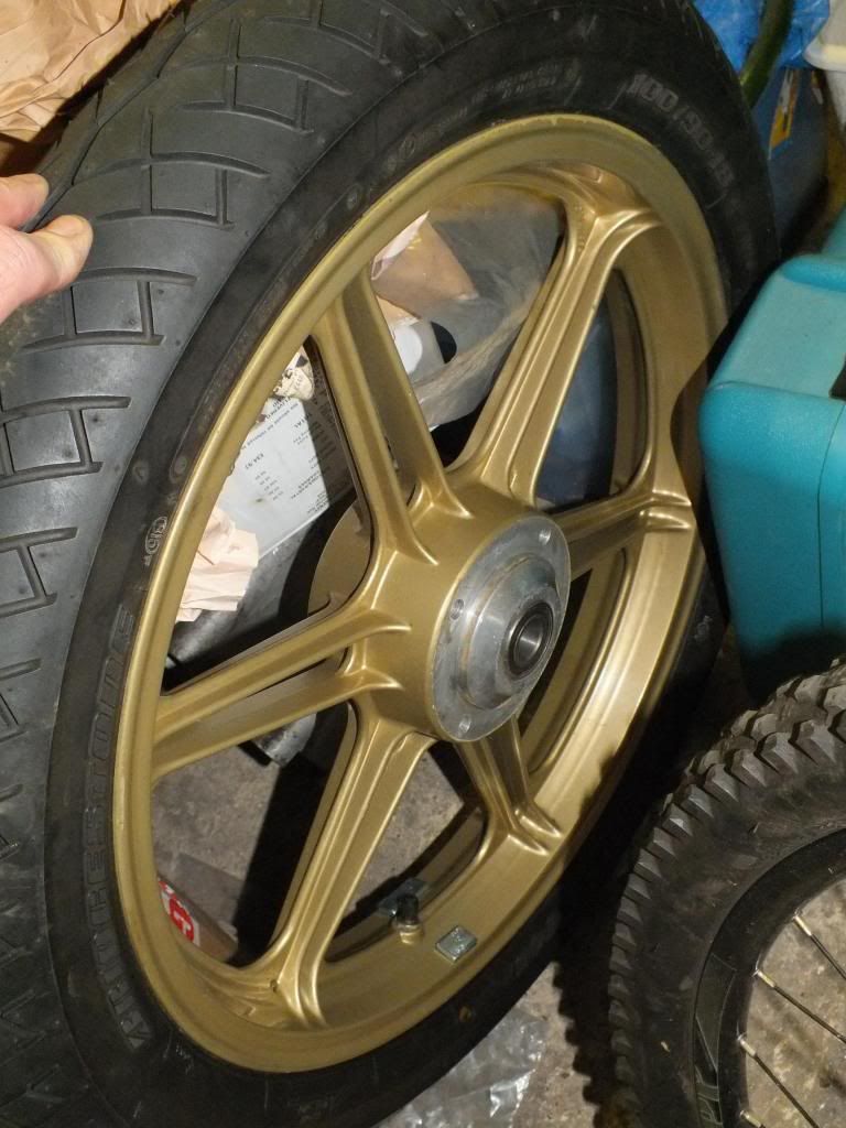

Had the FPS wheels refurbished too, and had the tyres put back on. Here is the front:-
and rear...

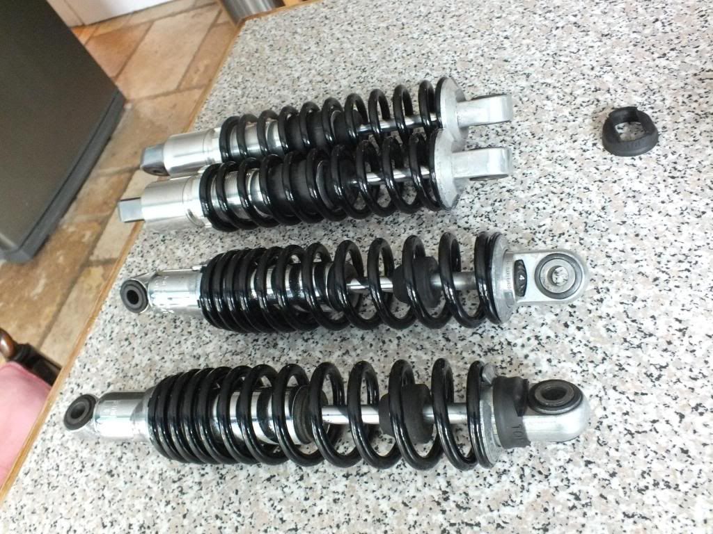

I am not quite sure which shock to use. Sadly my Marzocchi ET85's did not make it; They were zero milers that had sat on the bike for twenty five years. One was perfect but one shaft rusted & pitted. My attempts to save it failed so I am looking for a good ET85 for spares.
I do have fantastic Fontanas and Kharmic Koni's. The Fontana's were in lovely condition (read: zero miles, 25 years old stored carefully) but had signature red springs like this:-
The Koni's are in absolutely perfect super smooth working order but had been left a bit too long:-
With a bit of elbow grease and re-finished springs, here are the dial-a-rides & Fontana's now:-
Which do you think are best of the rest for the SS? I am angling towards the Koni's; I am thinking I'll stick the Fontana's on my GTS still under wraps and comprehensively in bits.

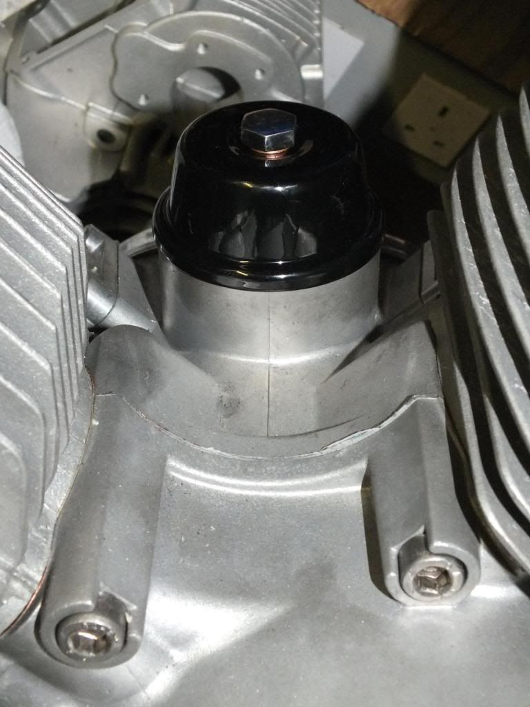

One really nice surprise was the quality of the black paint on the oil filter cover, quietly hiding the monster oil pump/invisible full flow conversion...

Lovely stuff. I think the Konis are tricker.
I always wanted a set of Koni's; Without the springs their action is really smooth & controlled - not that my biceps are much of a test.
I have had several sets of Fontana's, made by an old retired boy somewhere in Italy and they are *beautifully* made, completely indestructible but repairable if needs be.

If you want the old shocks refurbed you could ask Falcon.
They rebuilt my 907 monoshock including making new damper rod & snubbers.
Thanks ShedBob,
I have called Falcon, after a chat they wanted to sell me some of their own shocks which I am sure are much better; However they were missing the point in that I would have liked to have enjoyed the benefit of my brand new (but shagged) ET85's as they are OEM.
The ET85's are not in the same league as either modern Falcon's, Fontana's or the well tasty & British QRS's, or Koni/Ikons; However they are standard equipment and quite functional as long as you don't mind riding a bedstead.

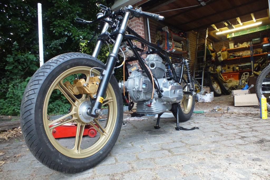

Next job was fit the yokes, forks & front wheel so the bike is stable.
Here is the engine installed..
And a close up of the just refinished fork yokes...
Another shot from the front nearside...

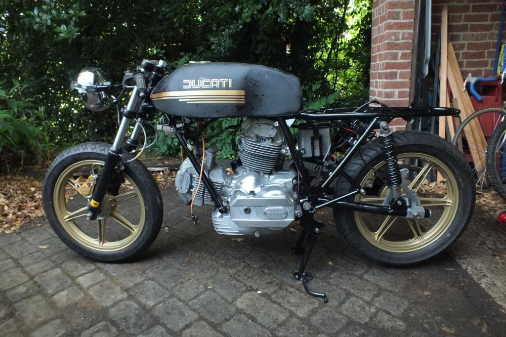

Weekend's Progress...
Made blindin' progress on Saturday, only to realise I had installed the forks without installing the clip-ons. Hey Ho. Got up on Sunday morning at 5:00 and rectified that problem so I was back where I should have been on Saturday night.
Spent time clearing out the threads, with the best will in the world and careful masking, some grinding residue is left behind.
Joules , a good mate of mine poled up at around 13:00 and we cracked on; He was very helpful pointing out the mistakes I had already made '...Errrr, will you be able to get that swinging arm pinch bolt in now the engine is in the frame?'. The answer was no, not without loosening the front & top engine mounts and rotating the engine whilst supported with a trolley jack.
The good news was that we continued to make mistakes together and after several assembly/disassembly's managed to fit the swinging arm, together with the crankcase protector and upper Delrin swinging arm protector...
Followed reasonable swiftly by the Konis' & rear wheel.
I finished off with the calipers...

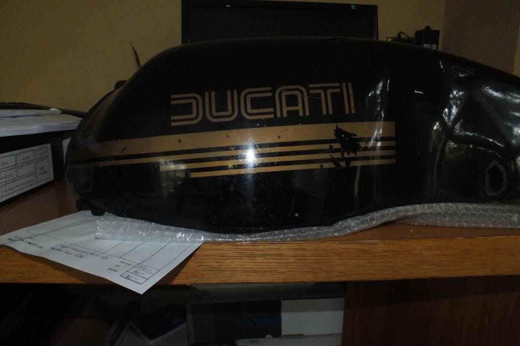

The plan was to get the bike on both wheels so I could get it across to the guy painting the tank so he could apply the stickers at the correct angle rather than shooting for the stars as per last time. We Popped 'round to see Jan-Willem who kindly offered to take the bike on his trailer to the painter's, but I am still pigged off about the Cape Canaveral tank stickers from last time and have decided sticking the bike on a trailer is way too much to ask Jan Willem and indeed to do myself.
So I will do the stickers myself and if I make a mistake, it will cost me a set of stickers. The painter does not see the grossly incorrectly applied stickers as his problem so we don't see eye to eye on that one.

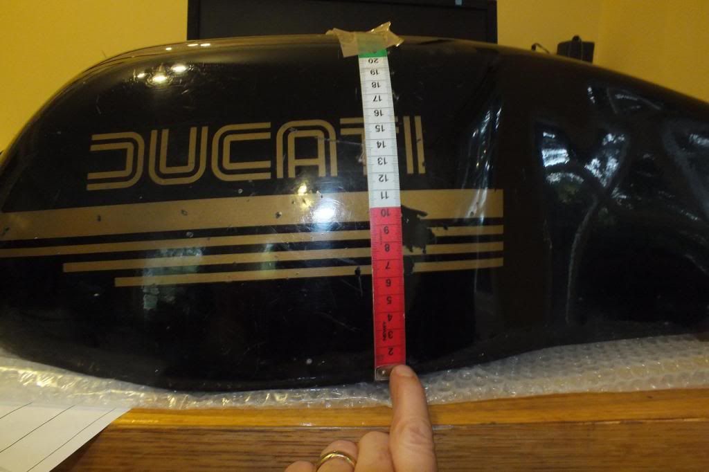

Here it is, last years doomed rebuild showing great quality paintwork, rubbish decal positioning...
And here is an original tank, which Pietro kindly let me measure...
and...
and...
I think I can see what he did, matched the top of the letters to the curve as the tank rises from the back-> front. Looks pants, all work ruined. Interestingly he showed me his portfolio which contained a 900SS perfectly done and his sales pitch was 'you get what you pay for and you wouldn't want the whole job ruined for the sake of a few quid'. I rest my case m'Lud.
Decals in place...
Not much done today, working.
The painter had prepared the tank, cut it back and removed the old stickers; I have placed the stickers and IMO the bike now looks correct.
I do have a few bubbles so I am going to give it back to him and see if he can improve & use it. At least he'll know where to put the stickers even if I have to buy yet another set.
and here is what the painter did first time round, you decide which is correct.
