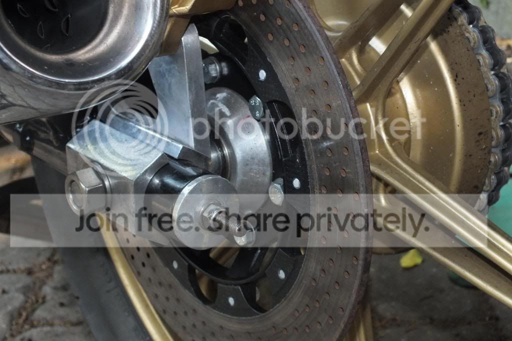

Sort out the rear disc with new high tensile bolts

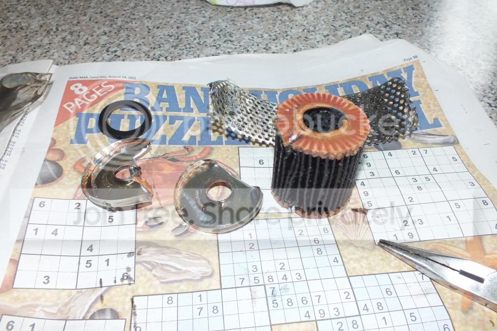

  8. High capacity Mario Sassi oil pump & invisible full flow conversion with neodymium ring magnet under the filter
  9. replaced mainshaft, sleeve gear, fifth gear, polished selector forks
  10. every roller bearing in the engine replaced including self aligning & gearbox needle rollers
  11. Tony Brancato steel gauze primary oil filter & neodymium magnet, Tony Brancato dipstick with neodymium magnet

I have been filtering my oil changes through a sieve and dismantling and inspecting the contents of the oil filter; No horrible finds there thank goodness. I must admit, I was quite nervous about a/ looking and b/ sharing what I found; But Hey ho, here we go.
Tearing down the filter...
The paper element is about 0.8m long when unraveled! The Sudoku puzzle isn't an intentional visual reference to Winston's observation.
Filter #1: Motor started for the first time containing flushing oil. The engine was run for 15 minutes and then changed whilst still very hot. I used one of my two into ones to make it quicker to remove the exhaust system to get at the sump plug.
I really hope the picture shows that there *are* small metal particles trapped in the filter. They are visible to the naked eye and I hope you can see them in the following picture.
The good news is they are trapped in the filter and not happily running around the engine scoring things as they would be in a normal bevel engine. As you can imagine, I was intensely curious to see the contents of the filter at the next change.
Filter #2: Oil change at 200 miles after my visit to the V Twin rally. FX: Phew! Whilst the filter is darkened presumably with clutch and combustion deposits, there were only two particles I could see and they were truly miniscule. You might see a speck on the middle left on the second corrugation from the left and middle right on the fourth corrugation from the right. Again, they are nestling in the filter rather than being recirculated.
