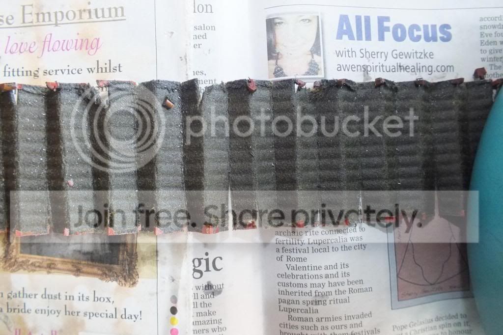

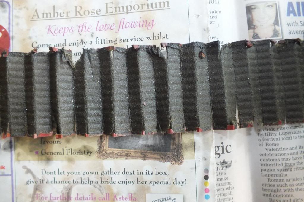

I passed the magical 1,600 mile mark about 1 1/2 weeks ago and did the big oil change on Sunday. Having to remove the vertical downpipe & LH Conti is a pain! Ducati could have put in a nice little bend in the downpipe so that the oil could be changed, but that would have been too easy. I ran the motor in with Morris V Twin 20w/50; I bought a 25 litre drum which seemed the most cost effective way of buying it. The motor is now full of £85 worth of AMSOil 20-50; After changing the filter, removing the plugs, removing the crankshaft end plug priming the engine until it squirted out of the crankshaft end inspection hole, I started the engine and I was surprised that it *did* sound different - smoother, quieter. All good so far.
This oil had done about 1,100 miles and I was intensely curious how things were settling in so no one will be surprised that I drained the oil through our flour sifter and then dismantled the oil filter to inspect what had come adrift in the last part of running in.
The good news is there was *absolutely nothing* captured in the sifter from oil from the sump. There was *zip* in the gauze oil filter & magnet. There was *nada* on the oil dipstick magnet - all clean & shiny! There was the thinnest patina on the ring magnet under the filter. I would have shown this but I dropped it in the dust which didn't help.
I was quite excited at this point (I have a quiet life) and dismantled the filter which doesn't take long. There were some small particles but the good news is that is where they stayed.
Picture 1
Picture 2
Picture 3
All in all, I am very pleased.
One annoyance I will pass on is that I wish I hadn't first run the engine with flushing oil; The 15 minutes off load running may well have cleaned out reassembly flotsam but it also coated the wet clutch in goodness knows what friction modifiers. The clutch *never* slipped prior to the rebuild - it had new plates, springs and a NOS clutch centre. After the rebuild/flushing, even under light load running in the clutch could slip. As running in has progressed and I have slowly built up the load & revs, at each oil change the clutch has improved.
Now the engine is run in, once I have done a full gentle 10 miles to warm it through, I can give it the beans and it *mostly* holds. A bump will see it lose grip. I will see how it is now it contains Mr. Bloody Expensive Fabulous Oil.
So my advice is don't use oil which might contain friction modifiers!

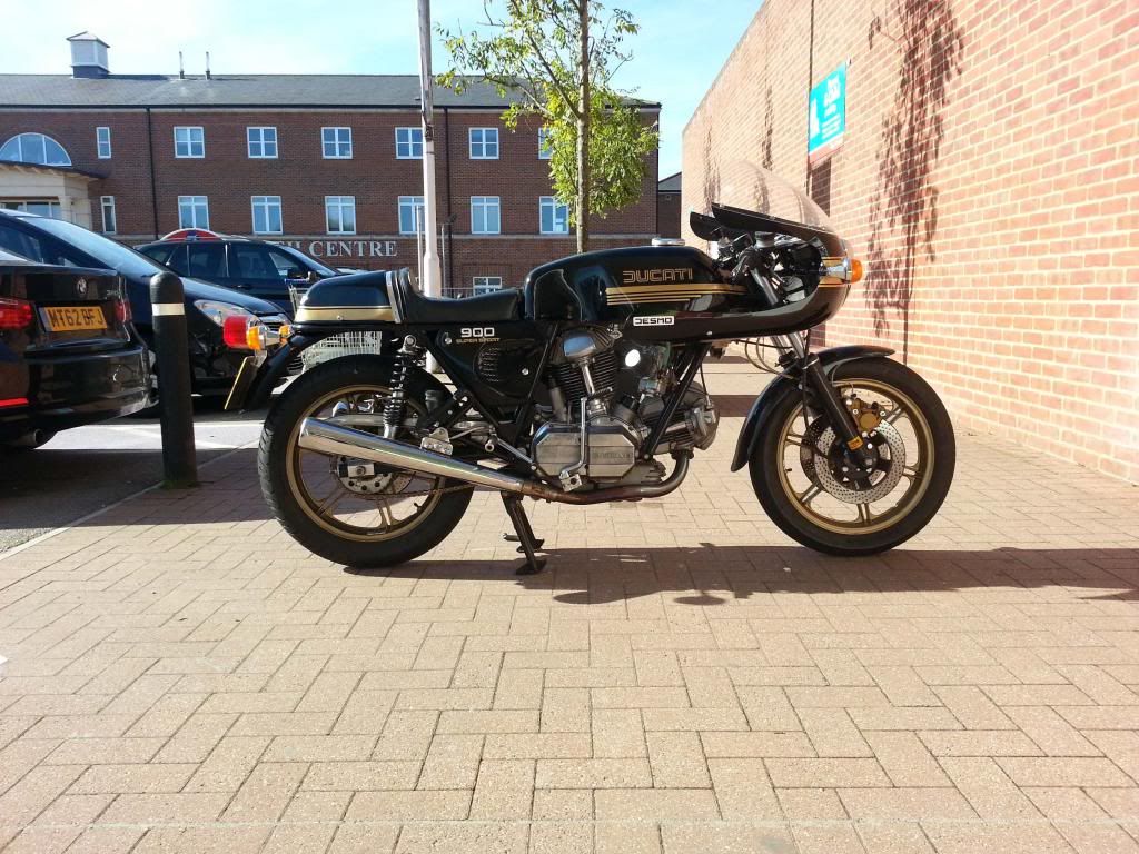

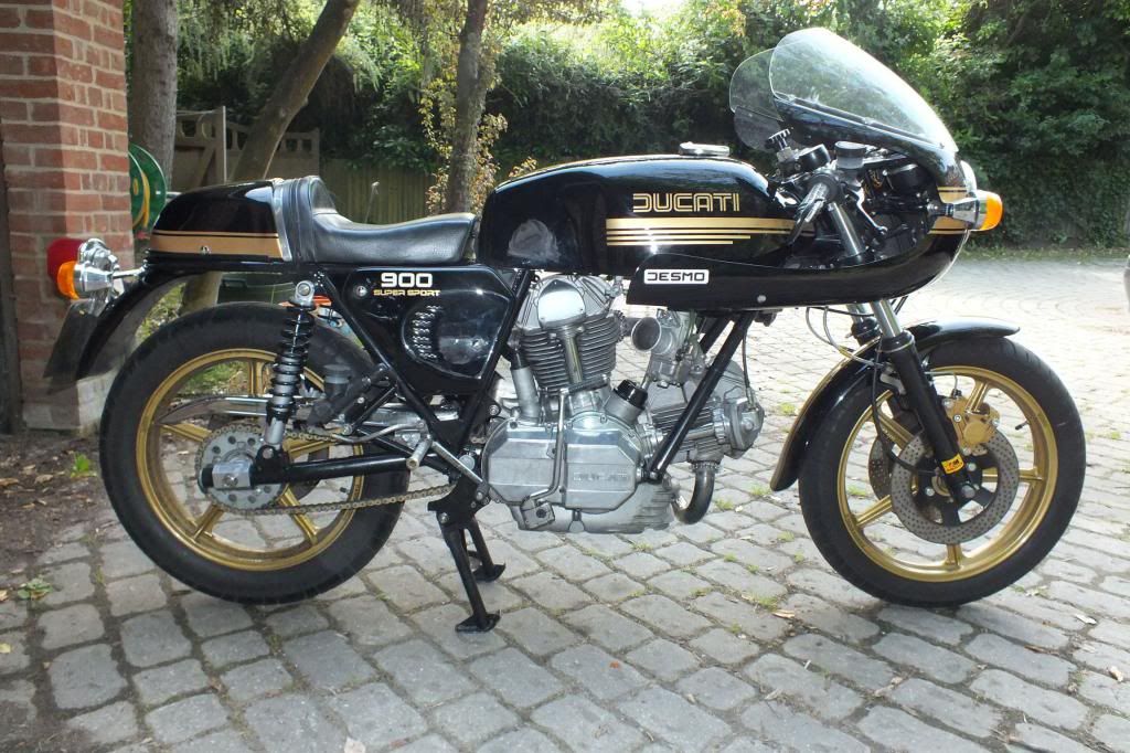

Here she is outside Tesco's at Pulborough...

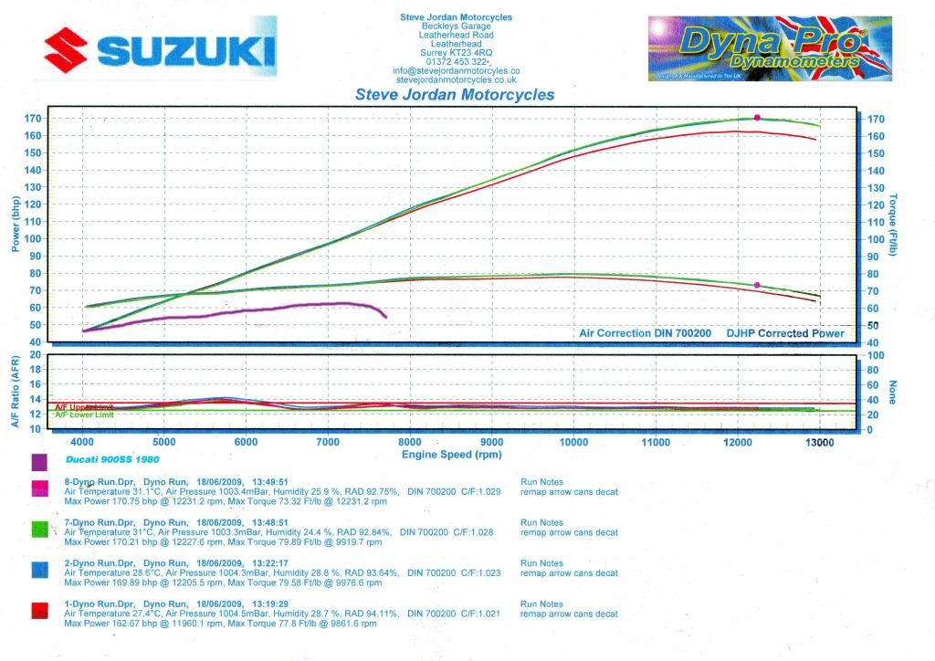

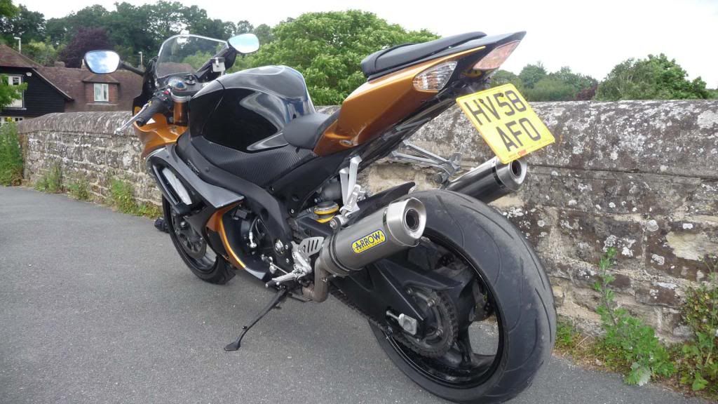

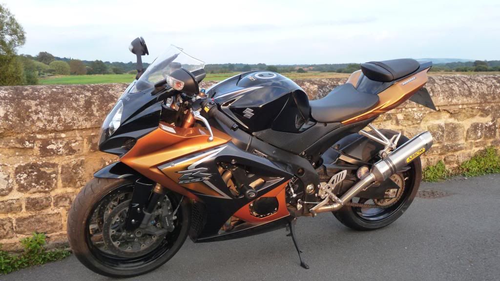

For your amusement, below is the rolling road test of before & after remapping my Gixer K8 after de-cat'ing it and taking into account the Arrow exhausts. I have superimposed the power curve of the SS on the graph - it is that little purple squiggle at the bottom left. How far have things come? ;-)
To make things worse, The Gixer figures are at the back wheel - I think the Ducati figures are at the crank. Wow.

Your 900SS looks cracking. Well done. I don't think Ducati quoted bhp figures for the 900SS at the time. Mine was dynoed by one of the mags and put out 69bhp at the back wheel which would probably be about 75-77 at the crank.

The oil filter results are a testament to your work and the bike looks lovely outside Tescos or anywhere. BTW Paddy I've ridden some fast Harley's but it's all relative. I've never really got over my first ride on a Hayabusa.

Cooee! How exciting! I though the true figure was more like 65BHP at the crank. My figure was a guesstimate and I had always heard that due to the restricted breathing the Duke's were always down on quoted power, unlike Guzzi Le Mans which did what it said on the tin.
The only 'tuning mod' that mine has is that Tony Brancato gave the heads a mild gas flowing about 25 years ago. I didn't want anything extreme for reliability reasons. I have no idea what if anything that means in BHP.
Tuning ? don t get me started, its a kind of fetish i have :)
What i would say is any real increase in power on a bevel will shorten its engine life considerably unless its a milli.

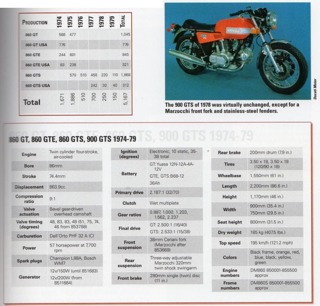

Re 900gts
looking at photo and reference to S/S Fender and Marzocchi forks for 1978
Does this mean there is only 220 and 30 in the USA
As i believe the 150 1978 models are the new bottom end
I think so. The figures neglected to mention the 900GTS - and they vary so much. The DSOTM didn't even have holes drilled for the side badges, it had transfers instead. Some have transfers on the tank instead of badges too - although both mine & Derek's have tank badges. they vary quite a lot and there are some 'unfortunate' colour schemes:-

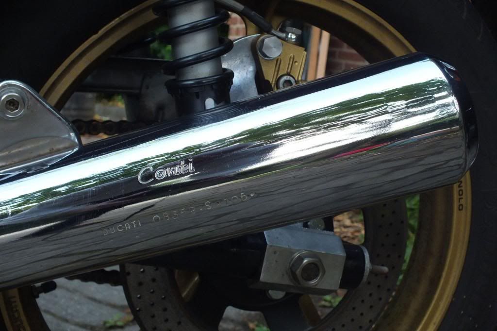

Proper downpipes Request!
I have never ending problems getting my downtubes on after changing the oil without damaging the (very fine 1mm pitch) exhaust threads. The last attempt resulted in the pipes not locating correctly and it started popping on the overrun.
Enough of that! I have stuck on my 2 into 1 Conti system which is a beautiful easy perfect fit - but doesn't look or sound as good.
Decide for yourself!
Look! No pipe!
... and the pipe itself...
I'd really like a standard set of downtubes and I don't mind if they are manky - I can get them re-chromed.
