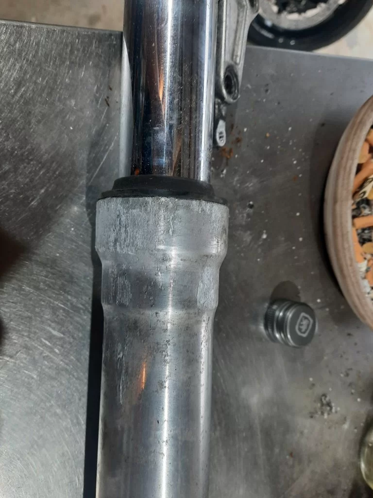

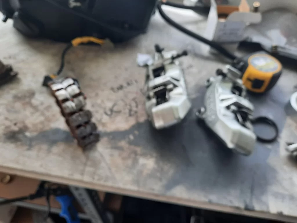

It's just the lacquer lifting isn't it, strip it off polish them up then scotchbright them radially?...
No, the corrosion has eaten into em pretty bad..a good few mm deep in places..It's just the lacquer lifting isn't it, strip it off polish them up then scotchbright them radially?...
PooNo, the corrosion has eaten into em pretty bad..a good few mm deep in places..
Nufin else to do. .Also, stop chewing on your fork legs, ya dumb yokel.

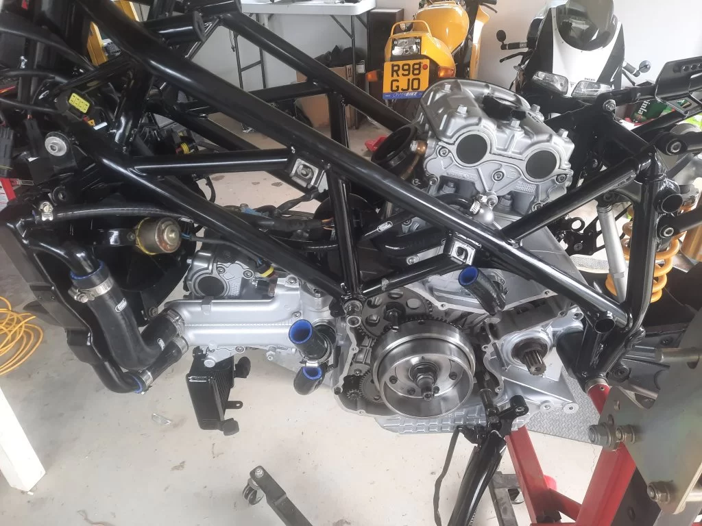

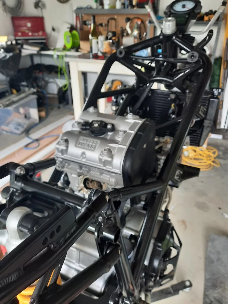

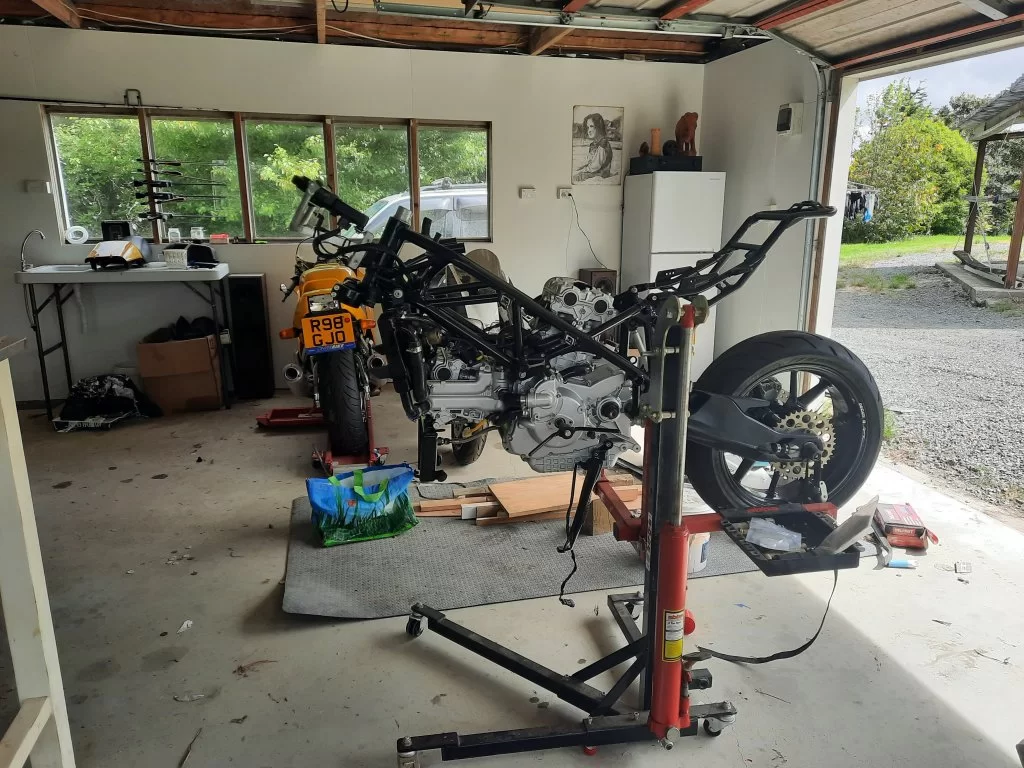

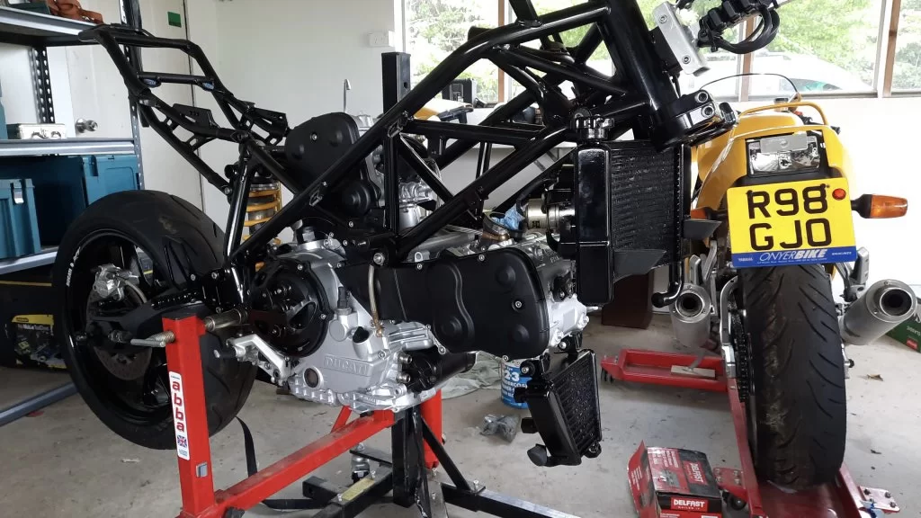

Holly crapscicles! Fucken well done @The GOAT !!!!!! Ive only just seen this!!!!@Chizel - Founding Father you now have your own build thread about the 749![]()

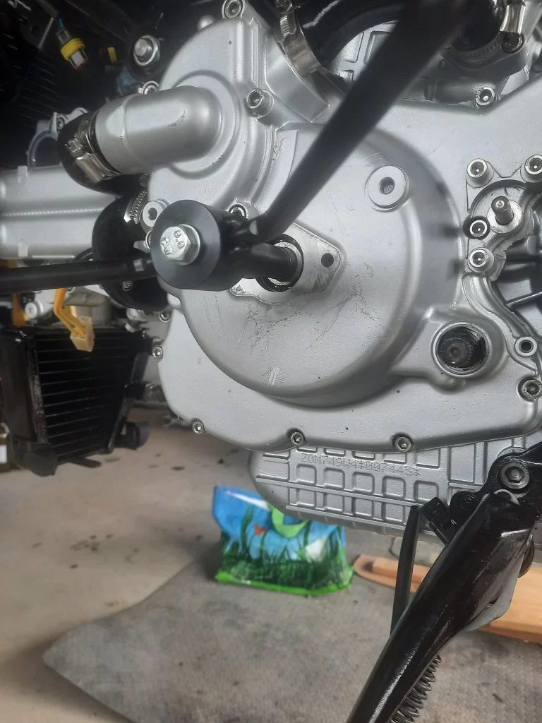

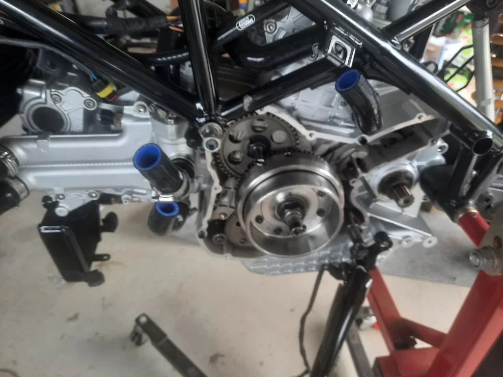

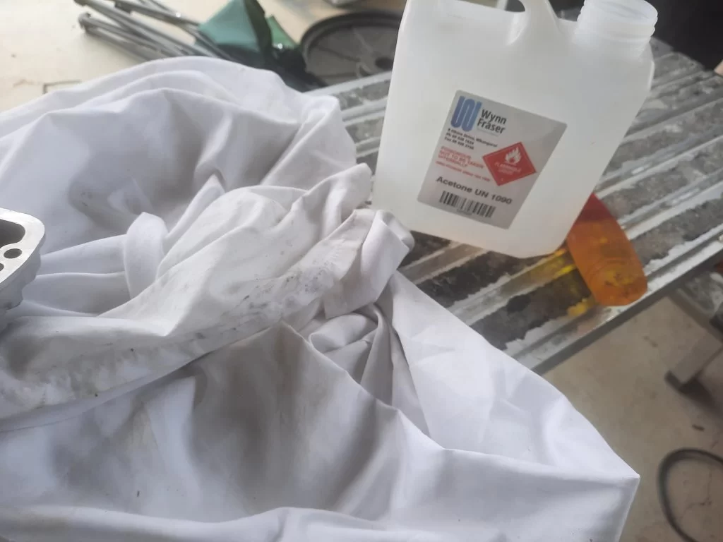

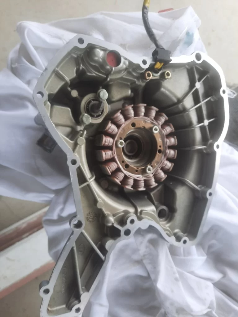

It's a great solvent acetone. Did you know you need a license to buy it in the UK?See the damage to the paint on the alternator cover? I used acetone to clean the mating surfaces before applying the silicon gasket..
Not wanting to scratch the nice new paint on the alt cover, i laid it on a cloth whilst i fitted the stator and applied the sealant..
Great idea but i must have spilled some acetone on the cloth..
It dont seem to hurt the paint if just wiping down with it, but it seems if soaking in it, it does!!!
No biggy, just a bit of a pita...
There might be some wealthy friends on this very forum who can gift you some forks which they have lying around?Next up, i guess, is refit the manky forks..
Its breaking my heart as its not how i roll but i cant see a practical cheap solution and i simply dont have the disposable coin to splash out atm..

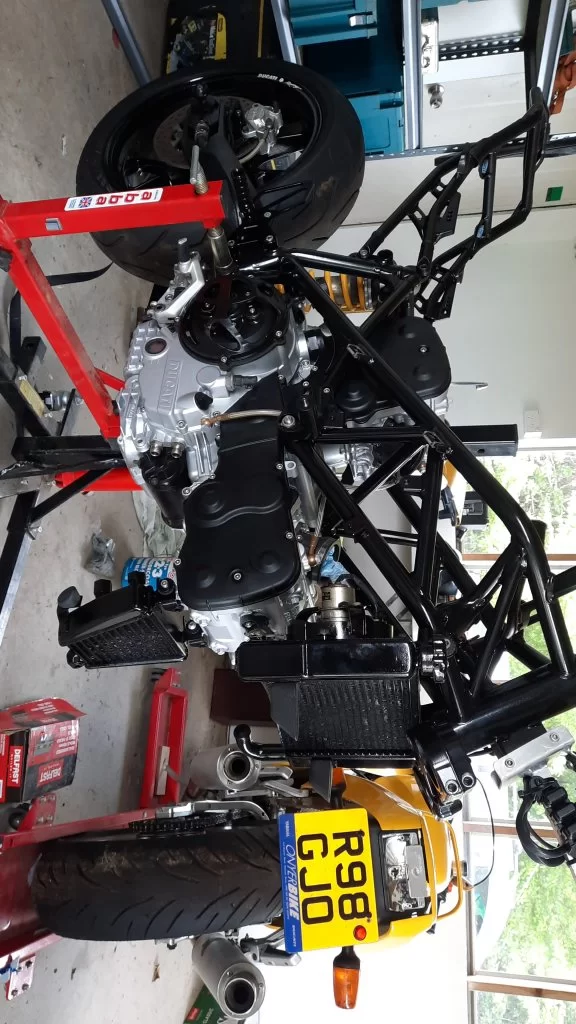

Im thinking, ( as much as it disgusts me!) Im just gunna have to fit em for now in order to move forward and deal with em at a later date...
So get them back on, then wiring, controls, airbox ect... if i was a normal person, i coukd probably have her fired up and rideable in 10 hours maybe?
