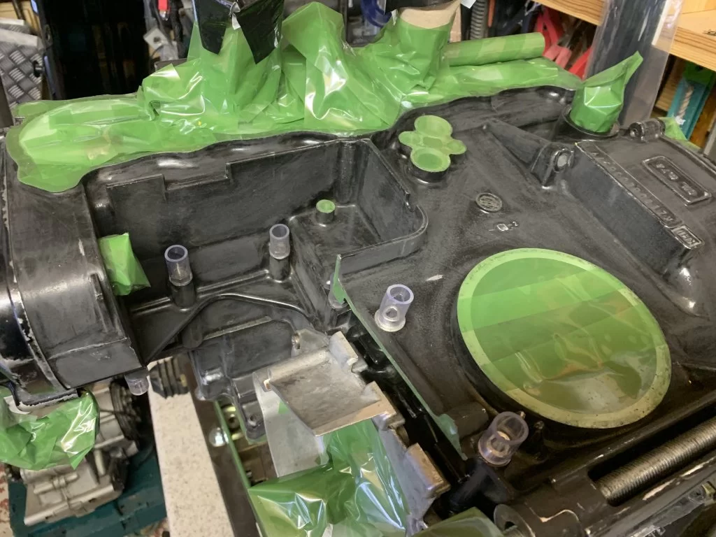

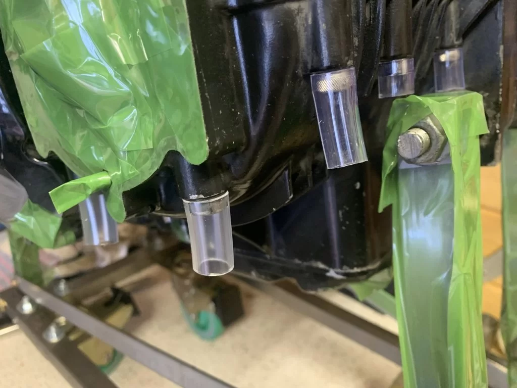

So at last, the first +20 deg C day is likely to be on Saturday so today I finished prepping the crank cases by keying the paint with 400 Wet & Dry. Then gave it a go with the airline to get rid of the dust. All that remains is a good wipe over with 100% Isopropanol wipes and it's all systems go - if the weather doesn't change........................ 👀

Personally, I'd give the engine no. a very fine coat and then mask over it when you paint the casings. :unsure:

The crank cases are pretty good on all visual faces so will be having a light coat anyway, other unseen areas where the alloy is showing in small areas will have a dusting of etch primer and a light coat of black. All the engine cases are only there to mask and will be blasted and clear cerakoted... the engine number stamping is very deep too.
