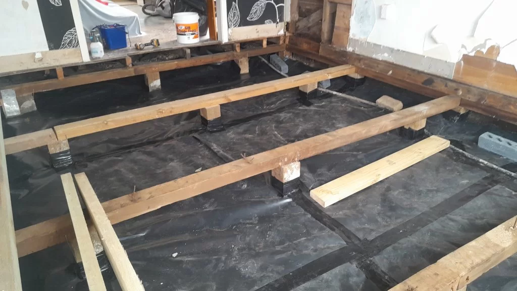

My empire of dirt...

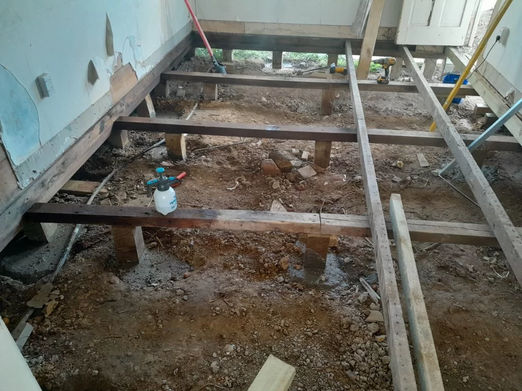

So I finally have all the piles in what will be our bedroom replaced.. also replaced one bearer that was a bit split and ugly.. have decided in this room to also replace the joists. It will make life alot easier for putting the membrane down and space the joist correctly for the insulation

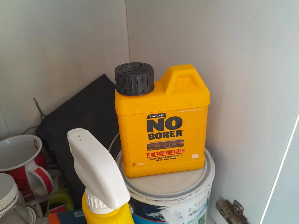

I've begun treating for bora, this is gunna cost way more than expected!!!! But it has to be done. For best results they recommend mixing treatment with turpentine so I'm doin that. Bit stinky but hopefully worth it.
Anyhu, coffee, then I'm onto it!!

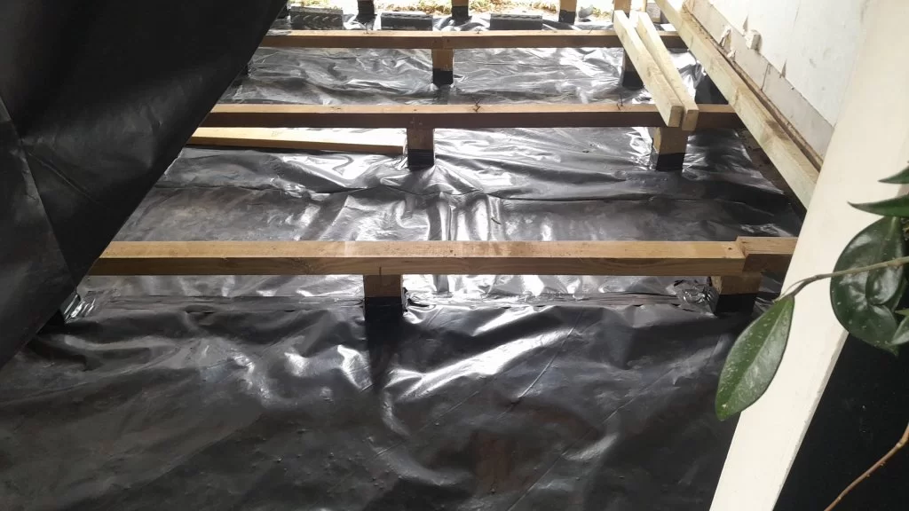

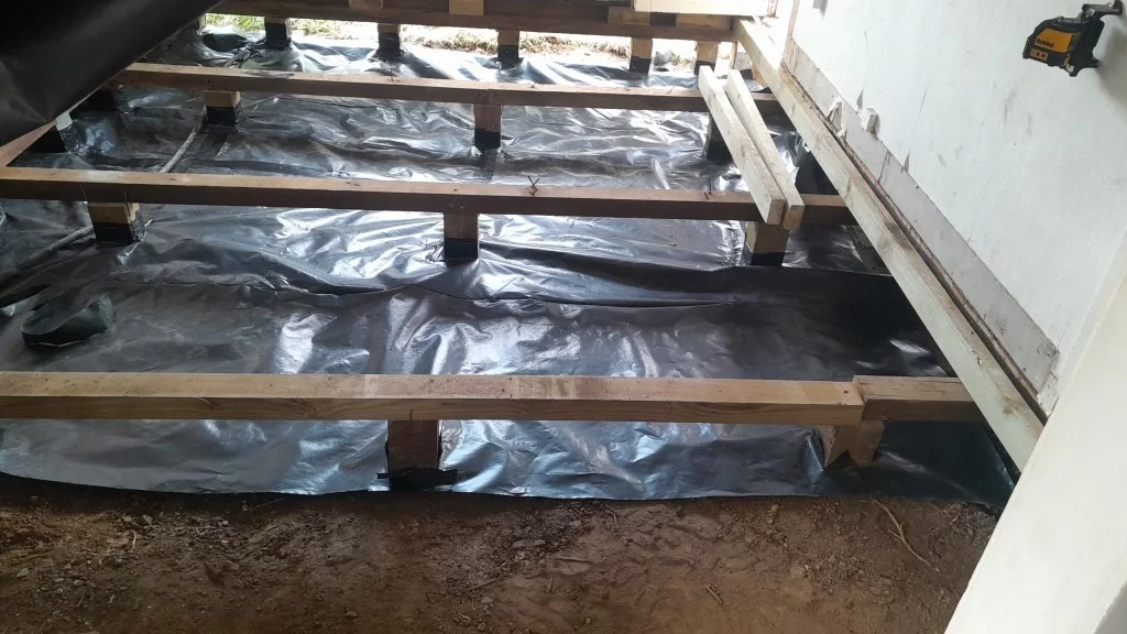

Yesterday I got the last of the joists removed, borer treatment done and cleared the ground then I got sidetracked.
Went to the pub for one at lunchtime, bad idea. A mate I'd not seen for sometime happened to be there so no more work got done!!!
Anyhu, I'm gunna smash it today I hope. Gunna put moisture barrier down after I sculpt the dirt a bit to ensure water cant run onto the plastic and cause problems..
Hopefully it goes well can then put new joists in and start on insulation.
Goal is to have the floor completed by end of weekend so next week I can frame out the door opening and move the contents of the bedroom and spare room in there..
Should be achievable..

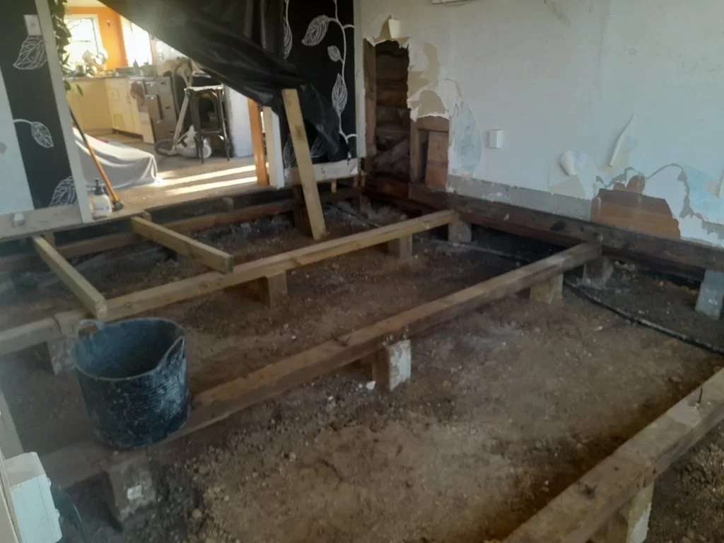

Some pics...

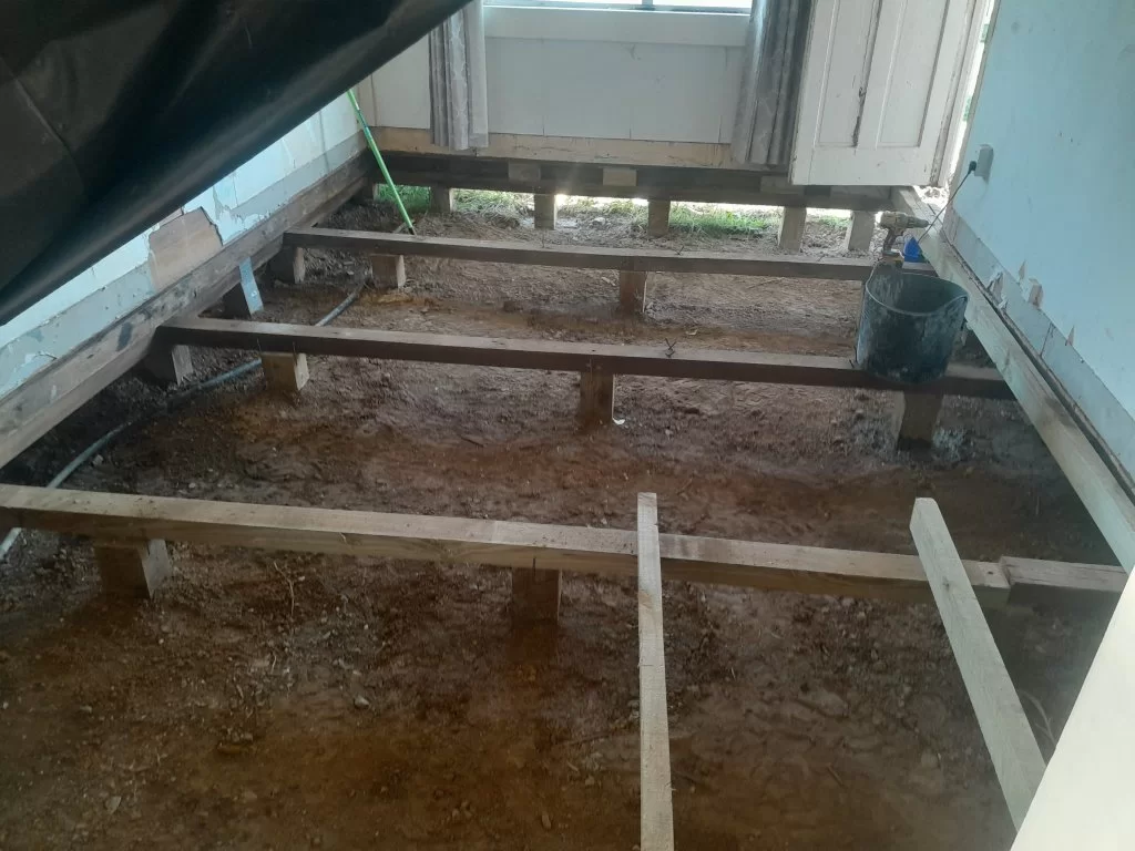

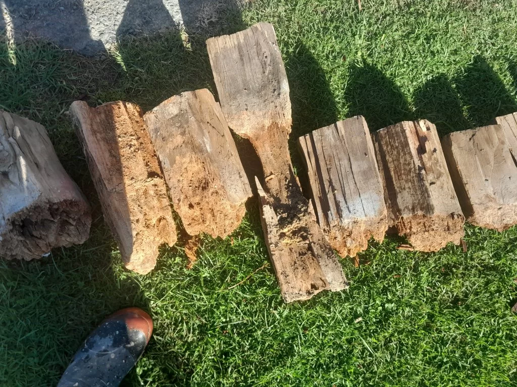

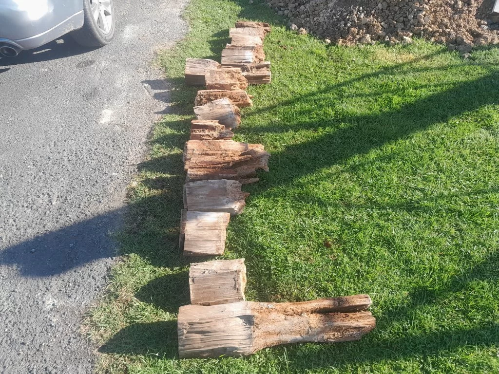

Look at the state of the old piles!!!

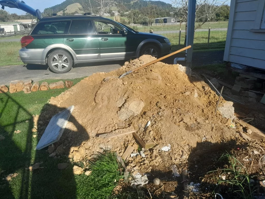

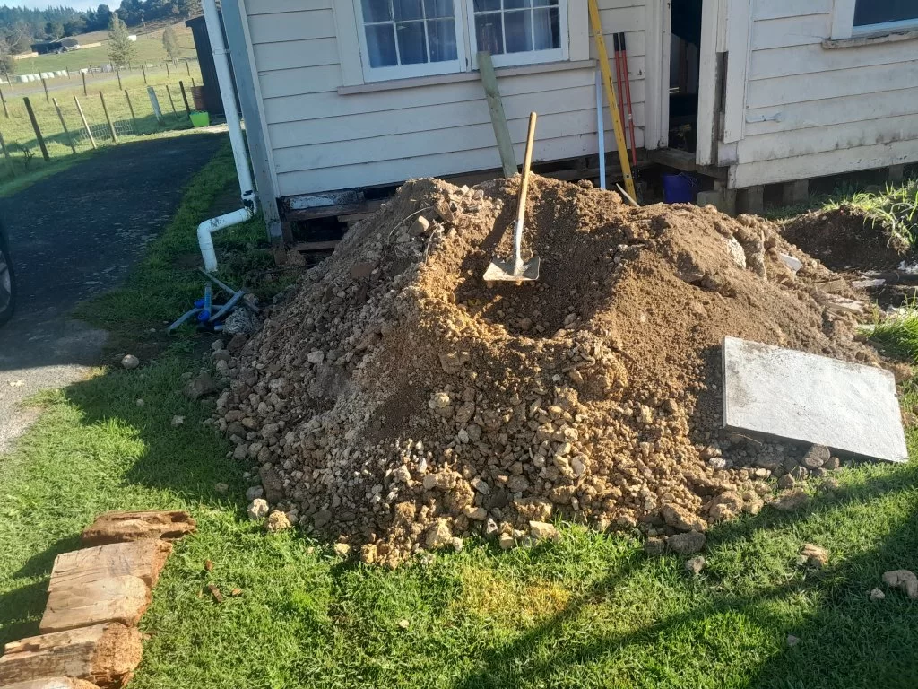

Pile of dirt from 1 room and a small bit of the ki
tchen!
Probably about 25% of what will come out by the end of repiling...
Pile of dirt from 1 room and a small bit of the kiView attachment 104308View attachment 104309View attachment 104310View attachment 104311View attachment 104312View attachment 104313tchen!

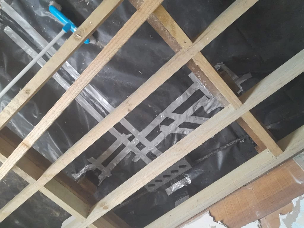

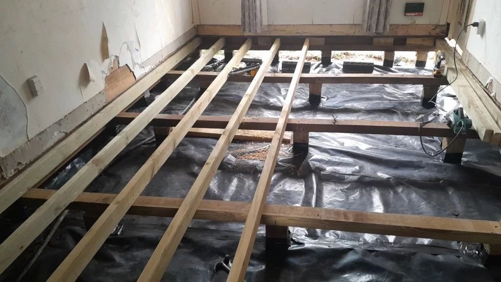

Yesterday I got the joists in and most of the nogs before I ran out of timber..
So we headed to town for more and to swap the insulation over.
Also picked up more tape as the stuff I used hadn't stuck so good. Was a bit surprised but this as it was expensive 90mm stuff and everything was dry and very clean.
Anyhu, I got some more expensive heavy duty highstickyness duct tape! Now I'm in the process of going down both sides of the original tape. Bit of a faff but it's got to be right or it's largely a waste of time..
Then it's put the last few nogs in and start insulation...
Not sure if I will have floor down today now but will be very close..

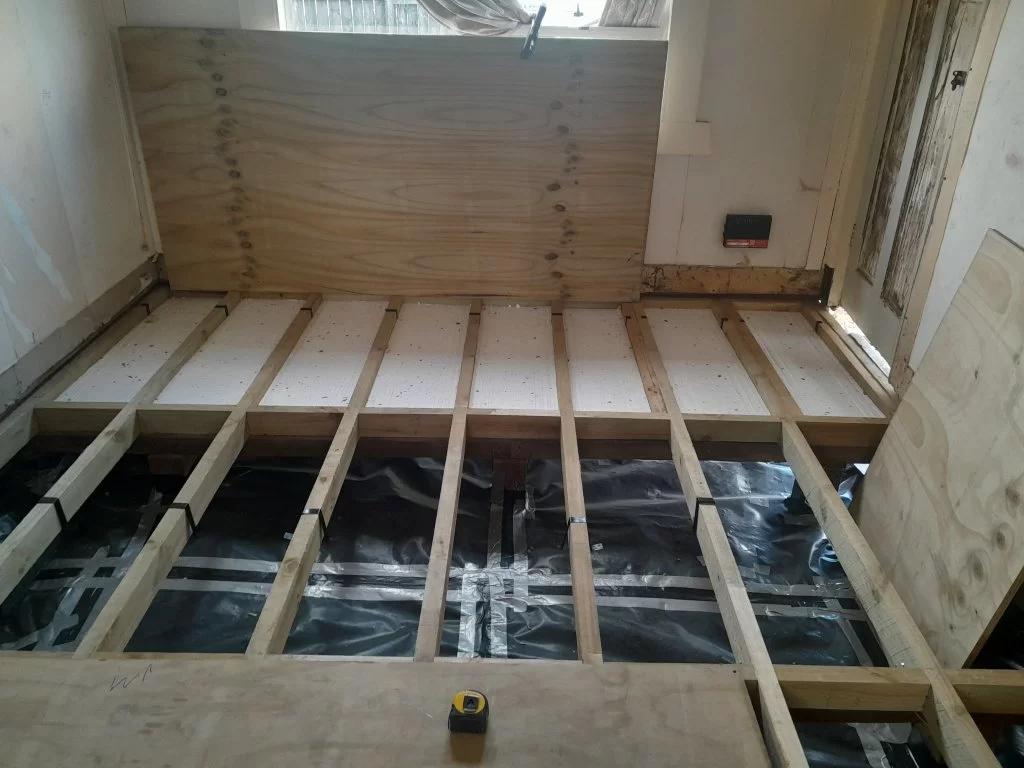

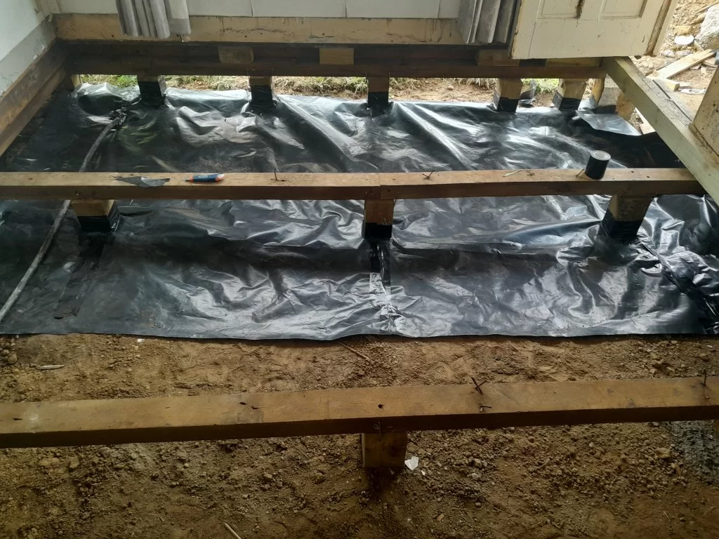

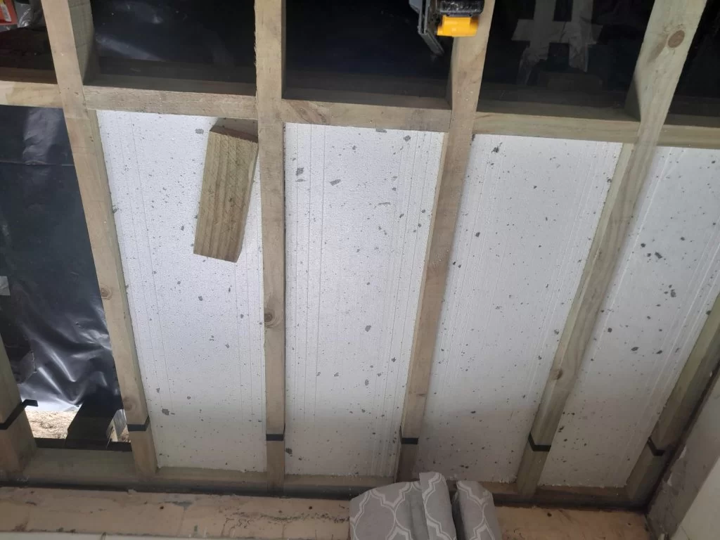

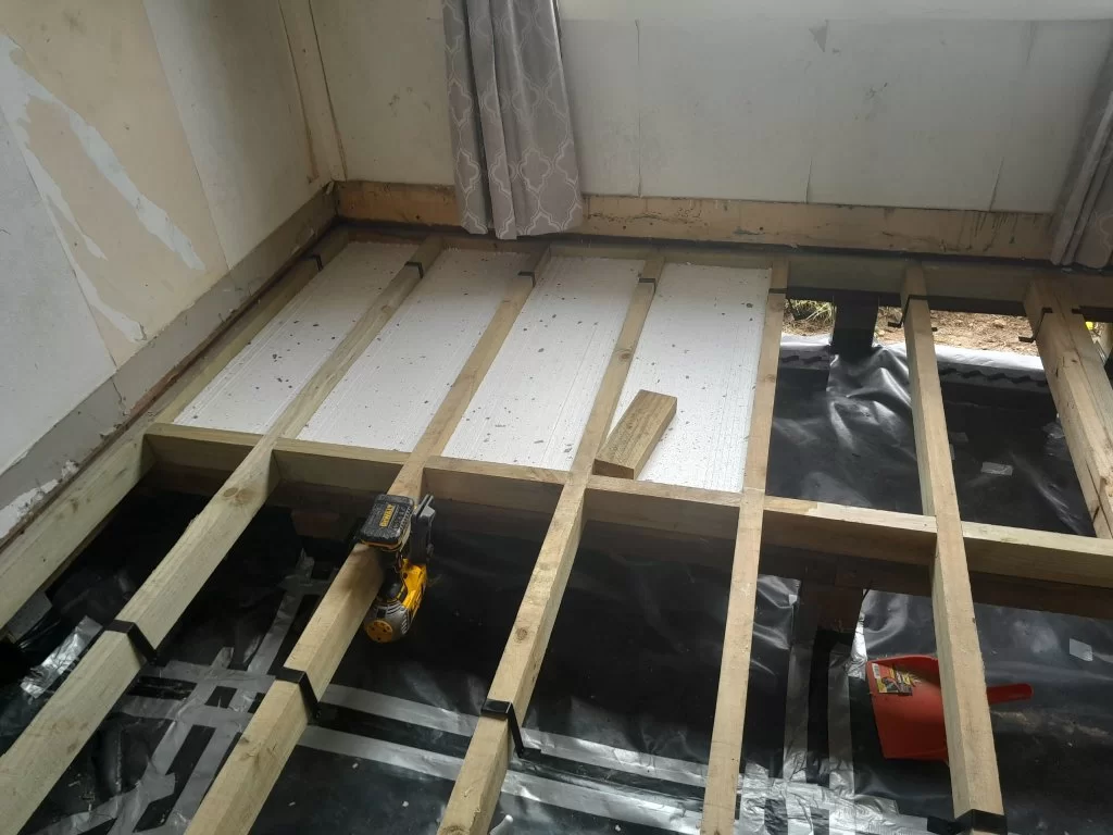

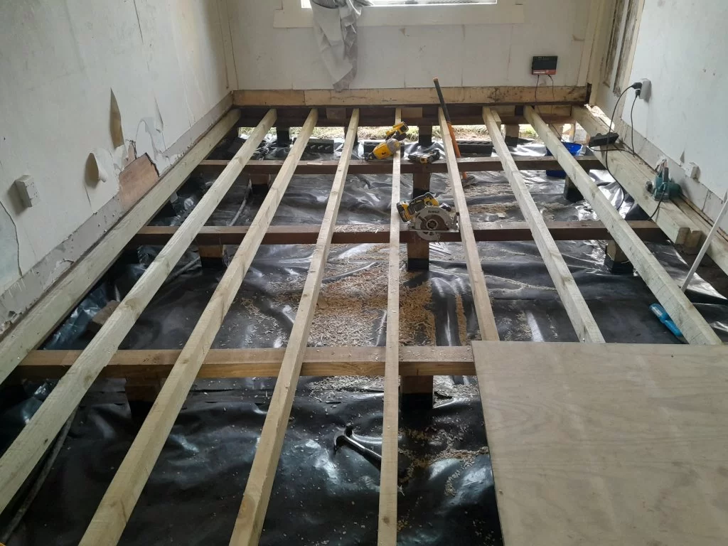

Insulation going in ..
It's a very snug fit.. the stuff I have is in 360 x 1200 sheets, the spaces between joists and nogs are 352 x 1150 so I have to cut sheets to length but they just squeeze in width wise as the have cuts sorta half way through on the edges to allow for a bit of compression.
I'm cutting em with a long craft knife blade rather than a saw in a bid to keep the mess down and its kinda working..

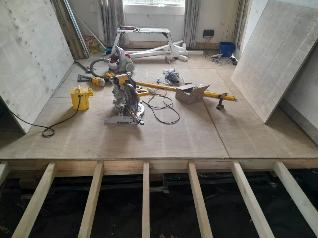

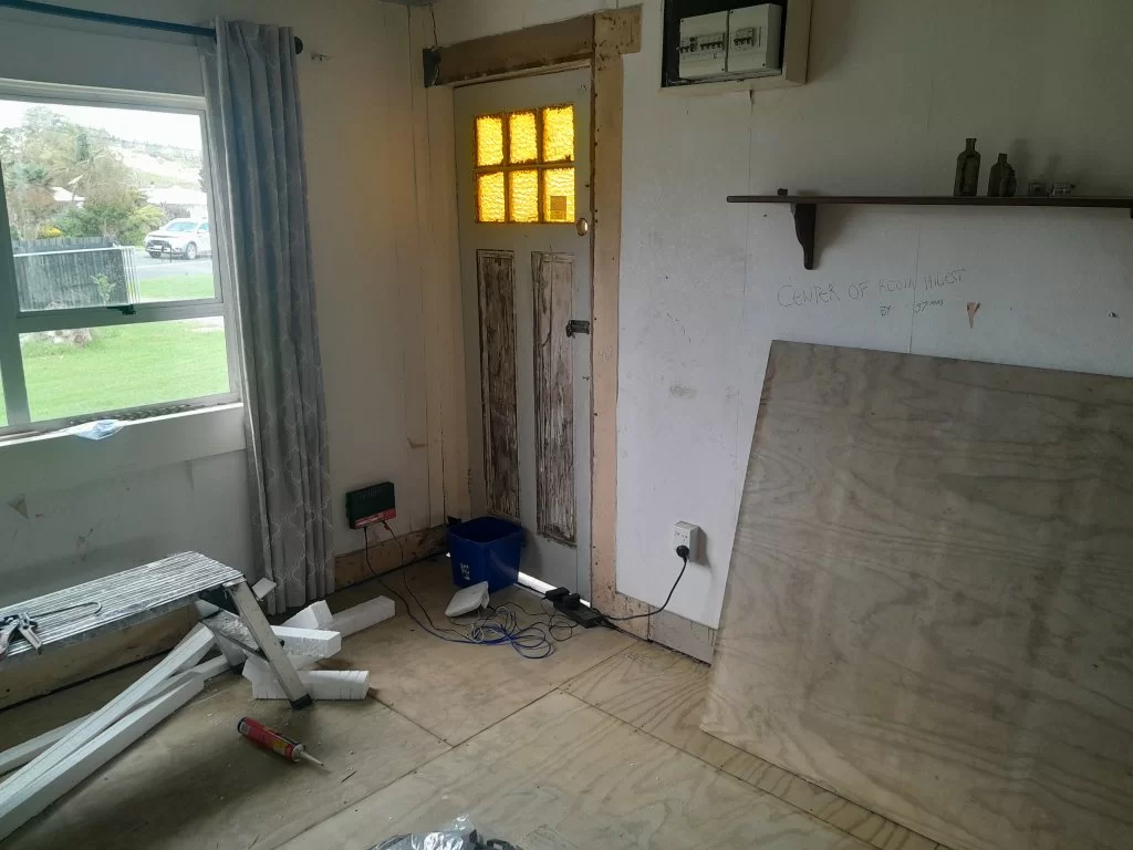

Floor nearly done... it will be done today!!!!
Had to go to town to get more screws, a length of timber, a sheet of ply for boarding up the old front door and some guttering ..
That wasted over 2 hours of my day but I'm cracking on now..
3/4 of floor done, just about to cut the last few nogs and can then finish as much as possible.
One half sheet of ply can only be temporary fixed as once I get into the next room I will need access as there is a section of bearer that runs into both rooms that needs replacing. All good as it is in the entrance so won't stop us moving camp..
We are off to auckland for the long weekend as of this Wednesday so progress will halt yet again..
Hopefully we can move rooms before we go so as to crack into the next room straight off the bat.....
