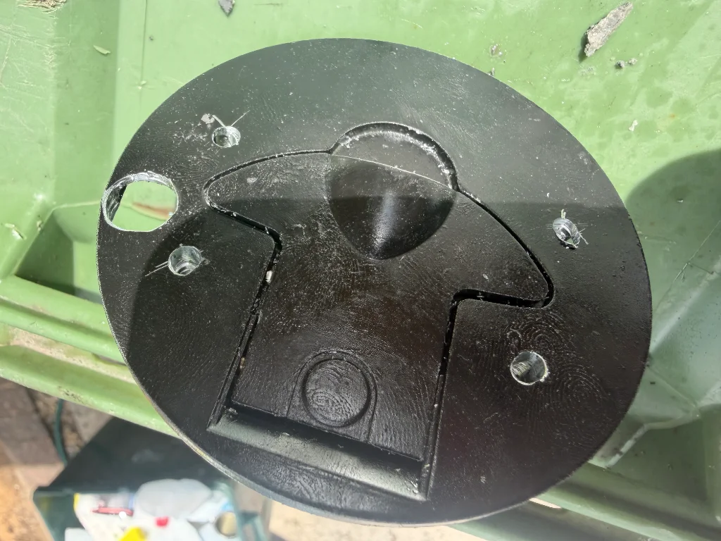

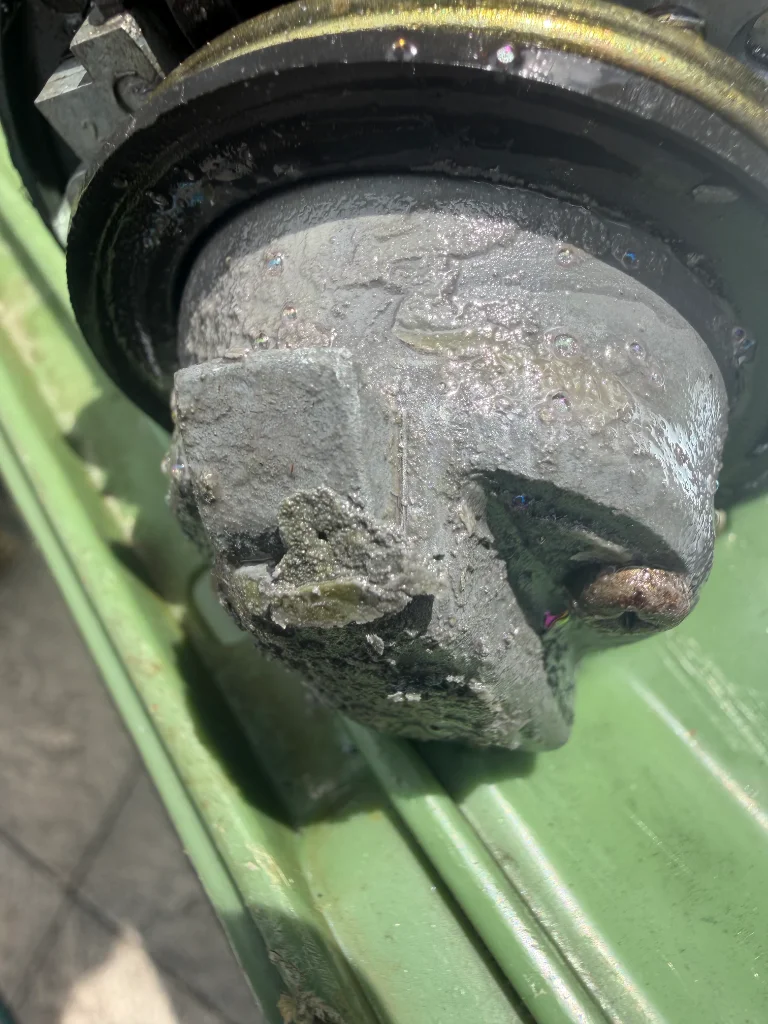

Finally managed to get the filler cap off the ZXR after a few attempts.
Fecking thing was stuck solid on the catch…
I tried spraying with release agent and taping with a rubber mallet (take note Wayne) and after a few attempts over a week I gave up.
A YouTube video showed a method where you take all the screws out, jack open the flap with plastic shim and with a watchmakers screw driver you tap the one security screw digging into the side of it to loosen it - then spin it out - didn’t work 🤷‍♂️

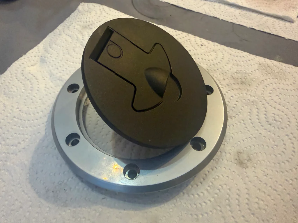

So having purchased a new OEM filler cap for a reasonable price from CMSNL when I bought the other bits I needed, I drilled through the old cap and removed the security screw.
Low and behold it still wouldn’t come out 😱
So 4 more strategic drillings above 4 more screws and finally it came off 🥳
This is what I found - in fact I’d already removed some of the crud before taking this picture…
Here’s my drillings…

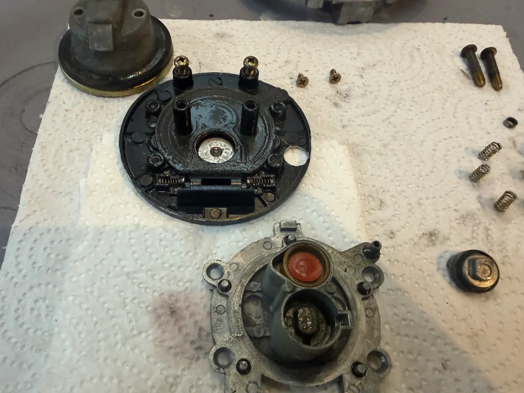

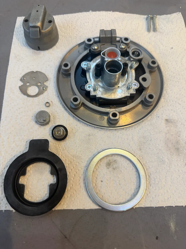

Tonight I fathomed out how to strip the lock barrel out of the old cap.
I had a bit of head scratching as the assembly design had changed 🤷‍♂️ but the old barrel still fitted…
Just got it all back together in time to watch today’s TT highlights on ITV4 at 10pm 🥵 and it’s not on 🤷‍♂️
What’s the rest of the tank insides like? Thst filler cap is horrendous. What is it? Corrosion? It looks like someone’s smeared a thick coat of 3Bond or JBWeld all over it.
Just fume deposits from 15 year old fuel on steel, rest of the tank is as new - old fuel hadn’t reacted with the alloy tank at all 🥳 not sure what modern fuel would have done…

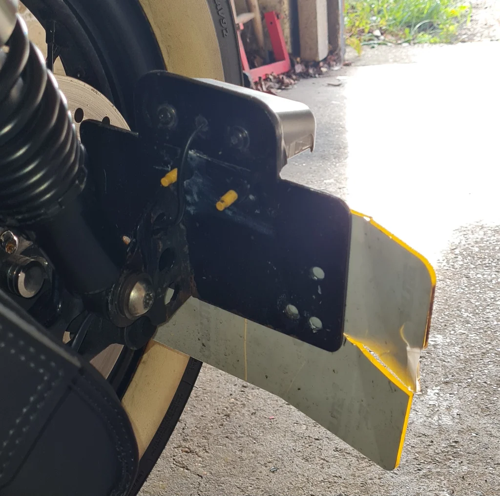

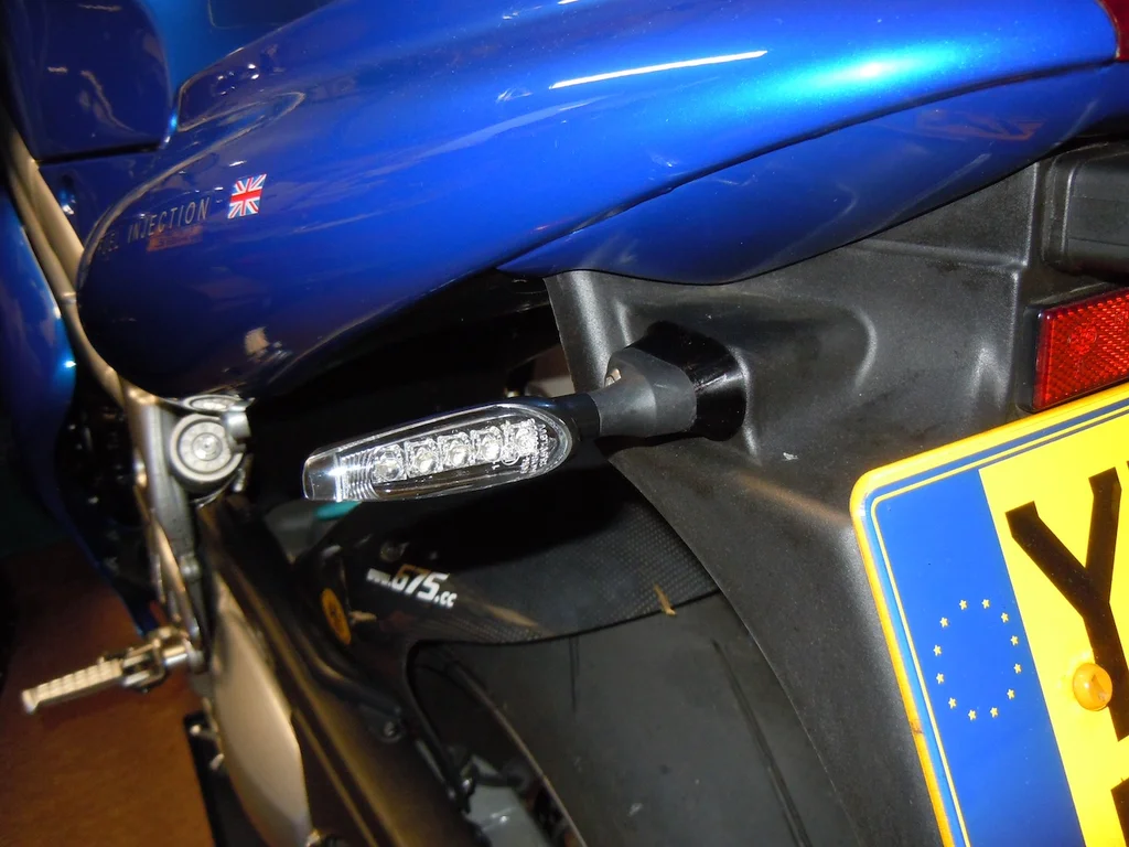

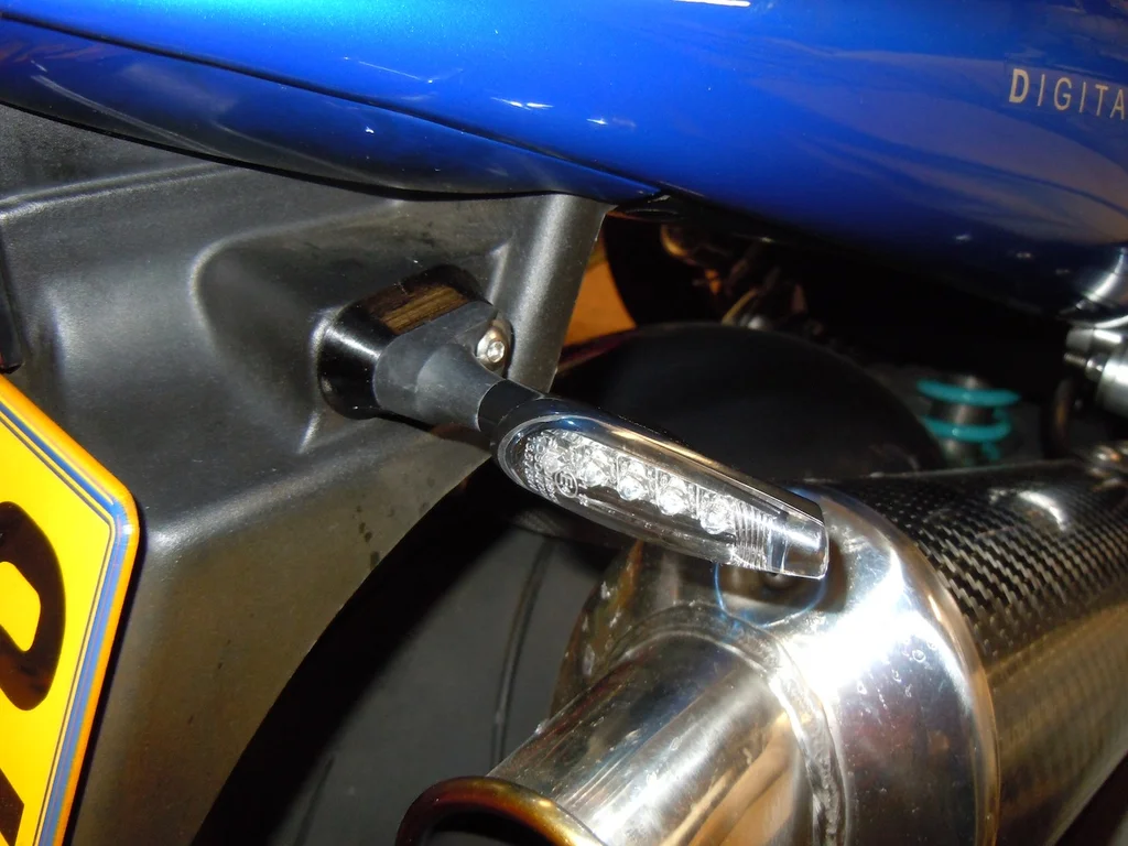

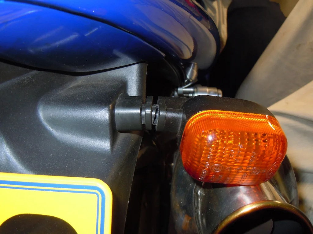

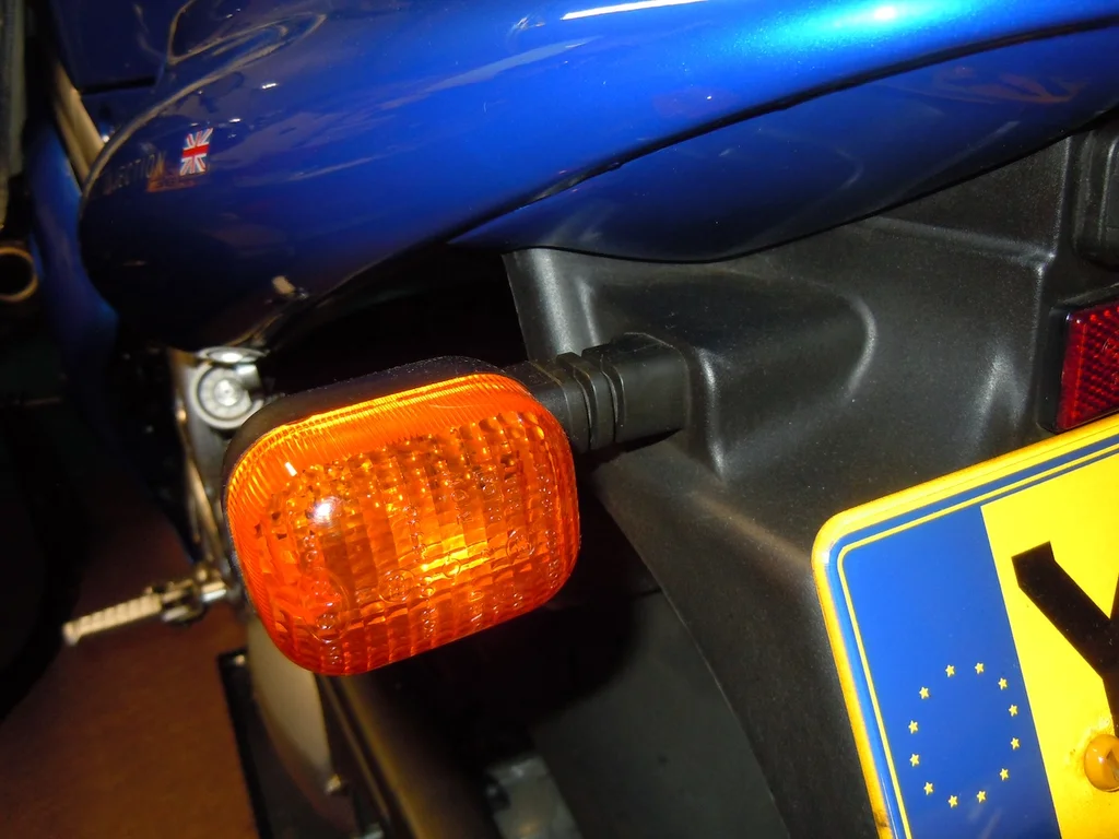

Swopped the two rear indicators on my 955i today for LED versions after realising the original one on the right was broke !
I'd bought these years ago with the intention of doing the swop some time ago, but never got round to it. Anyway, they're now swopped, at least on the rear, just need to buy some more for the front now, (plus two more for the Kawasaki Z900RS on-going fork swop !!) !! :ROFLMAO:
Before,
And after, obviously it now needs a LED specific indicator relay & the pin-outs are noyt the same so that's nota straight swop !! :mad:
Before,
Look so much better 👍

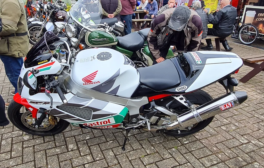

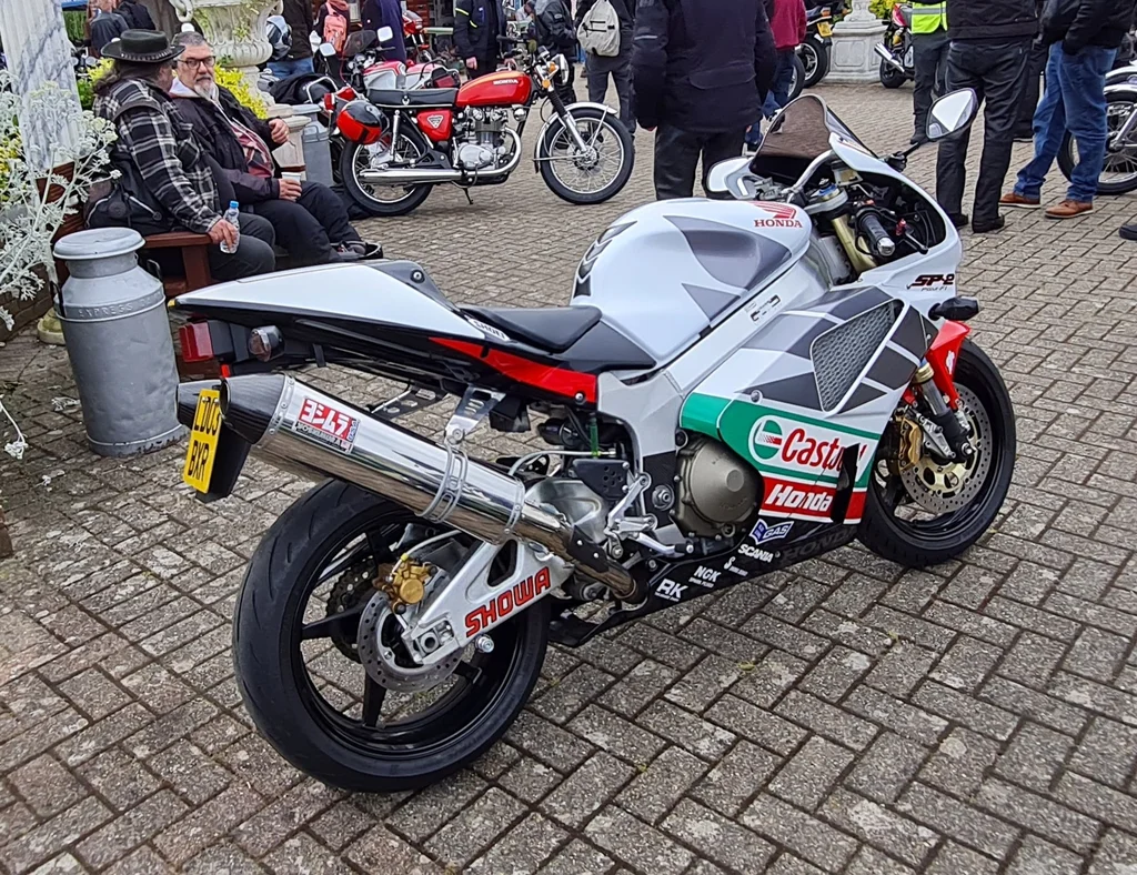

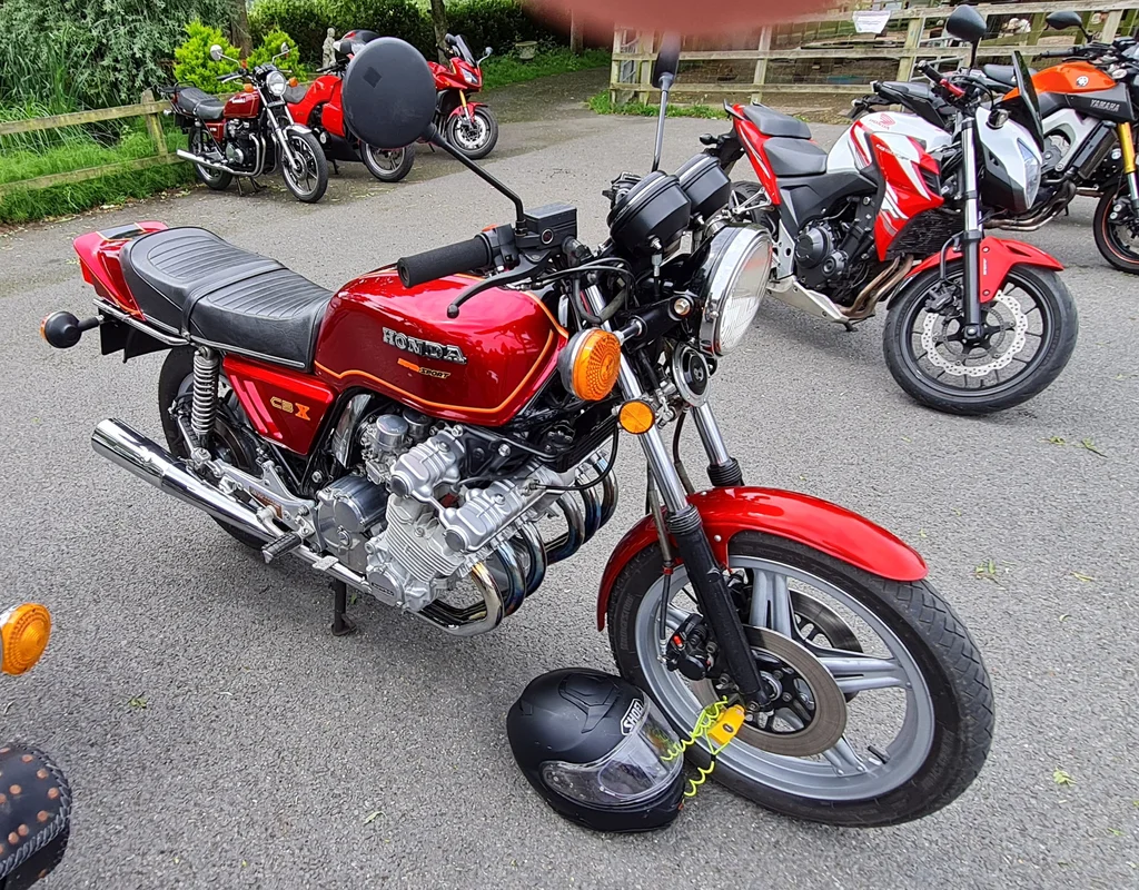

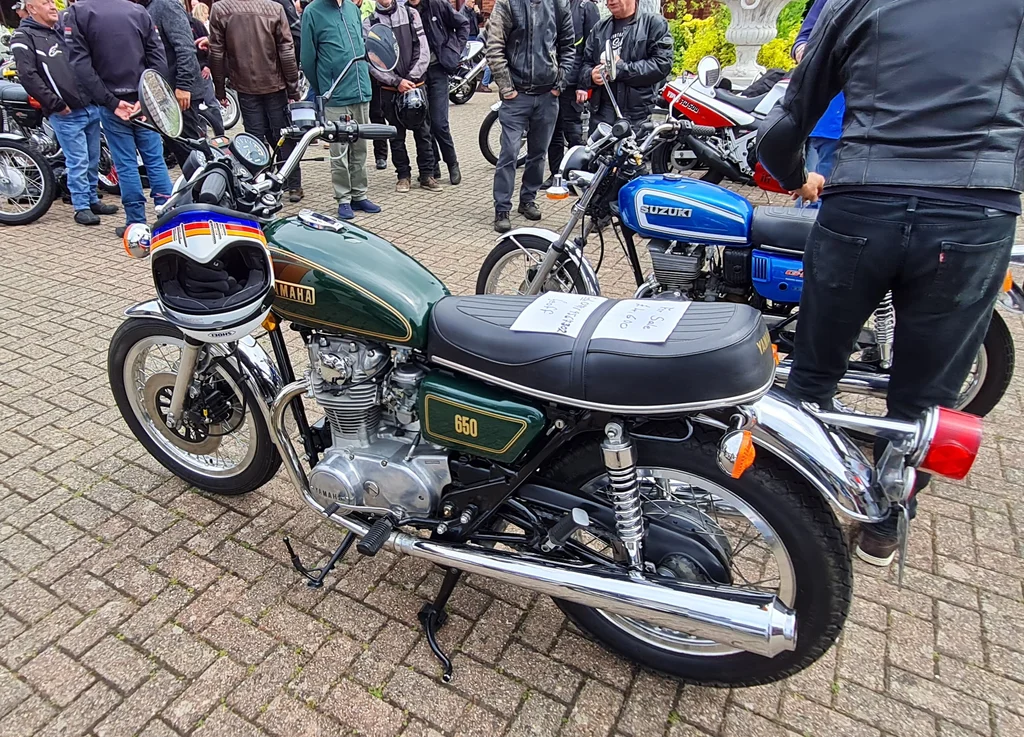

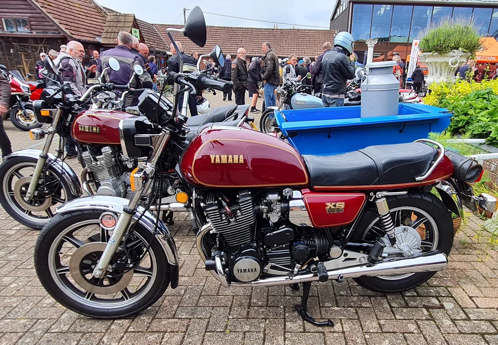

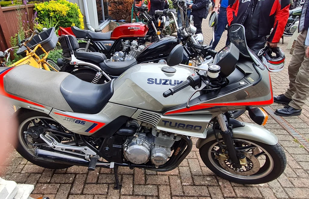

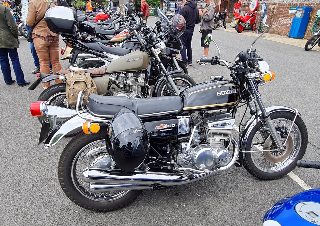

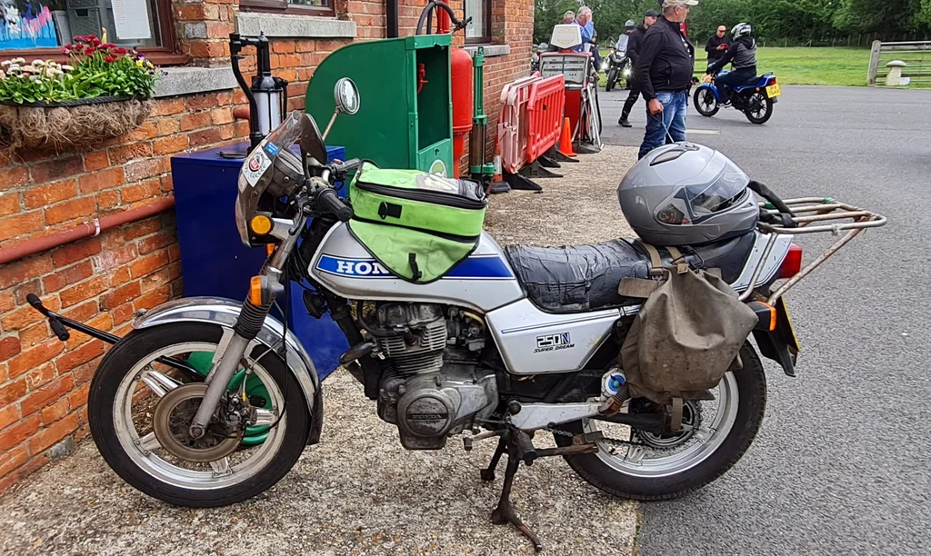

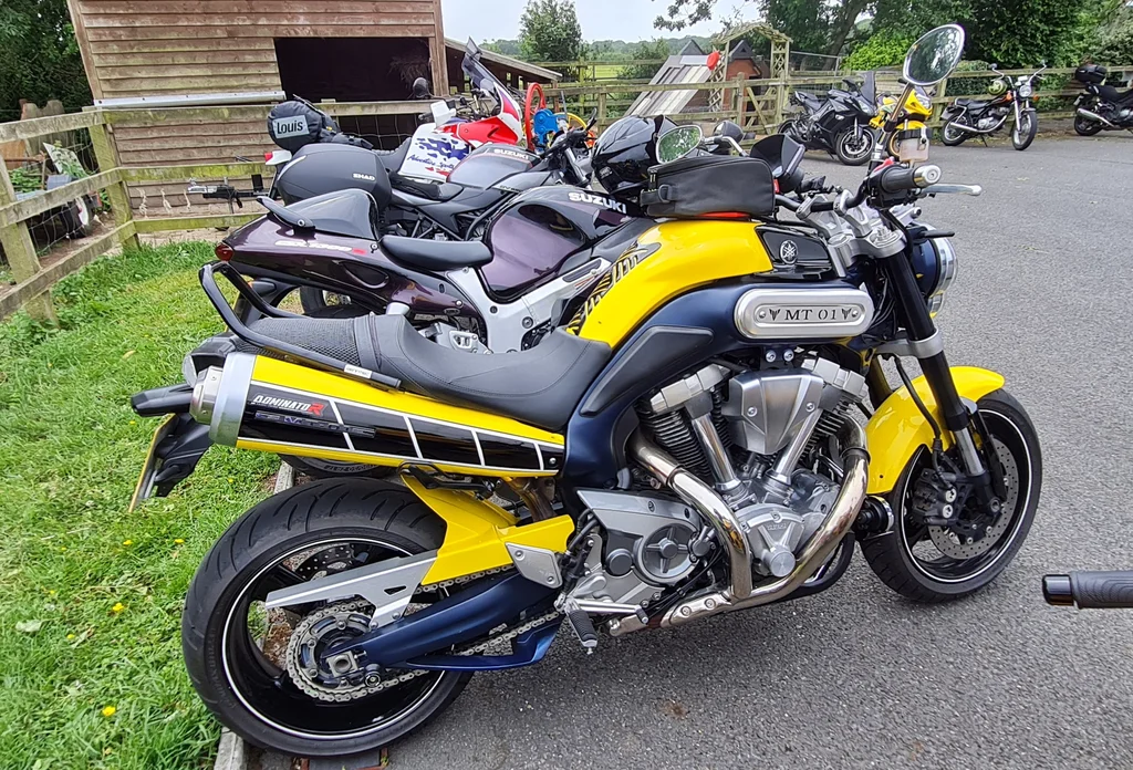

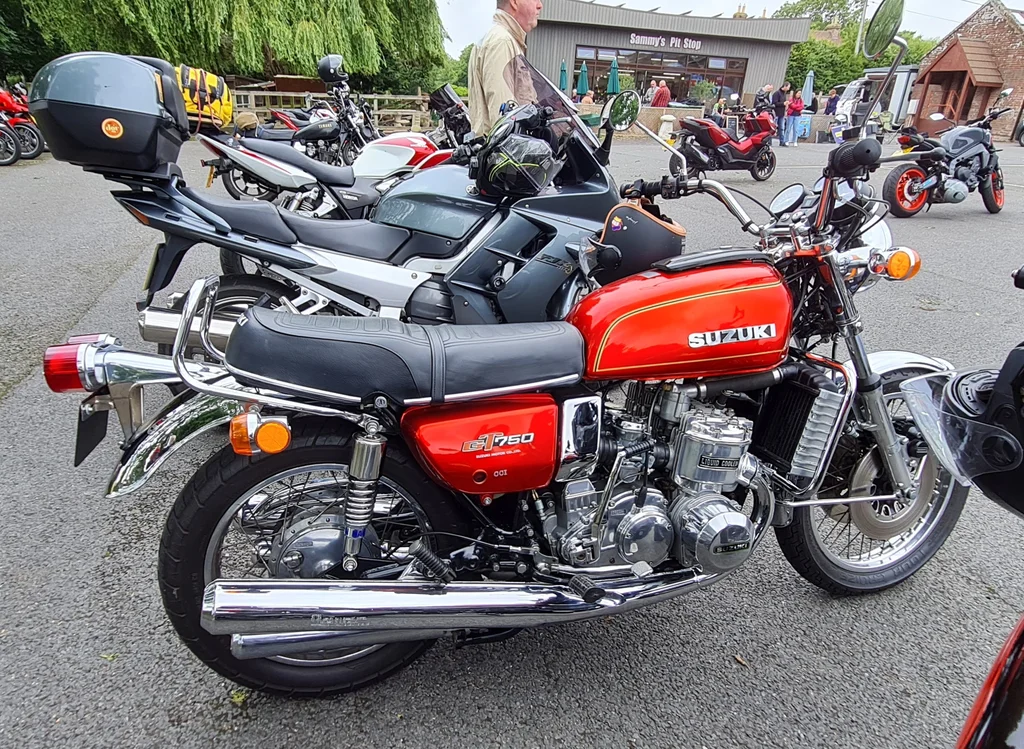

Today i rode to Sammy Millers for Jap day, a large turn out even though the weather is shit but no rain!!🥳 Another day of interesting bikes to look at, after that i just had a nice cruise around then home.:)
