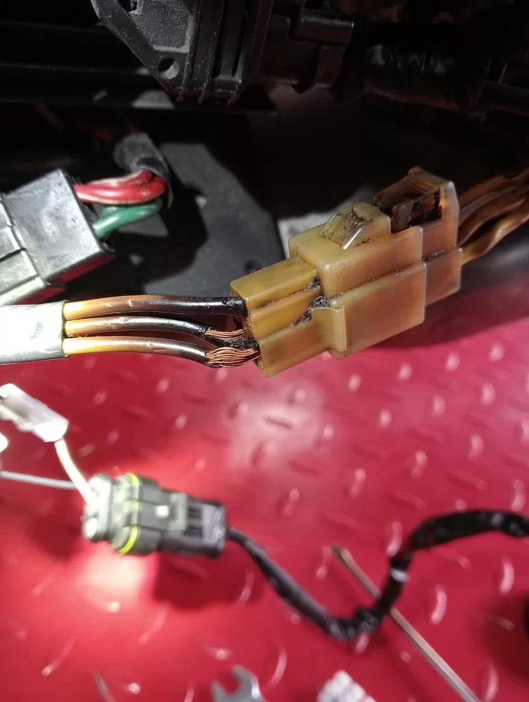

my 2007 1098s cut out on me while out for a ride and i found the problem straight away. the connectors from the generator to the rec/reg are fried and possibly the rec/reg is faulty now. the connectors had some oil on them from a previous oil leak and so did the connectors for the sidestand. i have cleaned the area of all oil and renewed one of the sidestand connectors. i have cut out the fried connectors and reconnected using singles. the advise given on previous posts recommends using a MOSFET reg/rec. i did the recall for changing the rec/reg ,heat shield and have done 16 K since then. the yellow warning light is on with error CAN 38.0 but when i press on the down button for 3 seconds nothing is happening. code should appear to cancel the error message. the bike is in neutral but there is no green light,but maybe this is to do with the error message on the dash. i have fitted the original rec/reg to check the newer one has not been damaged but i still cannot access the screen that says, code, to cancel the error message. lastly, does it matter which way i connect the 3 wires from generator to reg/rec ?.

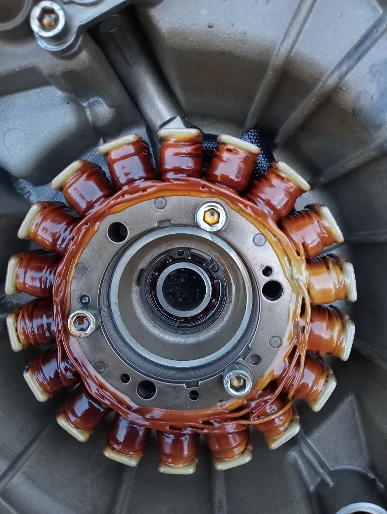

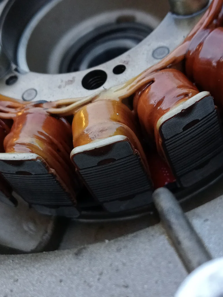

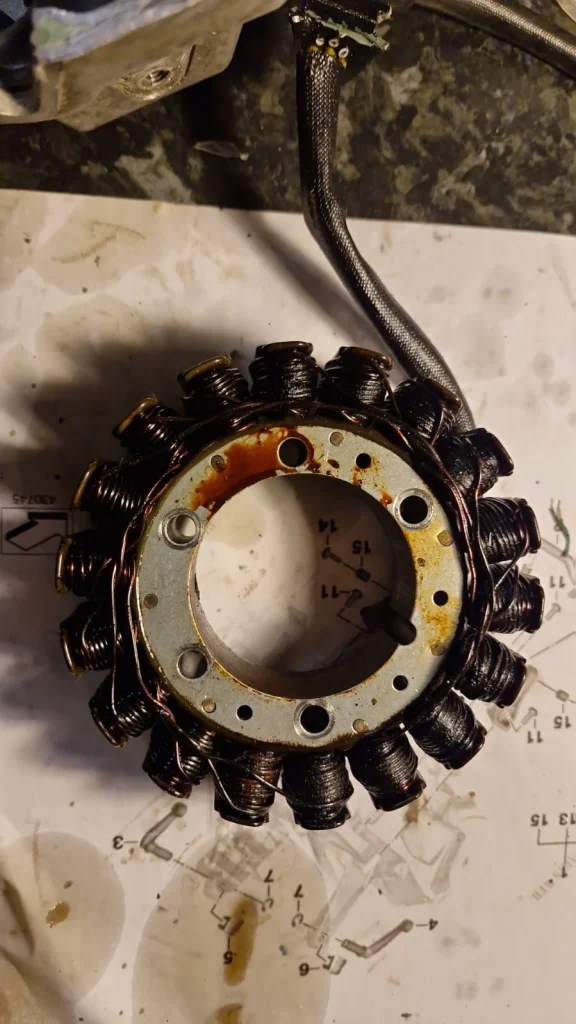

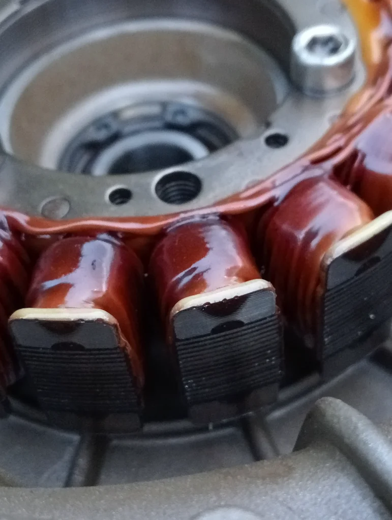

fitted new battery and mosfet reg/rec and mechanic put diagnostics onto the bike. it said that there is a power outage ,so i will have to check everything until the fault is found. at the moment the fuel pump and the neutral light does not come on. i will probably start with the stator seen as the connector to the reg/rec from the stator was fried. photo on first post.
tested the stator and the ohms reading is 0.00 . i will be removing the casing to double check that the stator has burnt out. just waiting on my puller tool to arrive. can you recommend a good stator at a reasonable price. massive price range available from £41 to £191
Have had good service from this company in the past
Agree Chris, looking at these guys for the update kit for the forthcoming RSVR.
i will look out for a series r/r. how much will it cost in the price range i mentioned.
Ray, this is the bad boy you want, you'll need the adapter kit too, plus it will be safe to fit a LiPo battery, so you can fit an bog standard stator and not worry about frying the windings.
Not cheap though!
I did what @Robarano did and used a modern Ducati one with Triumph leads (I sourced a 2 year old one from a V4 Panigale for not a lot of money)... relocating it with the kit in this thread:
i have just purchased a mosfet reg/rec last month. its a recommendation on a stator that i need,they vary from £41 to £191. i dont see any point in paying for 2 x p/p and their time to rewind the old one thats done 35k.
i,m getting 0.6 at all 3 wires with the multimeter set at 200 ohms
Sorry Ray only just seen this, there should be no continuity from either the three phases to the internal ring, or earth if it were still installed on the bike.
New stator required chief :(

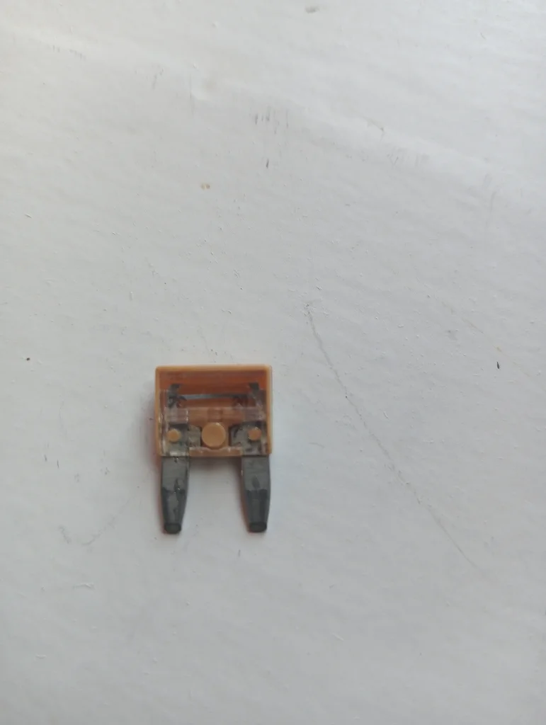

just found a clip/video of a problem solver on youtube under ERROR CODE CAN 38.0 SOLUTION. I looked at all the fuses about 3 times but when i tested the fuse it has blown , for the ecu 5a. as you can see from the photo it looks in good nick. so thats the error code off the dash now. my next problem is why the bike will not start. i put fresh fuel in it and it is firing for a split second but will not tick over. the fuel pump is coming on ok . i have renewed the battery,mosfet reg/rec,nuetral switch and both the relays next to the battery. voltage on the battery is about 12.9 and 12.0 on the clock, always been a poor starter. both plugs have been cleaned. could it be the starter motor is faulty or something is draining the battery when i press the starter button ? .
just found a clip/video of a problem solver on youtube under ERROR CODE CAN 38.0 SOLUTION. I looked at all the fuses about 3 times but when i tested the fuse it has blown , for the ecu 5a. as you can see from the photo it looks in good nick. so thats the error code off the dash now. my next problem is why the bike will not start. i put fresh fuel in it and it is firing for a split second but will not tick over. the fuel pump is coming on ok . i have renewed the battery,mosfet reg/rec,nuetral switch and both the relays next to the battery. voltage on the battery is about 12.9 and 12.0 on the clock, always been a poor starter. both plugs have been cleaned. could it be the starter motor is faulty or something is draining the battery when i press the starter button ? .View attachment 125340
I’d say the problem with that fuse is corrosion on the blades. I often have to remove fuses on bikes of a certain vintage, clean the blades of corrosion and reinstall them and all is fine.
