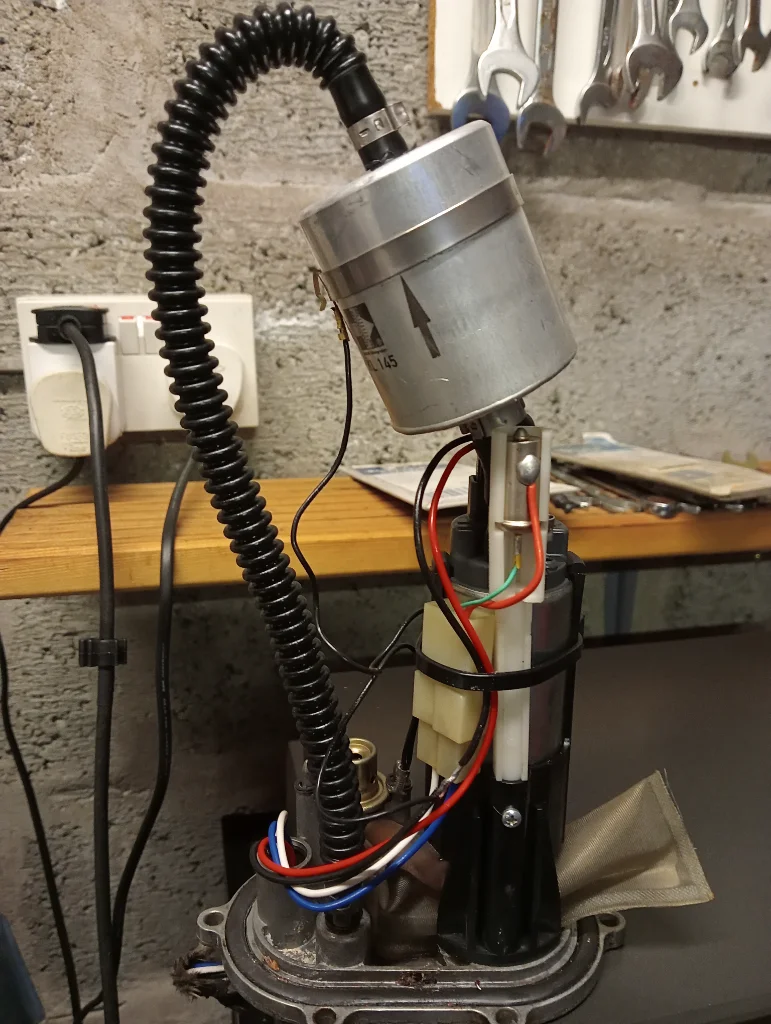

tested the solenoid ,just to double check its ok. got 12.45 using 20v on the m/m. removed the fuel pump and it looks in perfect condition.
In the past when checking hoses for splits/holes under pressure, I've added a food dye to the water. It's not sticky and easily rinsed through whilst highlighting any leak.
on hold for the moment. next pain in the arse is one of the seals on one of the quick release connectors has split. so i will order more.
The connectors on 1098 type bikes are proper wank and unlike the earlier connectors they can't be swapped out for proper chrome plated brass ones - but I do think the o-rings are the same and I can post him some FOC no problem :)(y) got some o rings /seals on ebay, just for the record you can change connectors on a 1098 2007 no problem.,but i tried the same thing on a 2011 multistrada fuel line and it cannot be done. the lines look like they have a teflon lining so the diameter is smaller. ie, making it impossible to slide in a connector
is it possible to test all of the pump using the connector as power with the battery connected to the bike. maybe submerge in a bucket of water with dye inserted into the pump and use a hose to blank off the inlet/outlet. one problem might be getting a shock
Aye Ray, I wouldn't use water personally, I've used paraffin or brake cleaner to good effect previously.
