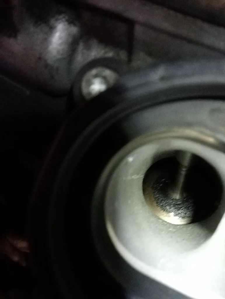

just removed the airbox to check the injectors and found this on the valves, can you recommend a cleaner to use,with a small wire brush.
photo attached .
