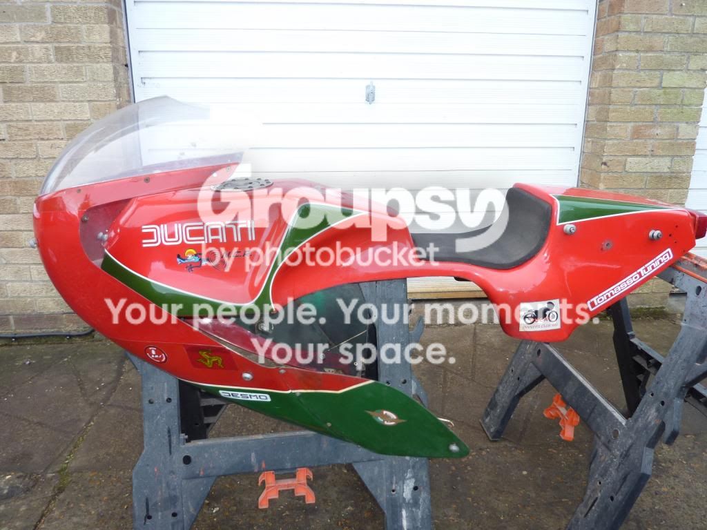

By a circuitous route I have found an NCR tank seat unit and fairing at a great price but I have to go to Norfolk to collect it. Luckily I'm near Donington today so it looks like a long trip home via bandit country! The only thing is, is that this eats up a big chunk of my 'In case I need a new ignition' money - ah well....
From a very nice man called Brian in Kings Lynn. He also has a race 2 into 1 and some Bevel ss bits like a headlamp and footrests.
Evidently this came off a MHR that was put on the track but blew up. I just liked the shape of the tank-seat and the patina/stickers.

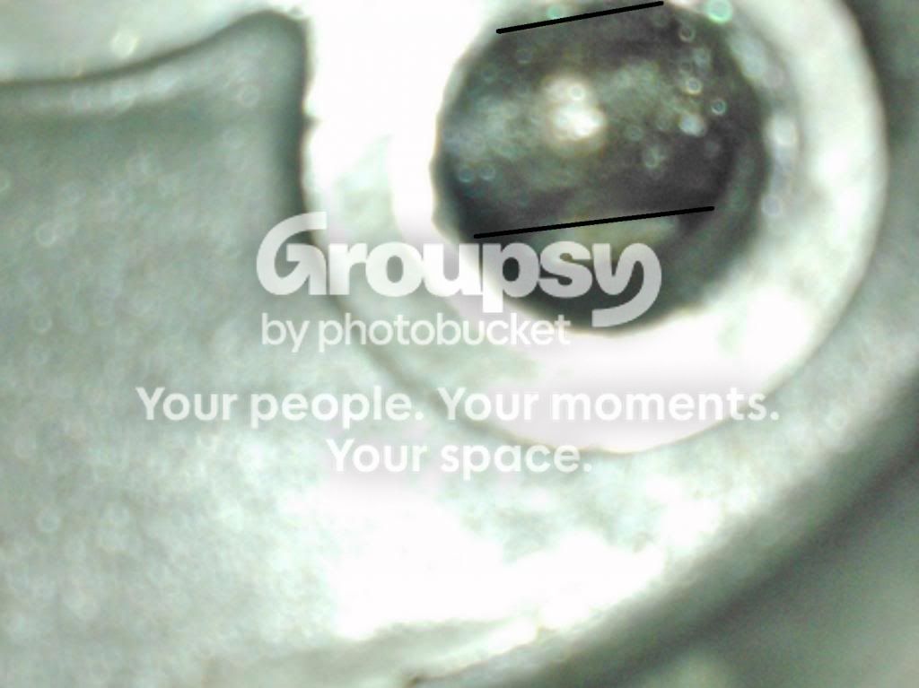

I re-read all the stuff on the net about the full-flow modification and went back up the threads to find that most mentioned the need to drill out the hole in the bottom of the filter housing where it goes into the oil drillings. Since that would mean taking the cases apart again I had a good check inside mine and can't see what the need for drilling is. Mine looks a bit like a drain gulley with a big (relatively) sweeping radius in each direction. In tha absence of intelligent intervention from on here or the steely gaze of MMT I'm going to leave well alone. When I can get the picture from my phone I'll stick it here.
I know that's a difficult photo but you can see the (relatively) great big channelcrossing from right to left (normally full of nappies and such)
